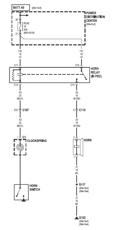

Have someone repeatedly push on the horn button while you listen to/feel the horn relay. If the horn relay is clicking that verifies the horn button is working. If the horn relay is clicking that means the problem is between the horn and the horn relay. If the horn relay isn't clicking the problem is between the horn button and the relay. Swap the horn relay with one of the other relays too, it's possible (though unlikely) you simply have a bad horn relay which is located inside the Power Distribution Center in front of the battery.

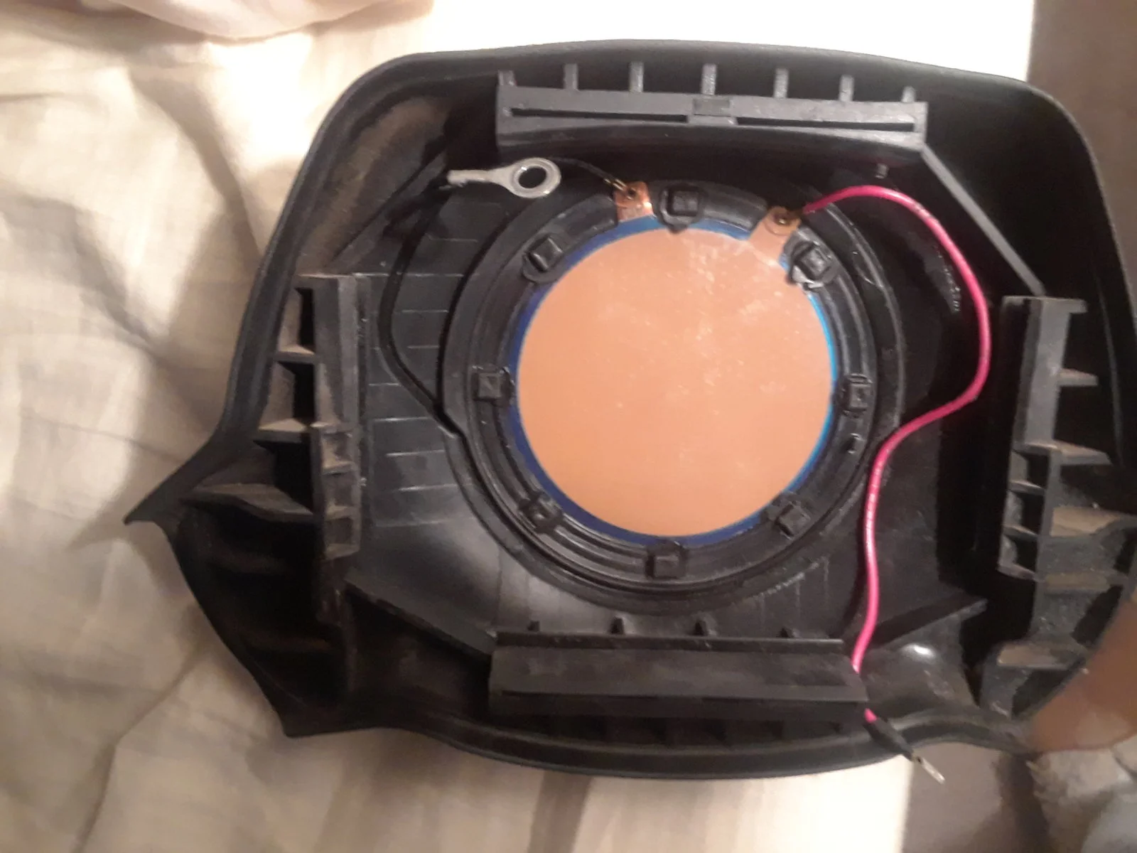

JeepDew i'm in the middle of troubleshooting my 97 horn problem. Bought it with an accessory switch I didn't like, (bypassing horn switch). I've ruled out everything but the horn switch itself. I surgically removed the original switch, thought I had it fixed, tried several things till I flipped the copper membrane over. Will need some wire reversing to attach both leads, r. so far it works, when tesed with conductivity leads will have confirmation or not after re installing, .A major pita due to the sensitive nature of the horn switch design. Will repost results after final install. Here's a pic of the switch.i hope

Wait, you already confirmed the relay is clicking which verifies the horn button IS working so replacing the horn button/cover would accomplish nothing. As said above.... if the relay is working, that isolates the issue to between the relay and the horn. And with the relay working, that would automatically make me suspect the horn or the horn's ground connection. There are no fuses or other circuits between the horn relay and horn.
