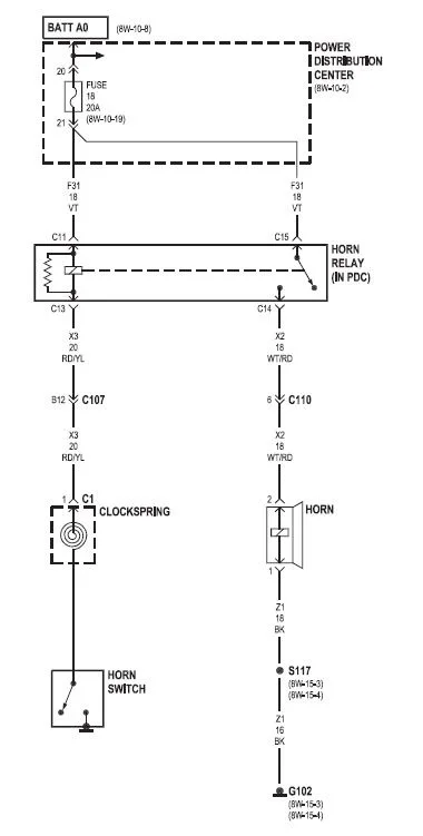

Throwing money at a problem is certianly a method of troubleshooting but it can get expensive. Jerry is 100% right IF the relay is working the problem must be down stream of the relay...i.e. wiring or the horn itself. Take the horn out and connect it to the battery and see if it sounds. If it does the problem is in the wiring.I think Im just going to go to the junk yard and buy a new horn cover...see if that works.
UPDATE: I just went outside to confirm that what I heard was clicking at the relay.... conclusion is that I need to stop drinking beer while working on the Jeep....Wait, you already confirmed the relay is clicking which verifies the horn button IS working so replacing the horn button/cover would accomplish nothing. As said above.... if the relay is working, that isolates the issue to between the relay and the horn. And with the relay working, that would automatically make me suspect the horn or the horn's ground connection. There are no fuses or other circuits between the horn relay and horn.
From Jerry's post the fuse is in position 18 in the PDC.UPDATE: I just went outside to confirm that what I heard was clicking at the relay.... conclusion is that I need to stop drinking beer while working on the Jeep....

I did switch relays also, same result... horn just beeps, can it be the contact in the steering wheel?Now try swapping out horn relay, contacts inside may be welded together.

I don't have an ohms reader....Yes, with steering wheel removed connect your meter ( set to ohms) probe the 2 wires to horn switch, report back with readings.

no, we discovered that the horn and the wiper fluid aren't working.... now just have to figure out why the horn keeps beeping when I put in the new fuse....Really? If you remove the fuse will the wiper fluid pump work again?
you mean if I unhook it at the steering wheel does it still beep... not sure but will check.And if you unplug the horn switch does the horn continue to sound?
have not tried that... will look into that this weekend. Will keep you all posted. Thank youLook at picture post number 15, when you have this disconnected.
With new fuse in does the horn still blast noise?

Ok, so my daughter's Jeep horn does not work. I took apart the horn area at the steering wheel and all cables looked to be intact. The relay looks fine under the hood and wiring to horn looks good.
when I hit the horn, mechanic is telling me no electricity is coming to the horns.
