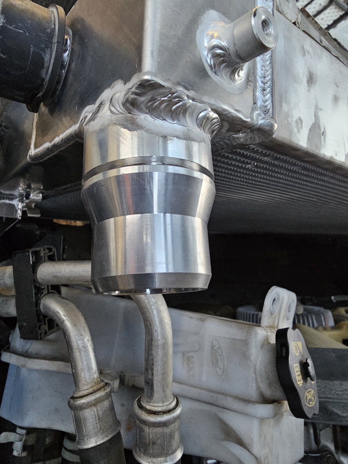

One of the nice things about the Mishimoto hoses is that they are doubled o-ringed instead of the single o-ring like stock. So they improved on the design and added that second 0-ring.
Can you just clamp a standard hose onto the thing?
Not really.
Look at this design, Would you trust a hose being clamped to it?

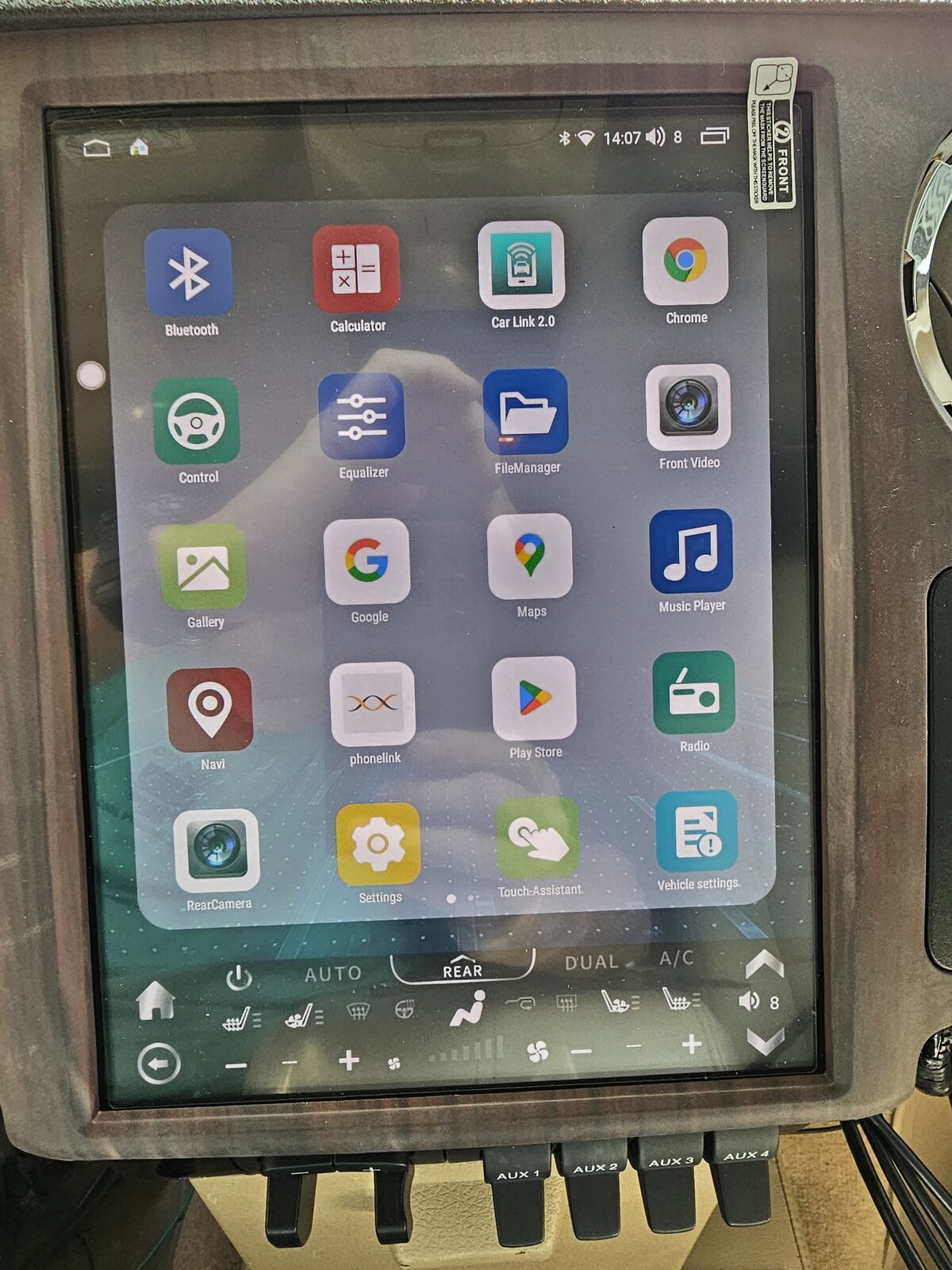

The apps list of stuff installed on the radio as it comes stock.
