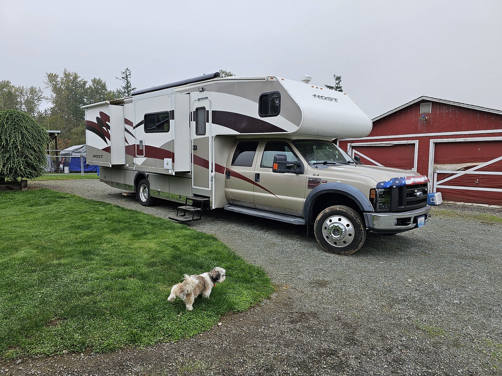

Started having engine problems around Missoula, MT but decided to push through to Yellowstone. Did some online research and determined it's either a leaking head gasket or the water pump cavitation. Fingers crossed its the water pump. So made the call to turn around and head back home.
So we're back in St Regis for the night and will be back in Snohomish tomorrow.
Well after the advice I'd received online we were able to make it back to Snohomish with little issues.
I'm really hoping this turns out to be the water pump cavitating.
The trick was to not fill the overflow bottle much and then leave the cap loose.
From what I've read the water pump when cavitating can wear thru the front engine cover and then you'll have coolant in the oil and sometimes oil in the coolant.
Either way I'll be waiting until spring to work on the engine and fix the problem.
Good 👍 news if that's possible when dealing with engine issues.
Got a new block tester/exhaust gas detecter kit from Amazon today. Warmed the engine up per the instructions and filled the tester with the required fluid.
Diesel engines will turn the Blue fluid a Yellow/Green color if there are exhaust gases in the coolant.
So this means it's not the head gaskets. While it still means I've got a problem it's a less expensive one.
