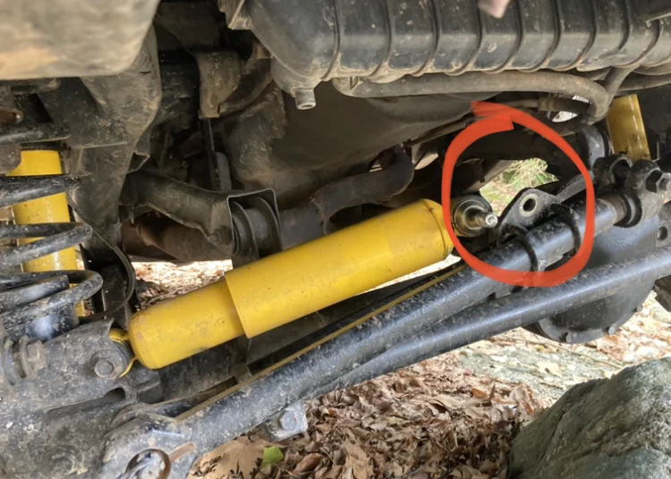

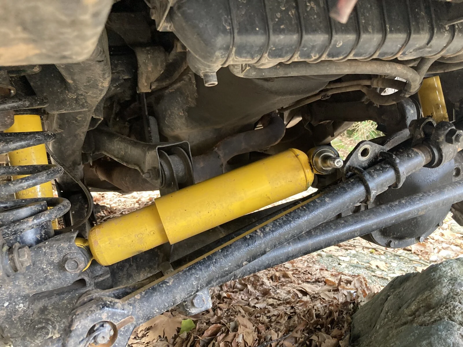

Thank you! @Jerry Bransford Indeed I have noticed no diffuse so far driven the Jeep for 30ish miles on road after diagnosing that this happen. Any thought on why it happen? Loose washer or wrong lighting of it?
Thanks! Will post close up tomorrow. To note also that the steering is a recently installed currentlync and I was wandering if maybe it has not been installed correctly. Especially the bracket on the drag link where the steering damper is bolted to (the point where it came loose)...

I have noticed I metallic sound when the turning the steering wheel (not necessarily at full lock, could be one full turn) that I have heard both on the road and off road. Not sure from where it comes yet as I need to search the issue. I'm suspecting that it has to do with the searing damper bracket which I'm not sure is it has been installed/positioned correctly.
Since you brought up the subject, happy to hear if anyone who has the cyrrentlync installed can chime in. I post up a pic with the bracket's position highlighted.
