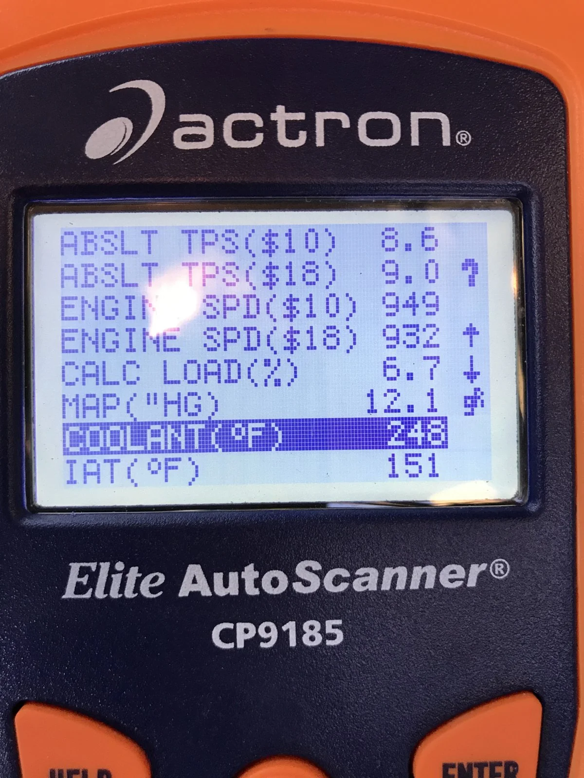

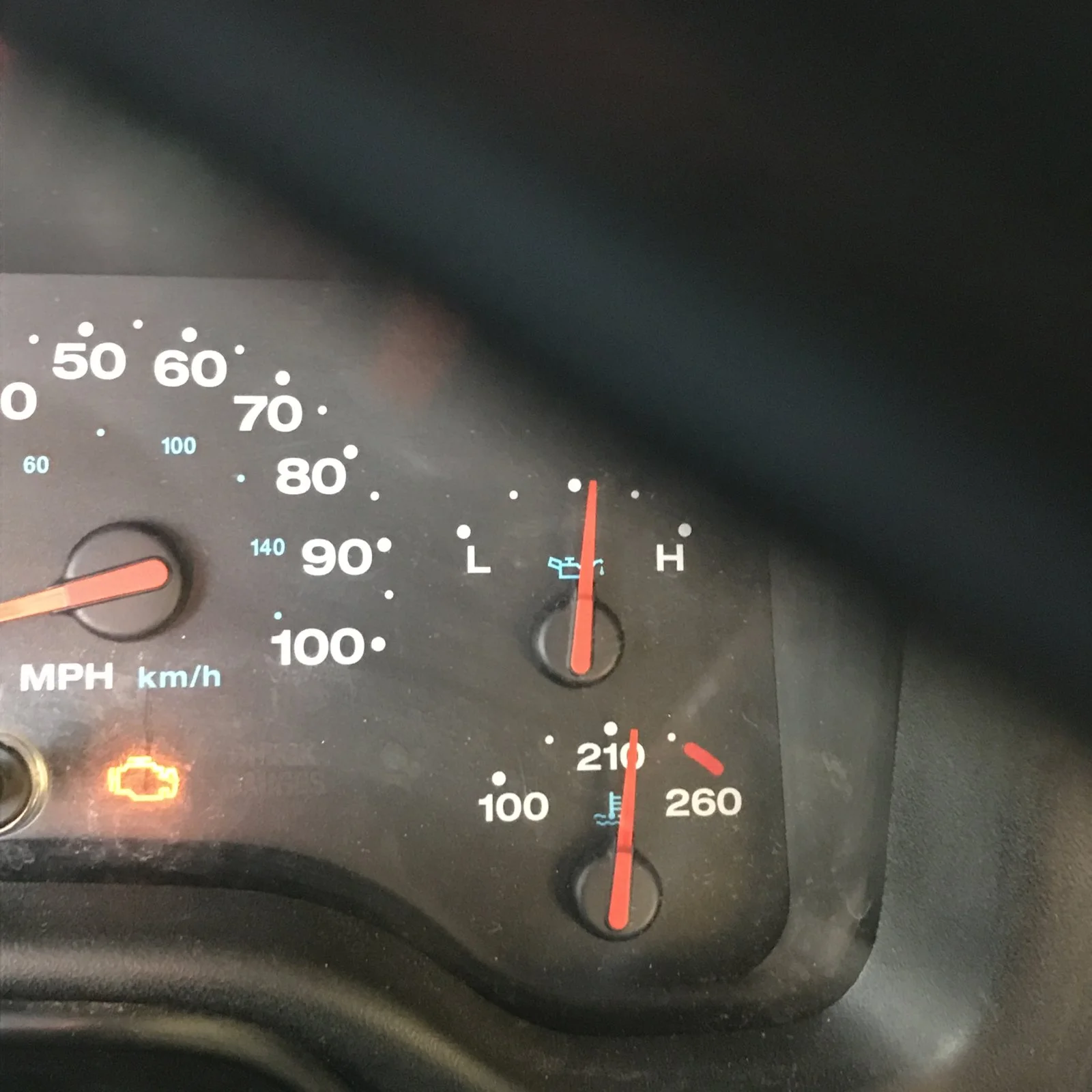

IMG_2145.JPG IMG_2147.JPG Hey guys, my 03 I6 has 216000+ miles on it. New radiator, new 185 thermostat, new 18# radiator cap, new water pump, new cooling system flush and a 60% mix on coolant to water. Mid 80's today in N Alabama and an afternoon cruise, backroads not getting over 55 mph my engine temps are running high. Is this normal or is there something else I should do?
210-215 is normal. 248 is not. What radiator did you use? It is well known to run an oem Mopar radiator, water pump, and 195 stat.

Does it ever exceed that temp on your temp gauge? If so, don't worry about it. Mine will get to that level on really hot days in traffic, but never goes any higher. I'd say it gets to about 220 at the worst.
