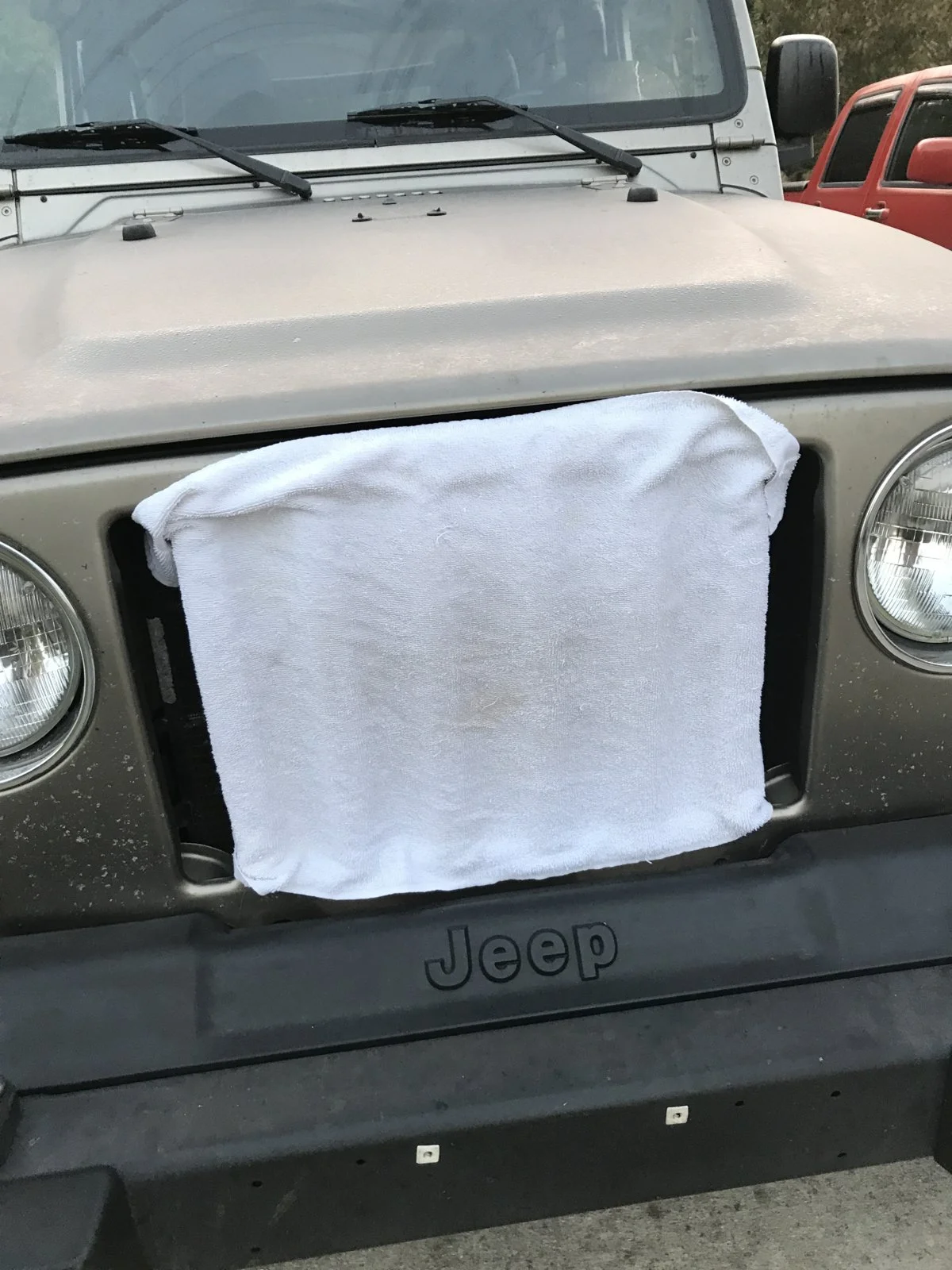

O2 sensors are cheap. I'd replace them all. My jeep will hold a towel on the grill at idle, is your fan shroud and all the rubber seals around the radiator to grill intact? What Thermostat did you use? 185 is too cold anyways.
Same here on the towel.

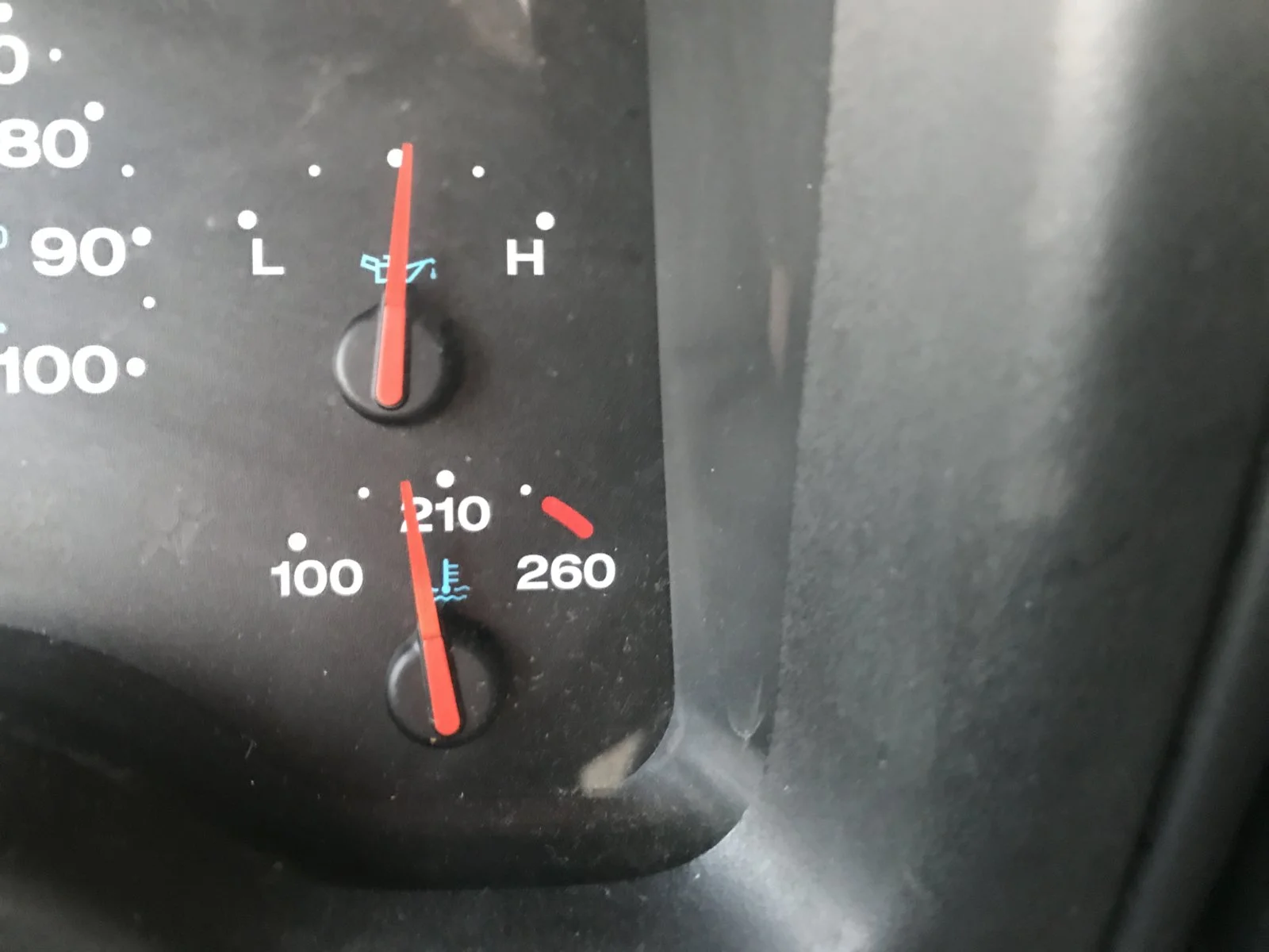

I don't believe the thermostat that I installed is faulty, the Jeep may not like that particular thermostat, but I don't believe it to be defective. It's a Stant, which is a well respected name brand. But nonetheless, I bit the bullet and bought the gold plated Genuine Mopar 195* thermostat and will install it after the engine cools down, hopefully tonight.

Regardless, I think the thermostat is faulty. That's a classIc sign of it sticking. It was stuck partially closed which ran hot and then completely open which is why it ran cold. If you want to know for sure, stick it in a pot of water on the stove and see if and when it opens up. It should open up right before the water boils and then close when the water gets cooler.
He had a 185 T stat installed and it didn't get to 200. Why do ppl think it's faulty?
I wouldn't expect engine to get to 200 with a 185 tstat on a short drive in mild conditions.

I would expect it to be faulty because a 195 runs the engine around 210ish. A 185 should get it up to a solid 200ish and since the thermostat controls the minimum operating temp and the radiator controls the max, not reaching 200ish indicates that the thermostat is stuck open and letting the radiator overcool the system.
