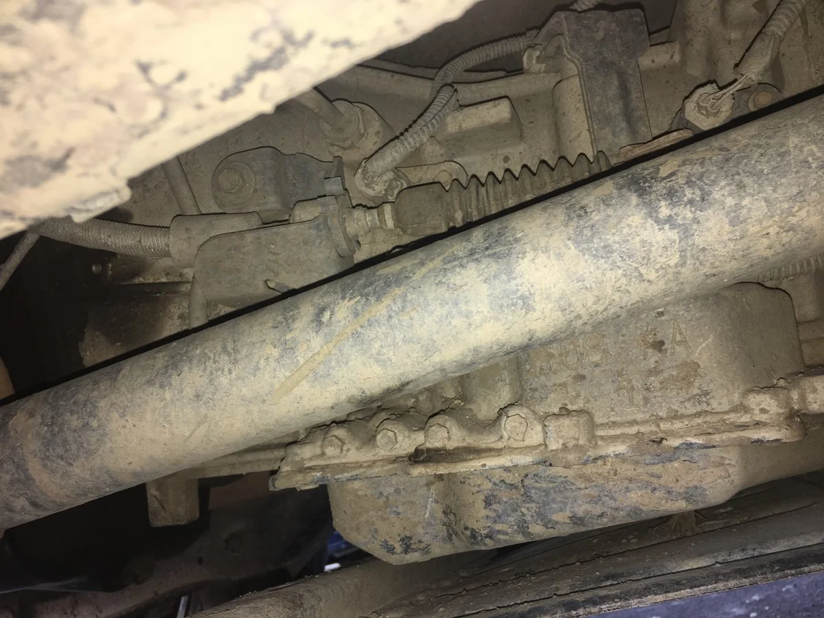

A broad pic of each side would work, especially where the shift linkage and trans cooler lines go in on the left side. It's entirely possible someone swapped in a 32rh, but it would require a different ecu, wire harness, transmission mount/skidplate, cooler lines, possibly flexplate and kickdown cable.
Sorry its a bit dirty but does this help
That's a 42RLE. You can see the two speed sensor connectors just above each end of the selector cable boot, and four bolts sticking out just above the edge of the pan.
OK from the pics it looks like I have a 42RLE.

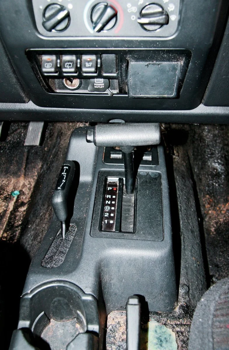

But my console selector must be wrong
But my console selector must be wrong. I can only feel the 1 2 D indents with the selector!!!!!!
if you hit the "O/D Off" button, it forces 3rd to be your top gear. So in a way you have the option to select any of 1,2,3, or 4 with the combination of shifter and button.
The floor shifter allows you to hold the transmission in first or second gear for steep hills, off roading, etc. Drive lets it shift normally first through fourth gear, and the O/D switch allows you to disengage fourth gear for towing. The fourth gear in the 42RLE is way too much gear drop for most owners, so many of them just get in the habit of switching off the O/D every time they get in the vehicle and just drive it like it's a three speed.
