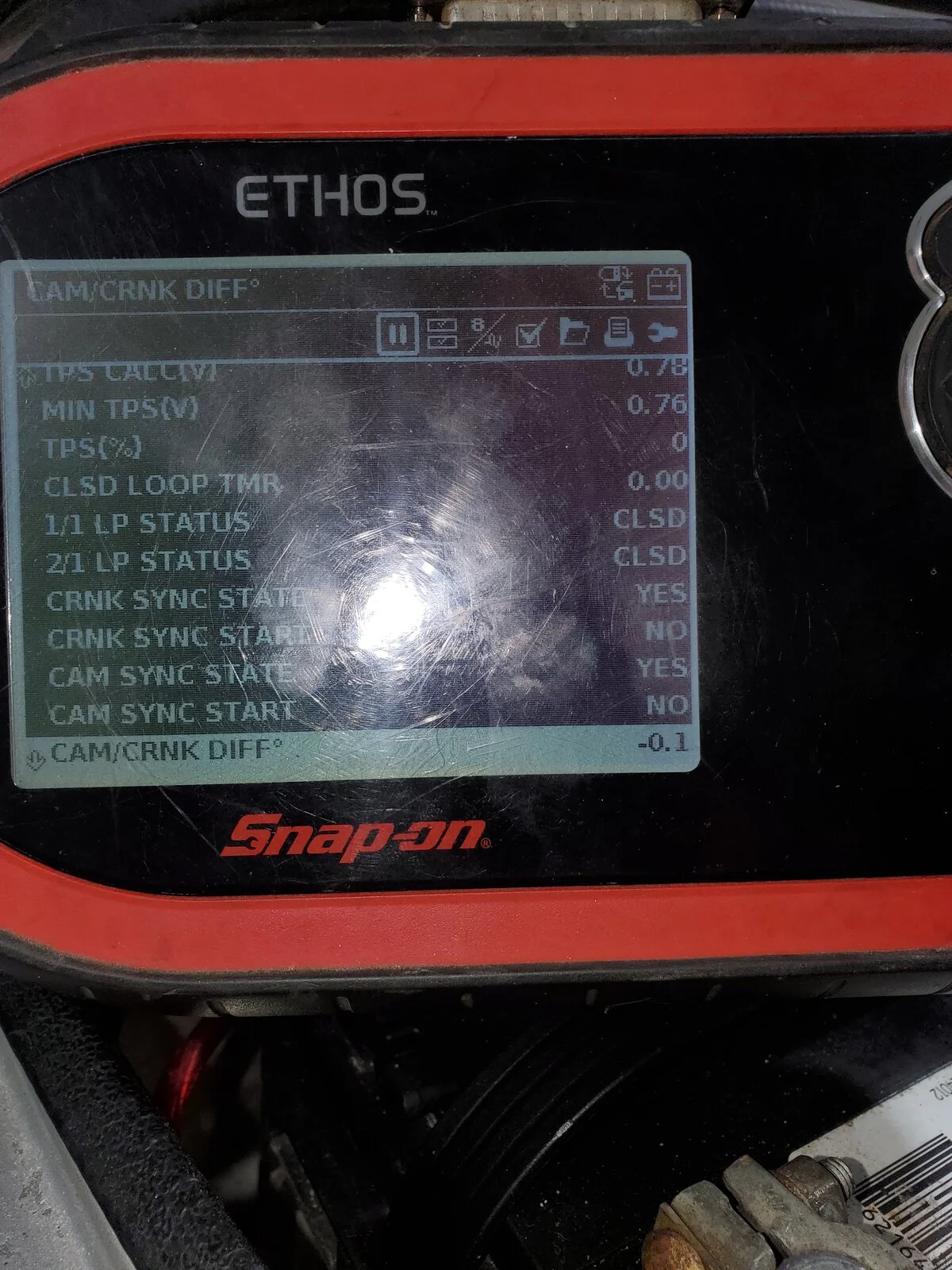

I changed mine approx 6 months ago. Just make sure when you do change it, that you put the new one in exactly how the old one came out or use a scan tool (make sure the scan tool has this special line) to make sure your cam/crank differential percentage is within spec ( i believe it is +/- 8 degrees) or you will be in limp mode. I have an image of my Snap-on Ethos scan tool ( photo earlier in this thread) which has this measurement. I know my OTC (Bosch) 1300 scan tool does not have this measurement.The OPDA and camshaft synchronizer are the same thing. The 05-06 FSM always refers to it as the camshaft synchronizer. The design was slightly different in 05-06.

I think it may vary slightly but the spec is 10 degrees either side of 0. Easy to find out if you have a scanner, loosen the bolt and turn it slowly until the engine dies. Check the timing and do it the other direction. The most we've seen where the won't rev above 3500 rpm is 11 degrees.I changed mine approx 6 months ago. Just make sure when you do change it, that you put the new one in exactly how the old one came out or use a scan tool (make sure the scan tool has this special line) to make sure your cam/crank differential percentage is within spec ( i believe it is +/- 8 degrees) or you will be in limp mode. I have an image of my Snap-on Ethos scan tool ( photo earlier in this thread) which has this measurement. I know my OTC (Bosch) 1300 scan tool does not have this measurement.
