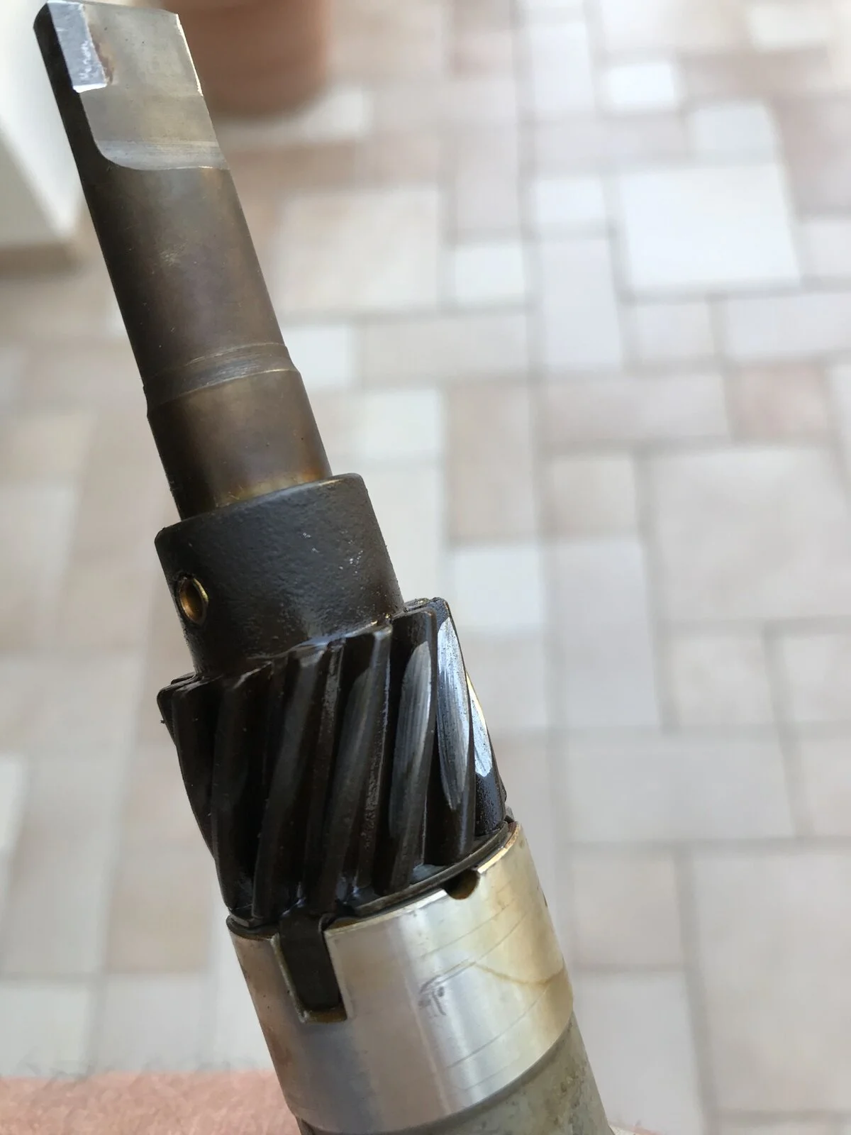

Question for the OPDA gurus... I replaced mine yesterday. Ticking noise is gone!. While doing a post-mortem on the old part, I noticed wear in the hilicoidal gear, what I consider excesive play in the wheel that caused it to rub against the sensor, and wear on one side of the bottom part. I believe it was just miles away from a larger failure. Im intrigued by the wear on the lower portion. Where does it engages to, what could cause this wear?. I`m attaching a pic as a reference. (in this pic, the lower portion I`m talking about is on top right corner of the image...)
To the oil pump.
