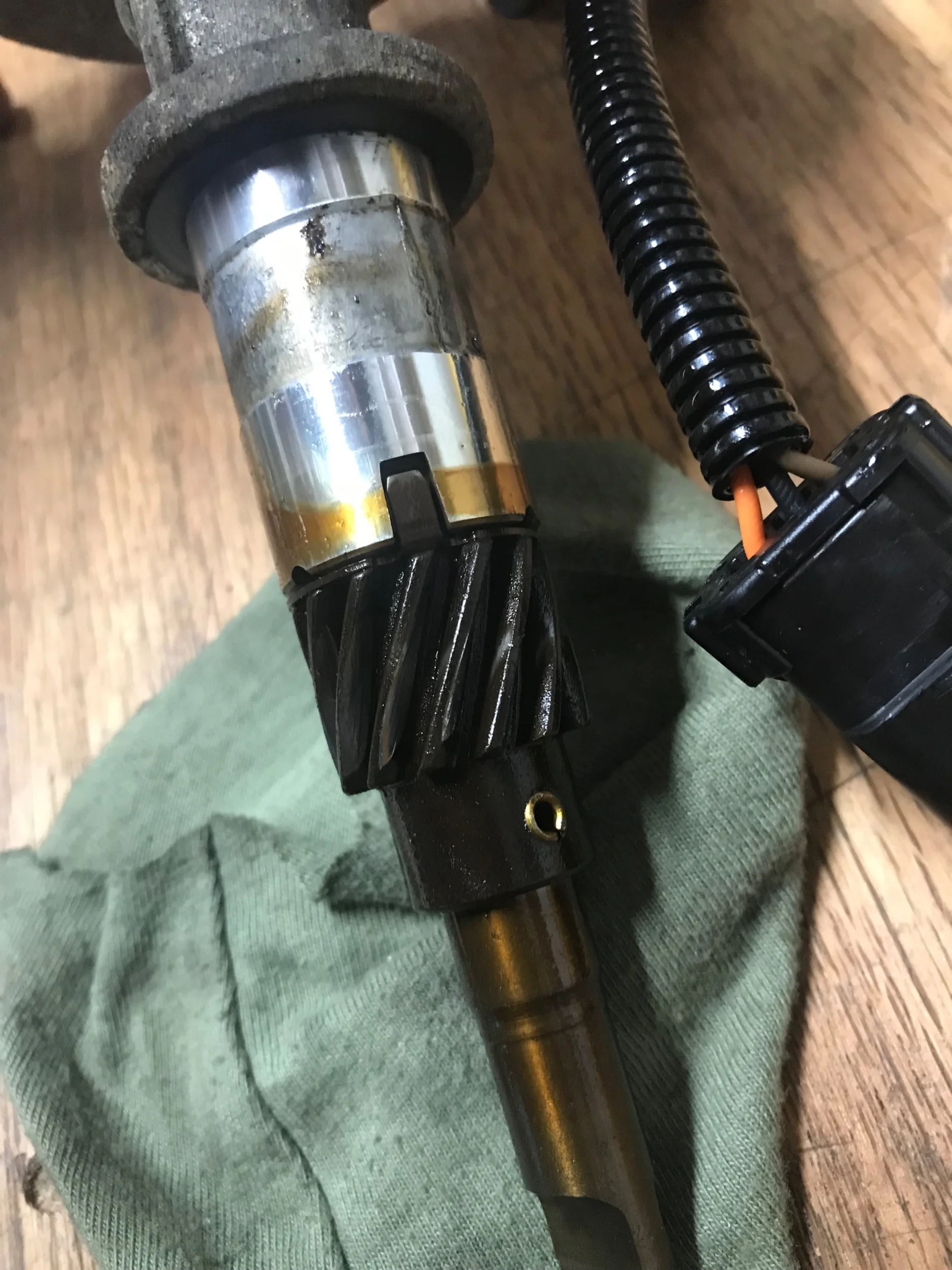

2005 LJR with 122k…. No noise, just finally got around to it. I reused the original sensor…. Ran for 10 min w/o a code, sounded normal…
Shout out to @Zorba for the detailed instructions.
Edit: After a few drives around town I can’t help but feel that a slight ticking noise is gone, sounded like an exhaust leak.
