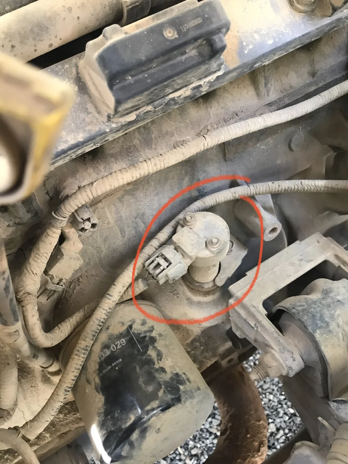

Hi all, I have a camshaft synchroniser that's clicking on a 2003 Wrangler 4.0. Do you recommend to just replace the synchroniser as it is or change to the OPDA version that much bigger (I understand from the forum here that it was used from 2005 onwards). Is that upgrade worth it? And it will fit despite the much larger size?

The 05/06 version will not work on your motor. Stick with the camshaft synchronizer for an 03
