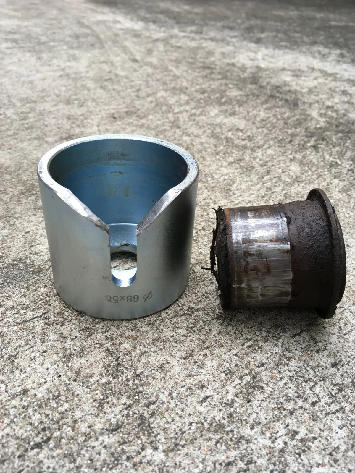

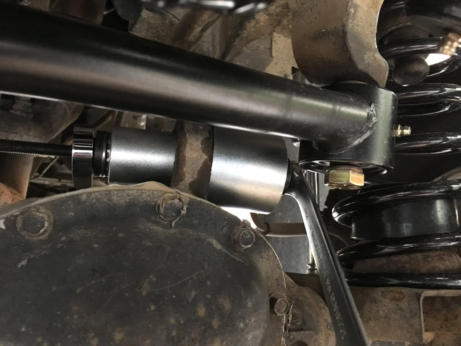

I used a press & pull bushing removal and insertion tool. The receiver cup required modification to seat flush with the housing ear. The kit has a wide range of cup/driver sizes, but the majority are skewed toward larger bushings. For small bushing and bearings I use sockets.
View attachment 71604View attachment 71605
That only works on the Dana 30's. The bushing is in the exact same spot on the Dana 44 but the casting is larger so it goes up around the lower part of the mount just enough that you can't get a straight shot with a sleeve to push it out. I suppose you could make a sleeve that is about 3/4's of the way around but a hammer is faster and I don't do that many.

I have Moog replacement bushings (K3128); that didn't do me any good. The MOPAR Miller tool has a U shaped spacer for inserting between the sides of the passenger side mount bracket to prevent distortion when removing and installing a bushing. The spacer is 1" wide, which would fit in a healthy/un-bent UCA mount. The sides of my mounting bracket had collapsed inward .20". The bracket was also bent. Because of corrosion and distortion there would be a risk a new bushing sleeve would not fit firmly after removing the original. My guess is UCA axle bushings are not included in CA kits because of the potential problems with fitment.
