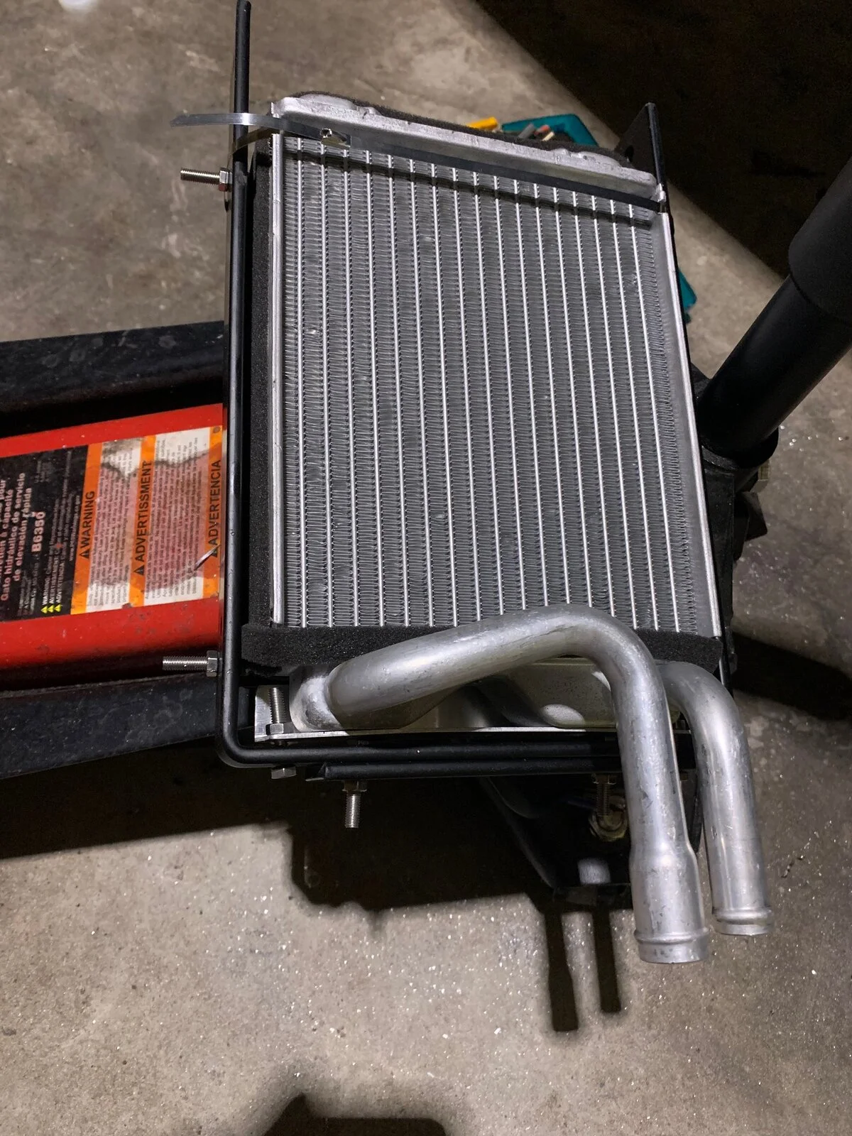

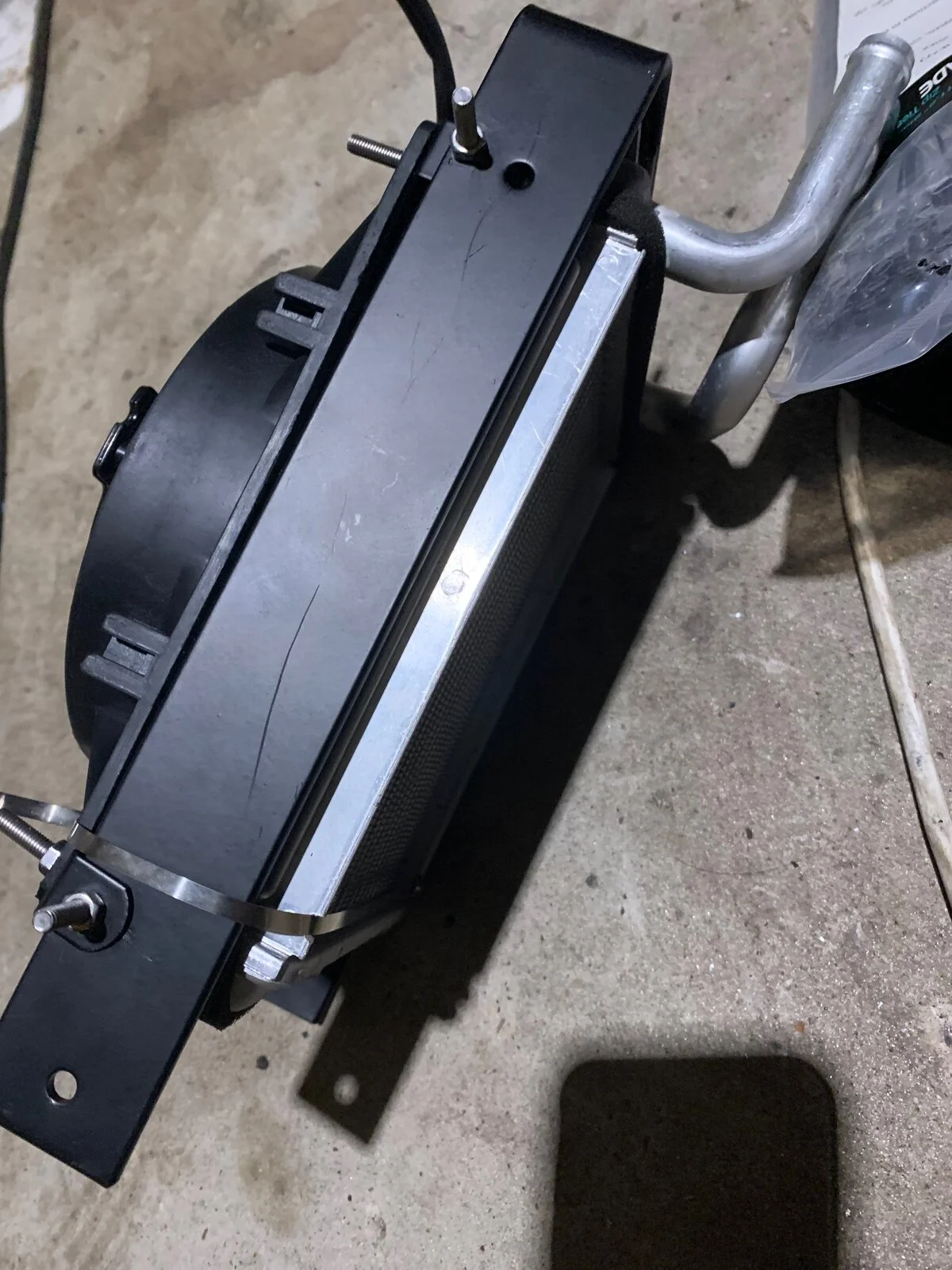

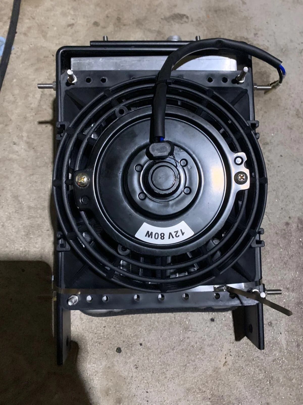

I took a heater core from YJ, 6 inch fan, couple of metal pieces and working to get it installed in the back. I will install a switch on the fan that activates when the temperature of the coolant reaches 210F. I will use the heater core line for this, basically the heater core line will go through the back of the rig for the cooling.
