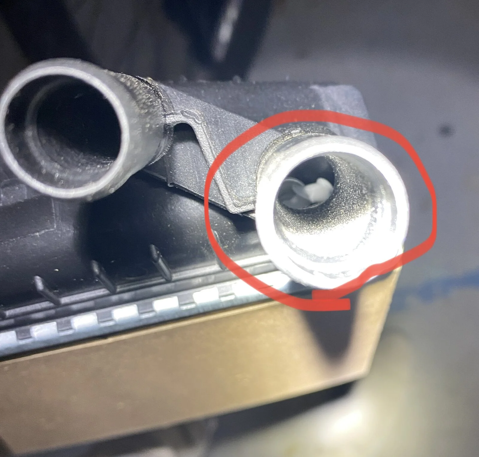

I’ve heard good things here about the performance radiator brand because they are the only one who uses metal turbulators. I looked through the tube on the top and it looks like I see some white plastic which is not promising.
Has anyone else seen this when looking at the performance radiator heater core? Thoughts?
I just picked up a performance radiator heater core and upon inspection found the same thing. I will probably still use it because I need to stop the leak and heat is not a huge deal where I live. Just a little disappointed.
Was that designed into the core? Maybe to restrict outlet for better shearing or longevity. Could it be to reduce noise from water flow? Here to tell from the picture if it’s designed that way or poor manufacturing
