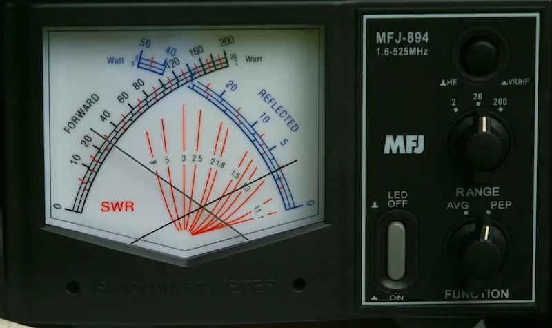

I had a cheap SWR meter that was obviously screwed up as it read 3+ into a resistive load. Bought a fairly expensive dual needle model that can be used for both CB and GMRS - and ran over the POS old one with my Jeep...
Reactions: Ephry73
@Zorba , do you have a link to the CB/GMRS one you bought?
Google's your friend, I think I bought it at HRO...
Reactions: Ephry73 and SSTJ
