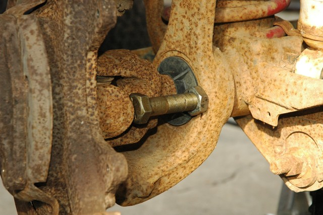

There is a trick where you stick a bolt against the inner C and the unit bearing, turn the steering and it pops the unit bearing out.
Someone will post the pic.

Having the same issue. The link does not work. Can someone @jjvw give a little more direction please. Tried heat, beating, wedges...nothing has budged.
I removed the space and found the link. What length bolt are you using for this? I need to buy one. I had one bolt break, but don’t think it will matter. I saw one person used a socket and extension. Not really the right tool and hate to screw up a tool. If this works as advertised, this should be a sticky. @Chris
Use a grade 8 bolt
https://www.stu-offroad.com/axle/unitbearing/unitbearing-1.htm

Thank you, What simple fix. Heading to the store now to get a bolt
A 2 inch 7/16 with nut did the trick. Had to get my wife to help. What a great tip. Advice, do not be afraid to crank the wheel hard. It took a lot for mine to pop loose. Sounded like a gun shot when it did!
For the future person reading this and the link might be dead...Rotate the axle until the yoke ears on the outboard yoke are parallel to the ground. You might have to adjust it a little as you go from side to side. Do a little movement at a time on each side to keep it coming out even. The tube seal is called an "oil slinger" pn 46849 for an 02 TJ with a DANA 30. The Picture was taken from STU-OFFROAD.
