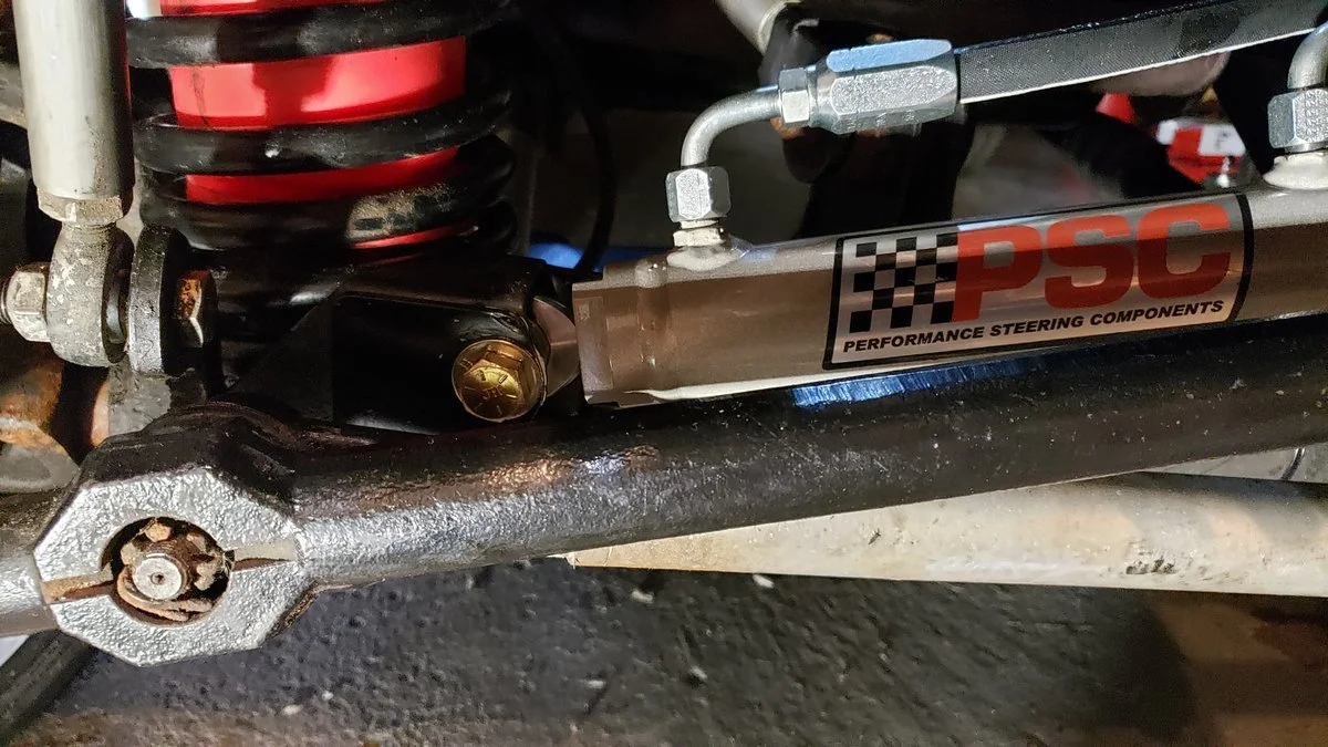

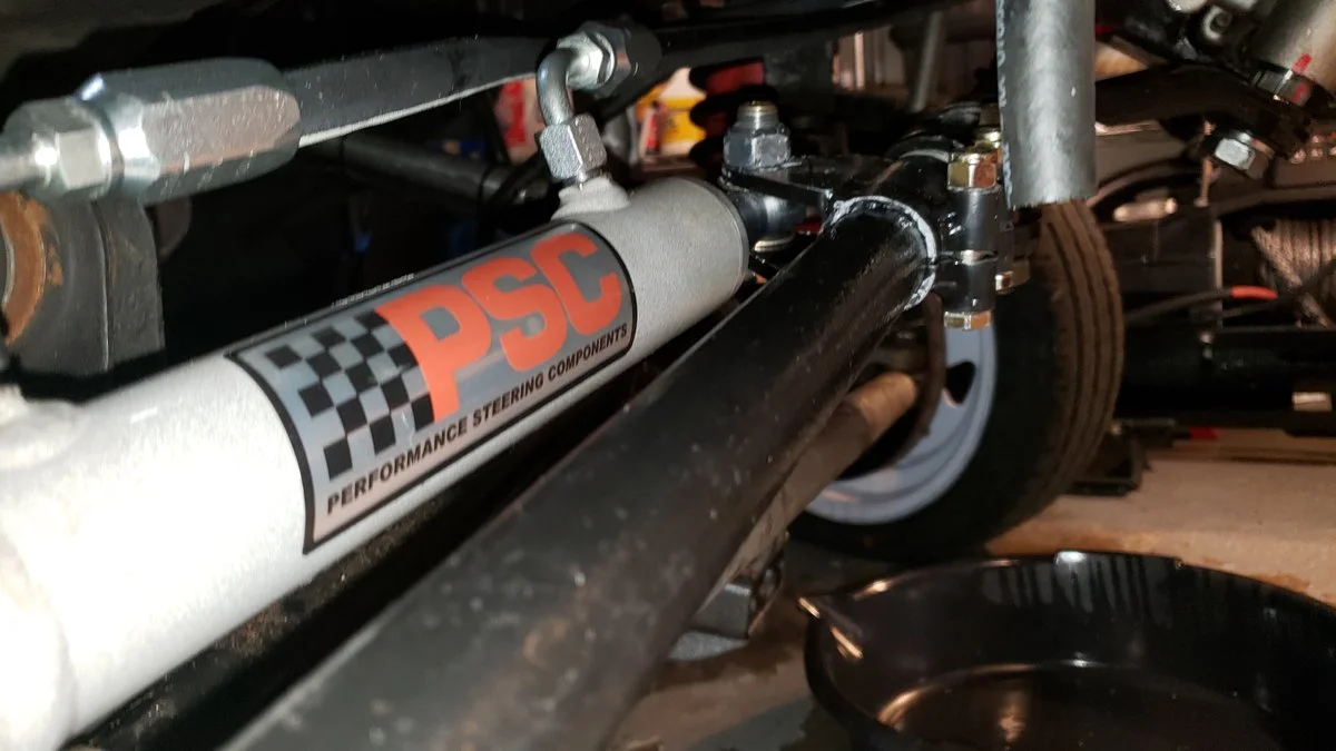

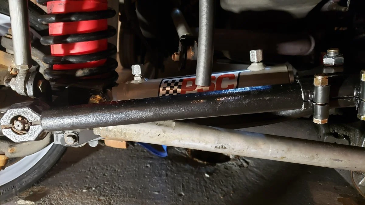

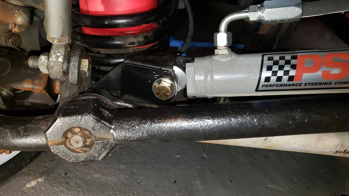

Basically the hydro assist bolts in just like a steering damper. The brackets are just there to reinforce the mount.

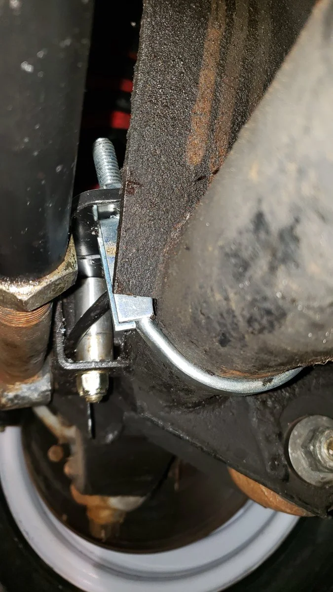

The big short spacer is used between the big bracket and the damper mount on the big bolt. The skinny long one is used to bolt straight down. You will have to drill this one hole.

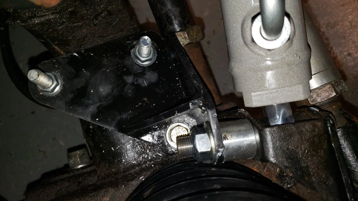

Start with the little bracket. It bolts to the damper bolt and to the trackbar bolt on the front face.

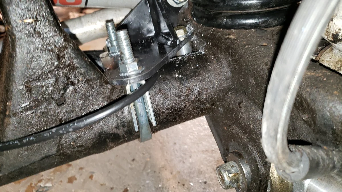

The second one, assemble the clamp on the axle tube, insert the bracket on top, add the steering damper bolt with the spacer, tighten the clamp nuts and the damper bolts all the way. Insert the skinny spacer underneath and use it as a guide to drill through the bottom of the trackbar mount.
