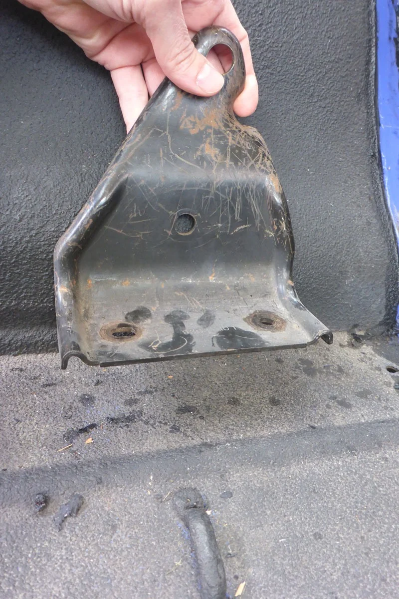

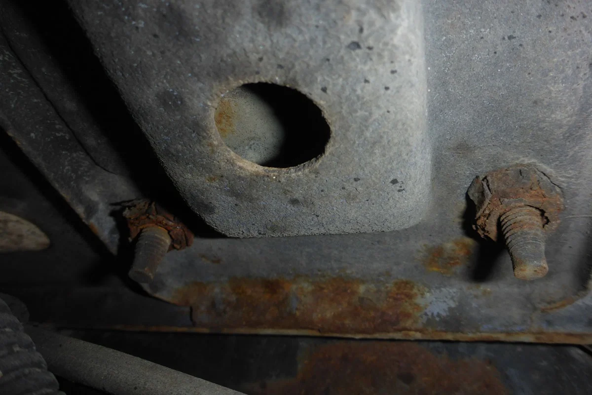

Definitely soak em in penetrating oil and try to turn them out from underneath first .
If it went bad I’d drill em
If it went real bad I’d cut old brackets and make a plate with them for the bottom side and squeeze them to the tub using new hardware.
