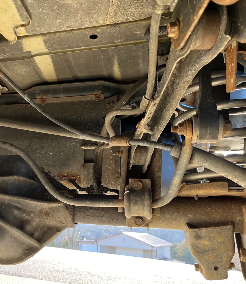

What length sway bar links do you have? Do you have a picture of them at ride height?
Factory rear links. I do not believe these were swapped out so they should be stock. I looked through my pics and these are the only ones I have with them from when I was first assessing what I have to work with. I know I haven't measured them, but I will try to grab some numbers the next time I am under there. I can get a couple more inches of drop if I disconnect the sway bar.
