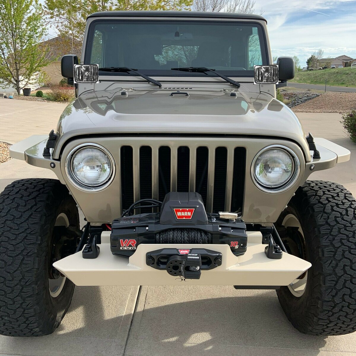

I have almost the same setup as Plumber. I got my lights off amazon from a company called 4wdking.
My thought on lights and placement...
Light bar across top of windshield is not a good place. Too much reflection off of the hood, and if you are in dust, you won't even be able to see the end of the hood when you turn it on.
Light bar on the hood is not a good place. The hood will keep the light from shinning onto the ground in front of the vehicle.
Floods on the windshield hinge mounts is not good. Again, too much reflection from hood and dust.
Spots on the windshield hinge is better. You can project the light past the hood and onto the ground while minimizing reflection from hood and dust.
Floods on the bumper is better. Cast a bunch of light all around without having any of the before mentioned problems. This coupled with the spots on the hinges will help eliminate some of the long shadows you were worried about.
I'm not a fan of light bars in the front of the jeep anywhere. Most are combo lights (flood/spot) and make it hard to control where the light is cast. I think having lights coming from different heights is the best approach.
So I have spots on the windshield hinge and floods on the bumper. All our trails in Utah are dusty and this combo seems to light up the trails and still let me see through some of the dust.

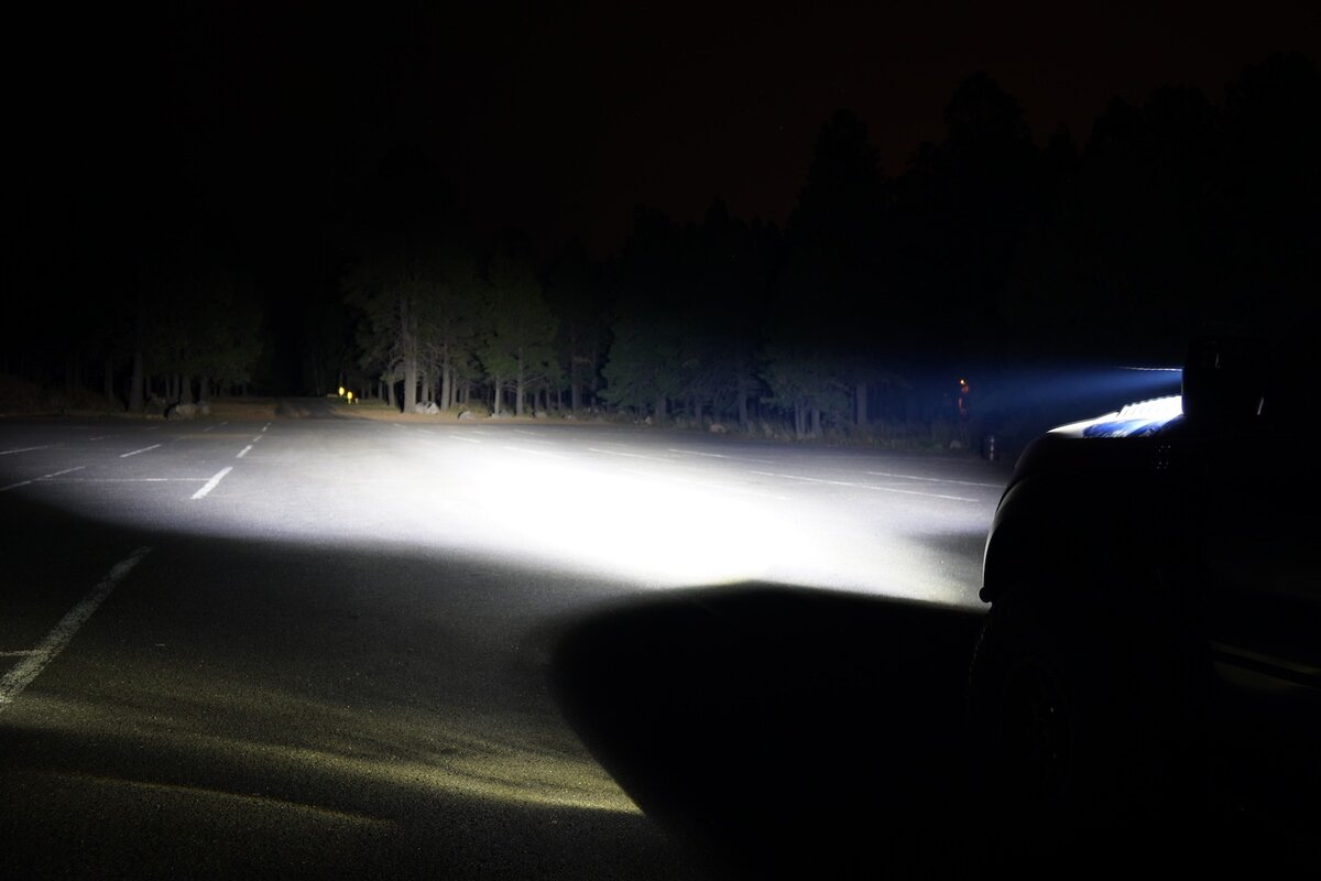

Here is a pic posted on the KC site of the G34 lights on the A-Pillar. It doesn't say if these are the Wide Beam or the Driving Beam. It does light the hood a little bit and also casts a pretty good shadow of the hood right in front of the vehicle. I don't know if the headlights alone would fill that dead spot or not.

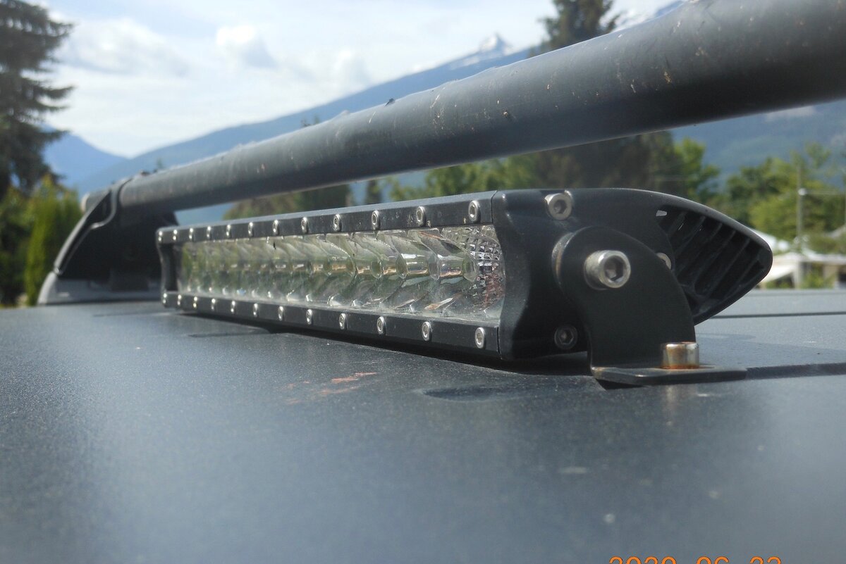

Here’s my trusty light force set up . Please don’t get me wrong , being old school, 9 inch lightforce with different Clipinfo diffusers
- each light draws 8 amp, but .... you get what you pay !!!
- mine are 14 years “old” and holding up from minus 40 Celsius to plus 30 Celsius
- next step is RIGID , with a combo light bar. IMHO
- don’t waste your $ on Chinese knockoffs

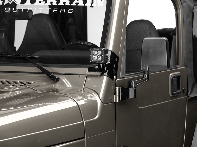

A-Pillar Side Light Cubes
plus a small light bar.
The SideLighters were $49 and the LightBar, $72 on Amazon. Best deal I've ever found.

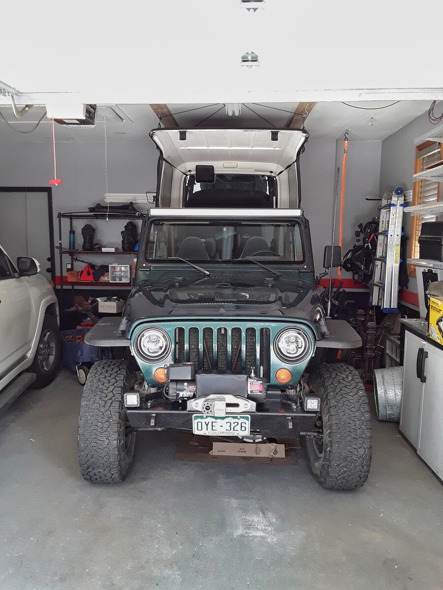

I didn't know what I was doing when I was getting lights, and I'm going to be changing it as soon as I figure out what I'm doing.
I have OZ-USA 3" cube which was sold as a spot/flood but the lighting pattern is pretty much a fog light. Above the windshield I have a 52" Yitamotor light bar. It's stupid bright, like 27000 lumens, but it lights up the hood and the dust and snow so it's gotta go.
I was thinking of putting some 6" spots on the bumper and a 12" bar on a fairlead mount. But after reading this thread I'm thinking maybe the spots would be better on the windshield hinges and keep the cubes until I pull the trigger on 4" gravity fogs from KC. I've never really liked the way the cubes look, and they got worse when I put on the MCE fenders and round JK turn signals, but I want to have some fog lights because while we don't get fog often, when we do get it, it can be scary thick and always seems to happen while I'm traversing a mountain pass.
