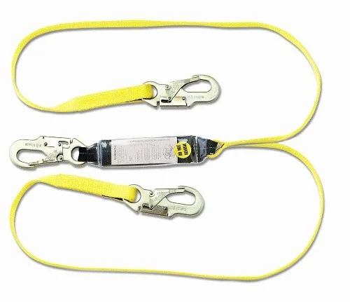

This example does show a possible new product opportunity: shock-absorbing fuseable link to limit overloading in a controlled fashion. Basically an upsized shock absorbing lanyard like that used for industrial fall protection: folded webbing stitched together where the stitches rip when overloaded, letting the webbing extend. This would make the Bubba-ropes a bit more Bubba-resistant.

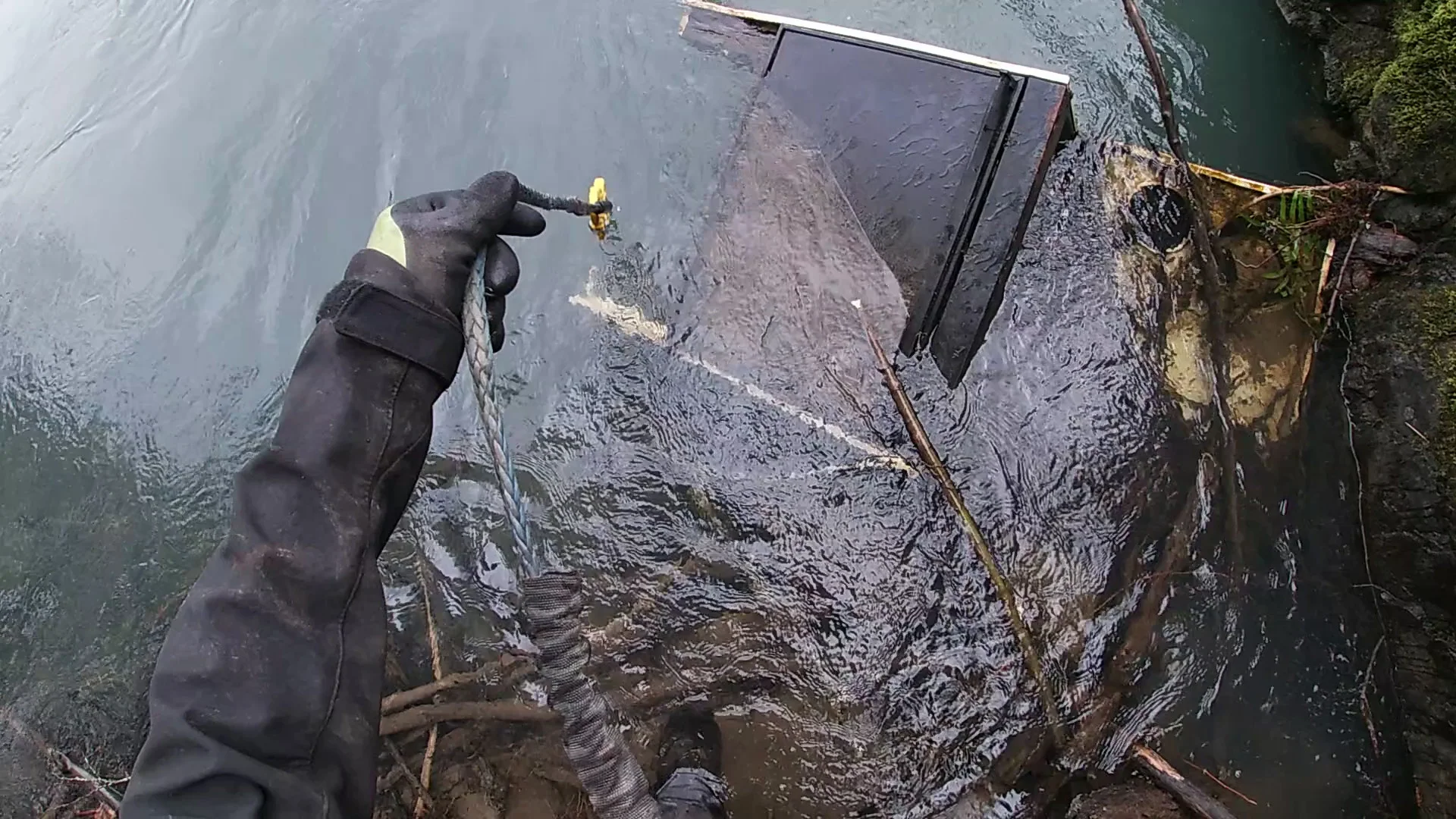

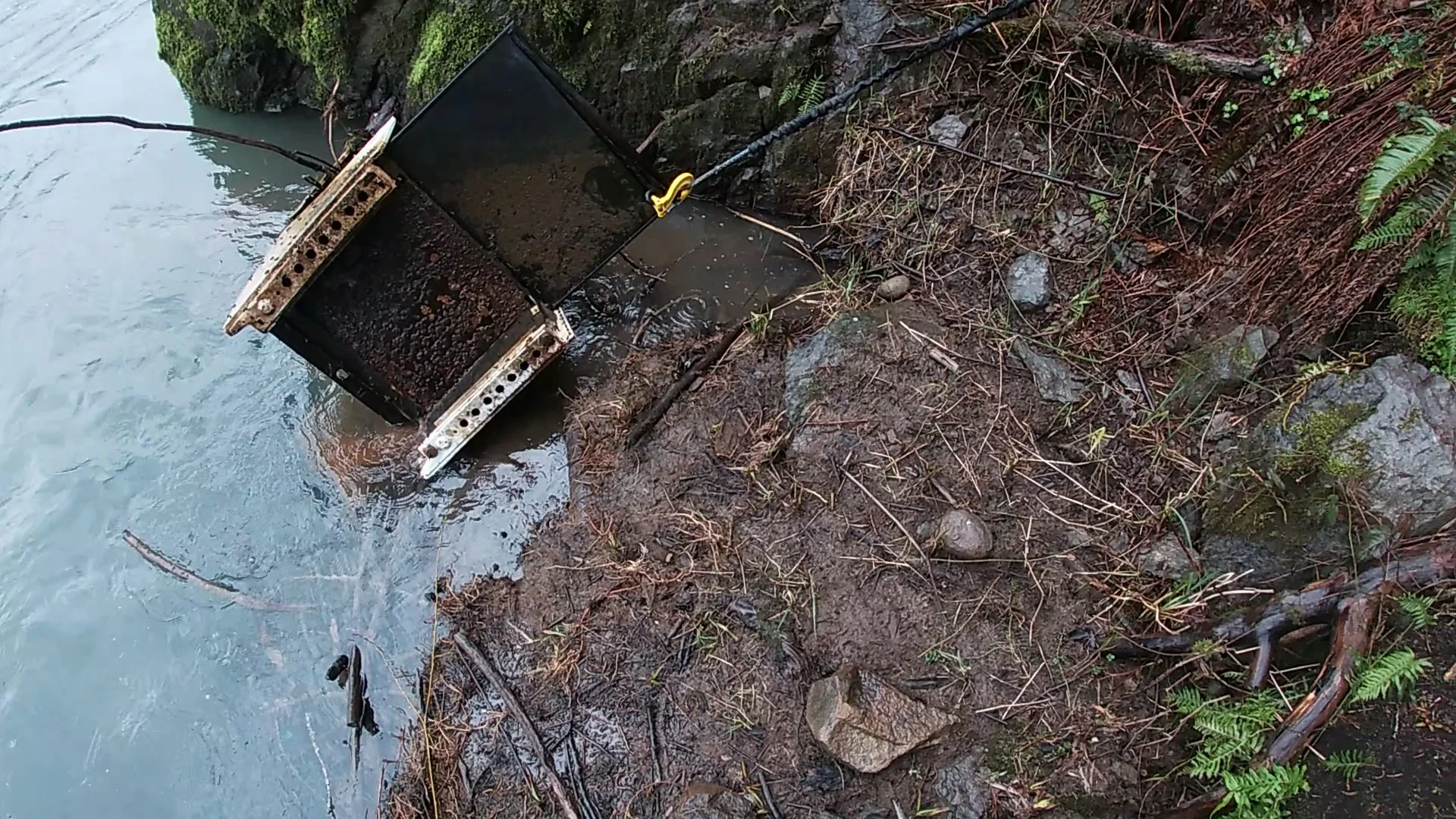

It really sucks when you can't find a decent recovery point on a vehicle.
It really sucks more when you can't find a recovery point on an oven...in an ice cold river...
I've always thought soft shackles were my fuse in my recovery system. I like that sewn together fuse idea.
You would be adding a whole level of complexity and additional connection points that we try so hard to avoid. You are better to properly size your kinetic line, make sure your connections and rigging are up to snuff then use them as intended.
