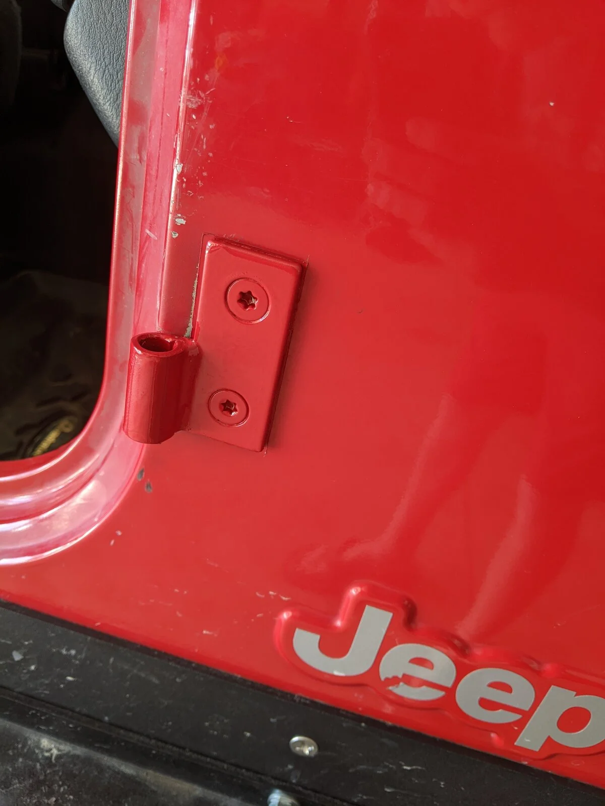

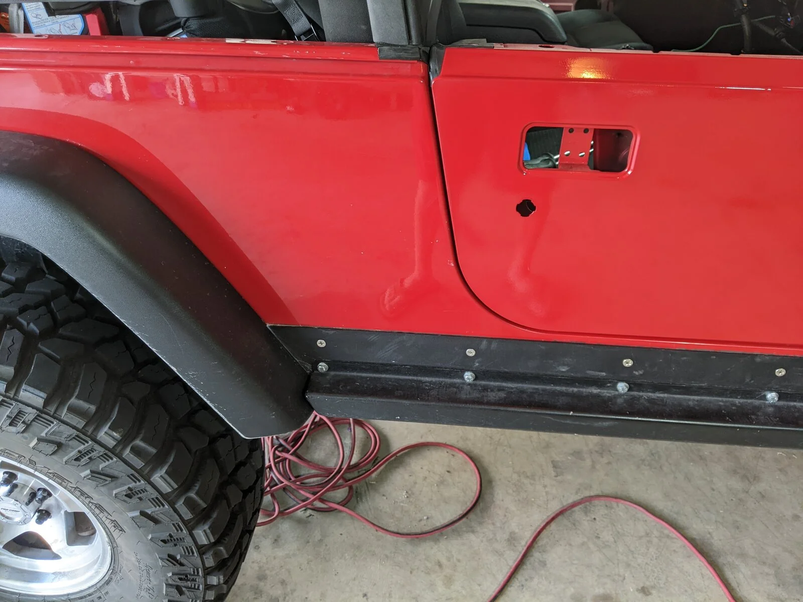

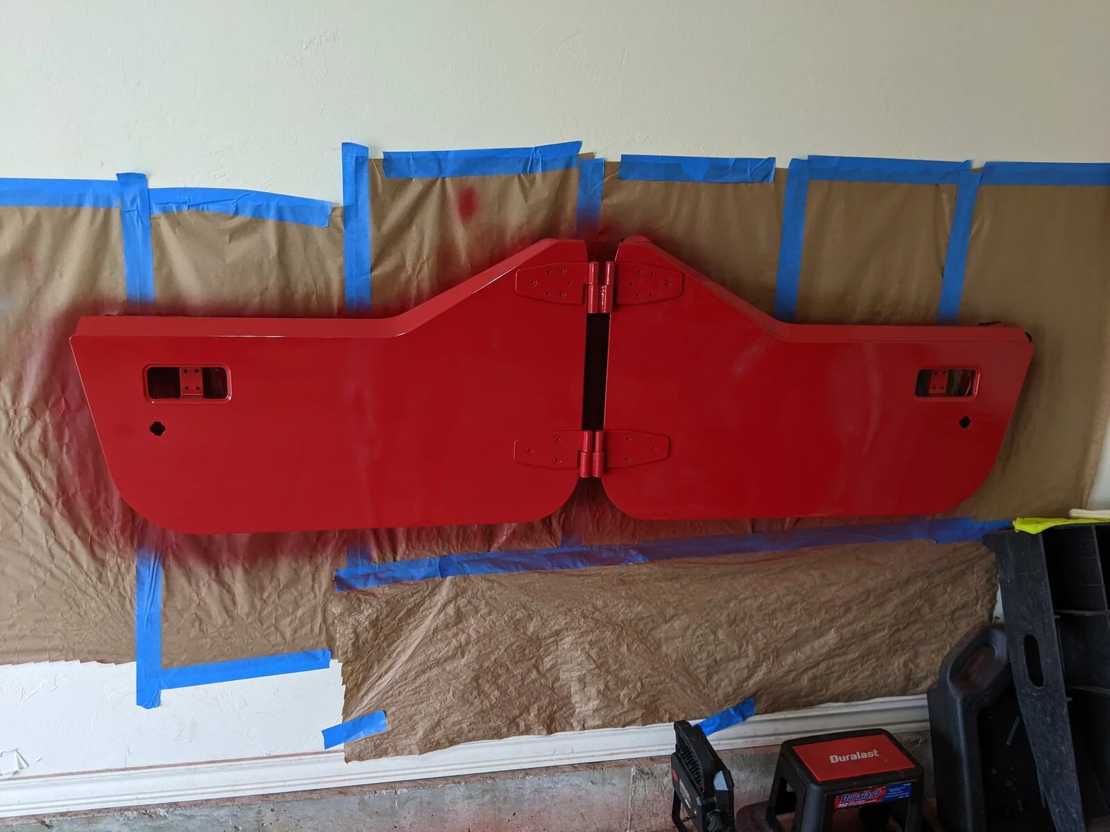

Colored and cleared. I love the way the spraymax cans spray. Good wide pattern that's easy to overlap and get a good wet edge.
Not having much experience, I don't know how perfect of a clear coat finish can be achieved right out of the gate without and buffing and polishing, let alone what can be done with a $25 aerosol can, but I feel pretty good about it.
Looks good. How’s the color match?
I haven't put them by side yet, but it looks good so far. I just got done spraying my tub side lower hinges because I destroyed the paint while bashing out some worn out hinge pin bushings...so I need to give them 24 hours or so before I put the new bushings in and mount the doors, but I can probably pull the masking in a couple hours and see how the hinges came out.
Just based on the hinges, it's about as dead nuts on as I could have hoped.
I'm happy with the color match.

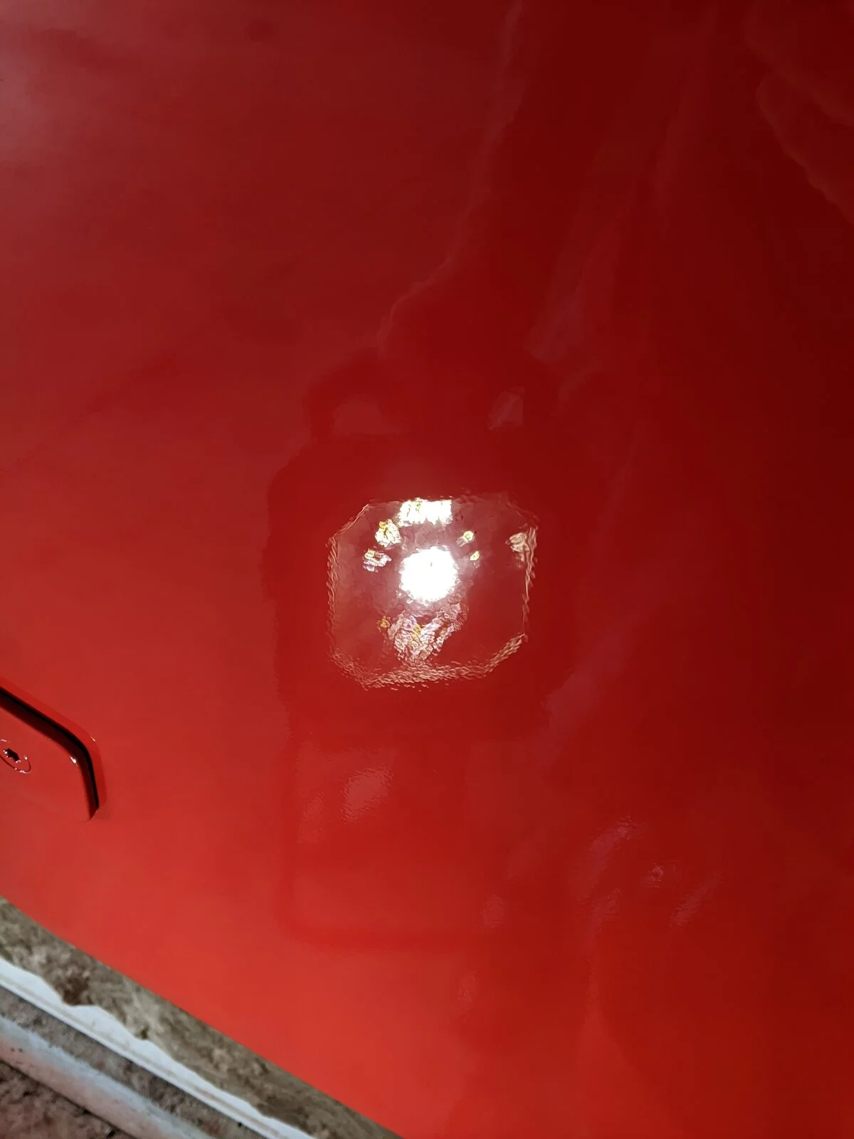

The surface finish could use some work (note the sharpness of my leg and foot in the reflection from the tub vs the door), so I guess I'll be researching how to buff orange peel out of clear coat. Definitely not an emergency though, more of a 5 foot observation.
Gonna give it another 12 hours or so to cure (clear says it's ready for polishing after 24 hours) and then I'll put the handles, lock cylinders, and door panels on and transfer my mirrors over from the full doors.
The surface finish was bothering me so I took a stab at wet sanding, buffing and polishing. I probably spent a lot more time, and cutting compound, than I could have because I've never done this before and I was afraid of burning through, so I was being super cautious and wiping it after every 2 passes to see if it was good enough.
I was using a harbor freight rotary buffer with a wool pad and wizard mystic cut compound, as recommended by my local auto paint guy (the pad and compound, not the buffer). I'm not sure about the polisher, it's variable speed with a dial but it also seemed to change speed unpredictably based on how much pressure I put on the trigger and how much resistance it felt. I can't imagine that's normal so I might invest in a quality tool if I do this again.
This was after maybe 4 passes? I thought it was good until I tried to get a pic of the reflection and it came out like this.
So I used what was left of the tiny bottle of cutting compound I had and got a other 4 passes or so on, and I topped it off with some meguiars polish on a 3m foam pad and then some quick detailer.
Here's where I ended up, which is definitely not show car perfect but it matches the rest of the tub so I'm happy.
And for comparison this is what I started with, and frankly it was the best spot between both doors

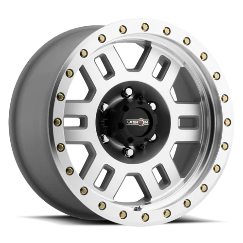

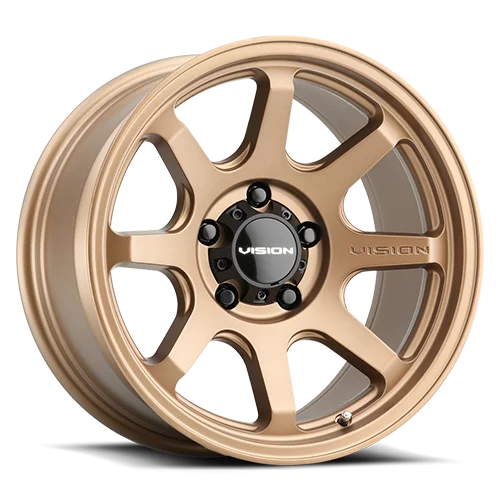

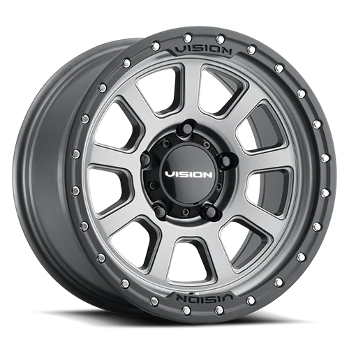

Vision has a few, like this...but for whatever reason they save bronze for 6- and 8 lug, and wouldn't you know it, the JK/JL 5x5....only black and gray centers are available in TJ and CJ. I could probably live with gray more than black, but still not my preference. Their 5x4.5 options, like Method, ends up choosing between a wider stance or lost turn radius.
Ojos
Manx 2
I like this one, but again, my color choices (bronze or machined) isn't available in 5x5.5 or 5x4.5, only black center with machined or black ring.
Manx
This one is available in bronze...but has a lip vulnerable to rocks just like my current wheels, only worse because my current wheels are machined so the gouges don't stand out in color as much as they would against paint.

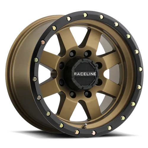

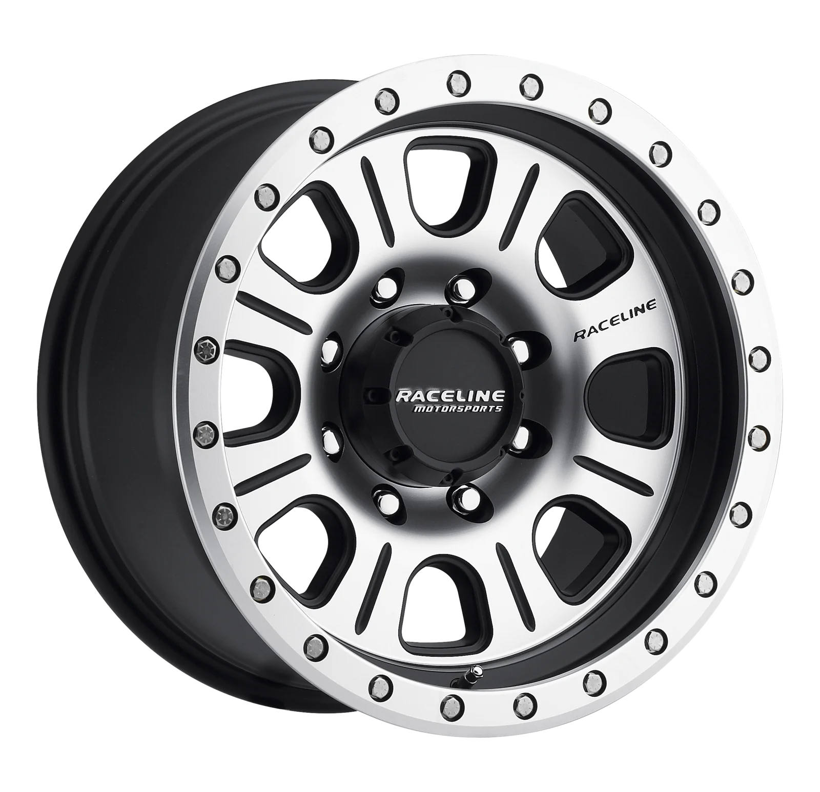

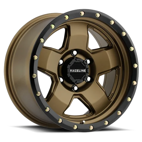

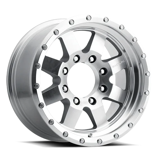

Raceline has a few that would work with the CJ pattern
937, 935 Defender, and 928M Monster Streetlock
and a couple models that have options that would work for either CJ or TJ
Defender, Boost

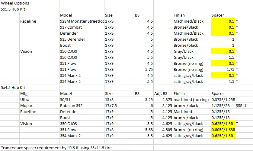

Here's the notes I've managed to put together so far.
The 4.5 hub kit pretty much nails me into sticking with 15s forever, or Raceline wheels, which run about $100 more per wheel than Vision, eating up any savings I might have had between the WU-07 and WU-08 hub kits.
The 5.5 kit feels like the most "future proof" option, but if I had a gun to my head and had to do this today, I'd probably go with the 5x4.5 hub kit, so I could roll with my current wheels until I wear these tires out, and hope that by the time that happens, Raceline was still manufacturing what few options remain or the market loses interest in the Rubi 392 takeoffs.
Ojos
Manx 2
Manx
Defender, Boost

Couple things to consider, the hub kit will post the wheel out about 1” on the 5x4.5. I don not know how much wider the 5x 5.5 kit is. I was looking at doing this also and from what I saw 17” tires are about $100 more than 15’s
Yeah that's the reason for all this. The 5.5 kit doesn't add any width from what I've been able to find. If the 4.5 kit maintained the original WMS width, this would be easy.
I'm in no rush to go to 17s, but I figure over time it's probably inevitable as 15s get discontinued so I don't want to put myself into a situation where I can't find tires to fit my 15s and can't find wheels with proper dimensions to accommodate the front axle being 1.5" wide. I don't care so much about the disparity between the two, I just don't want the front sticking out way past the flares and I don't want the rear touching the spring perches.

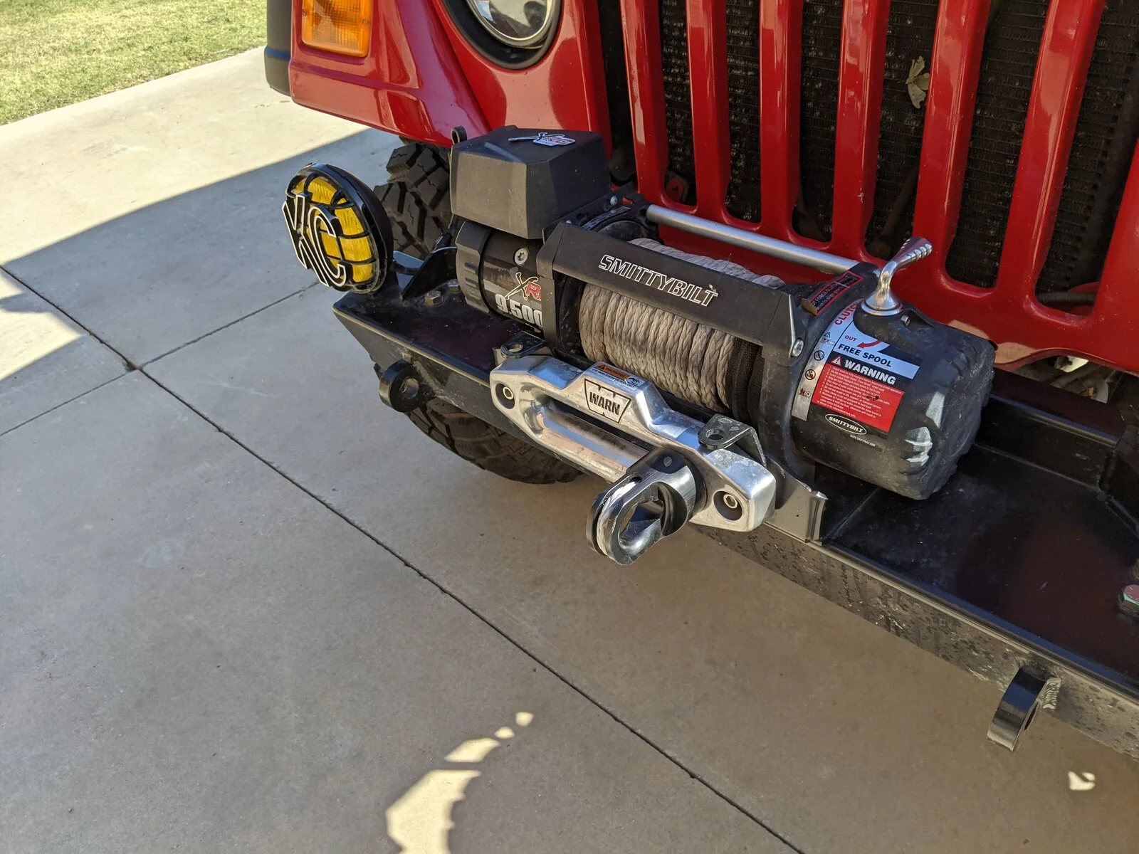

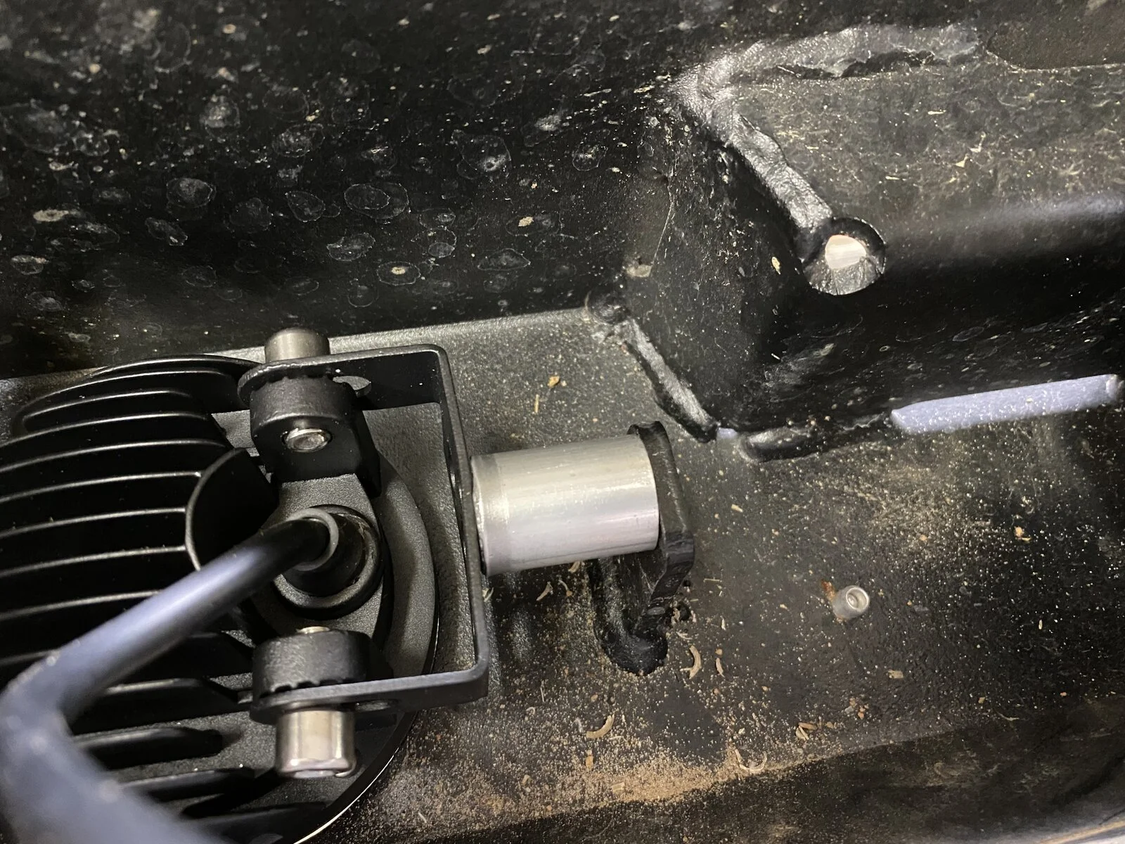

I'd rather have the thimble set in an ST fairlead so it doesn't stick out but I don't think that would fit under the 12" light bar I had planned to mount on the tabs above it.
You could use some aluminum tube to make some spacers to raise the light bar above it. Not sure if it would look odd being too high though.
I used this for spacers on my rear bumper lights, but you can’t see them.
uxcell 6063 Aluminum Round Tube, 300mm Length 19mm OD 9mm Inner Dia Seamless Aluminum Straight Tubing https://www.amazon.com/dp/B07YCHK2C1/?tag=wranglerorg-20
yeah, I could come up with something I'm sure. Might have to see if somebody can give me the height dimension of the ST fairlead so I can get a feel for where it might sit. The whole point of mounting the light there was partly because it would sit in front of the winch and not cover up any more grill real estate and busy-up the front end. I'm good on fogs and long distance spot, but I could use some flood lighting up close, hence the plan for a bar. Maybe I could tuck the light up and back behind the thimble...
Reactions: Wildman
I couldn’t hold a ruler, tape measure and take a pic at the same time, but the top of Blaine’s ST fairlead is 3 inches above the centerline of the mounting bolts. Maybe just under 3 inches.
thanks for the info. Add the 4" length of the thimble and it ends up almost 2" above the top of the winch. The only way that leaves my light plan viable is if I can tuck it behind the thimble.

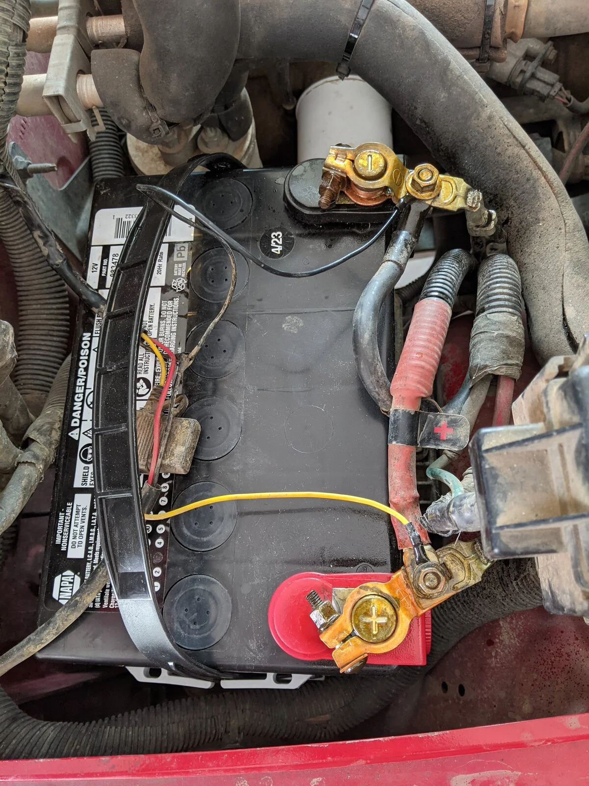

Battery was dead, and since NAPAs AGM was not THAT much more than a FLA, I finally sprung for one. While it was out I also soaked my terminals I'm vinegar for a few minutes and cleaned them up with a wire brush, before installing and spraying with some battery terminal protector stuff, which gives it that gold color.
The new cleanliness of the battery and terminals makes my auxiliary light hookup look like crap and I have another one to wire up so, as one project begets another, now I'm looking for an auxiliary PDC/fuse box to clean that up. I got a 34/78 battery so I'll probably wire it to the side posts.
Also: being the first time pulling the battery I learned today that mine is one that does NOT have a battery temp sensor. My battery tray could use a respray but its in pretty good shape from a corrosion standpoint. I got the shop vac out and cleaned up all the dirt and pebbles that had accumulated in it but I've got too much on my plate to deal with it right now so I'll have to come back to it.
