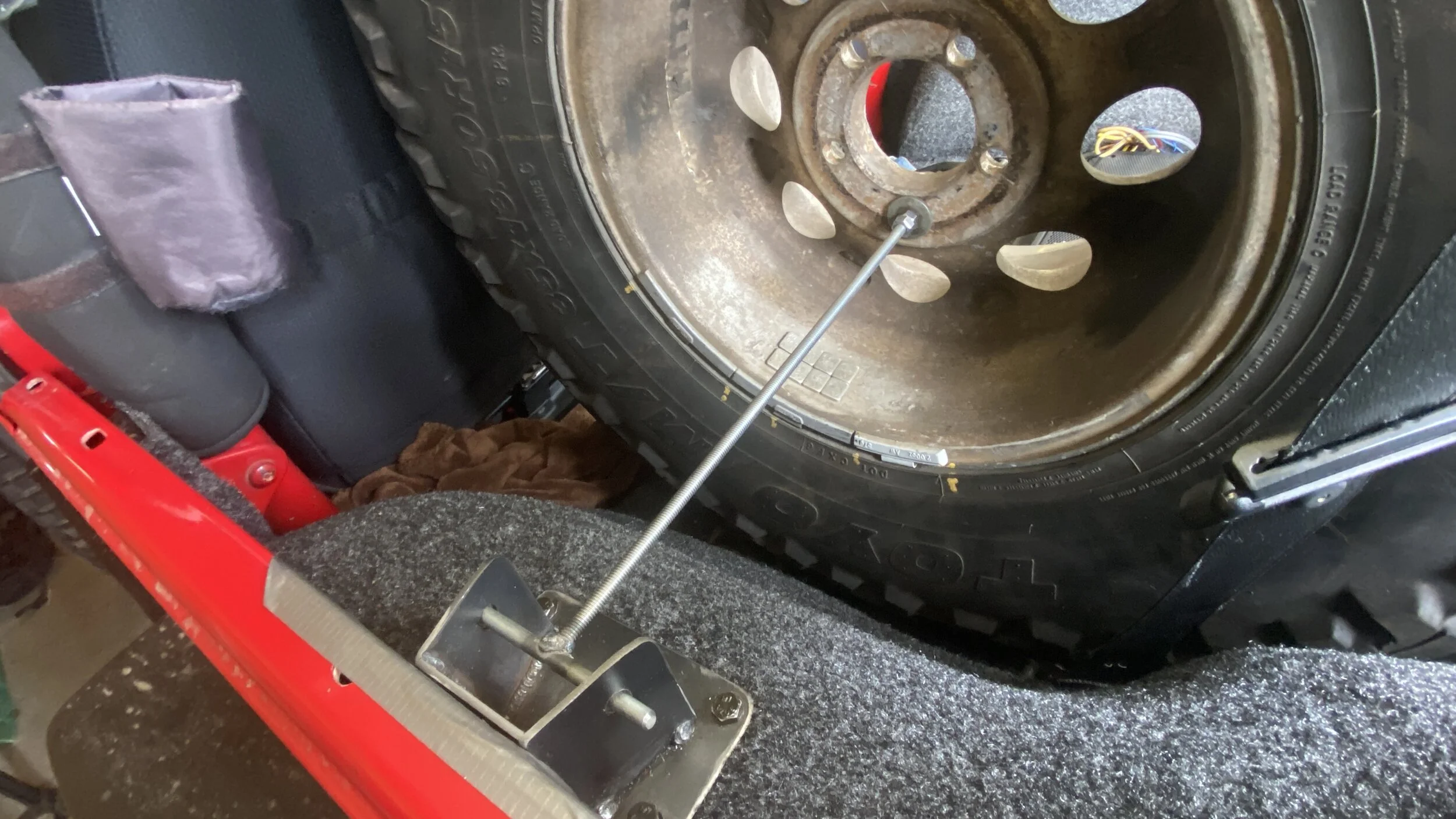

I fabbed a bracket that bolts to the fender wheel well and supports a lateral threaded rod that uses a nut through the wheel lug hole to hold it from moving left/right, and a strap over the tire to hold it from moving forward/backward.

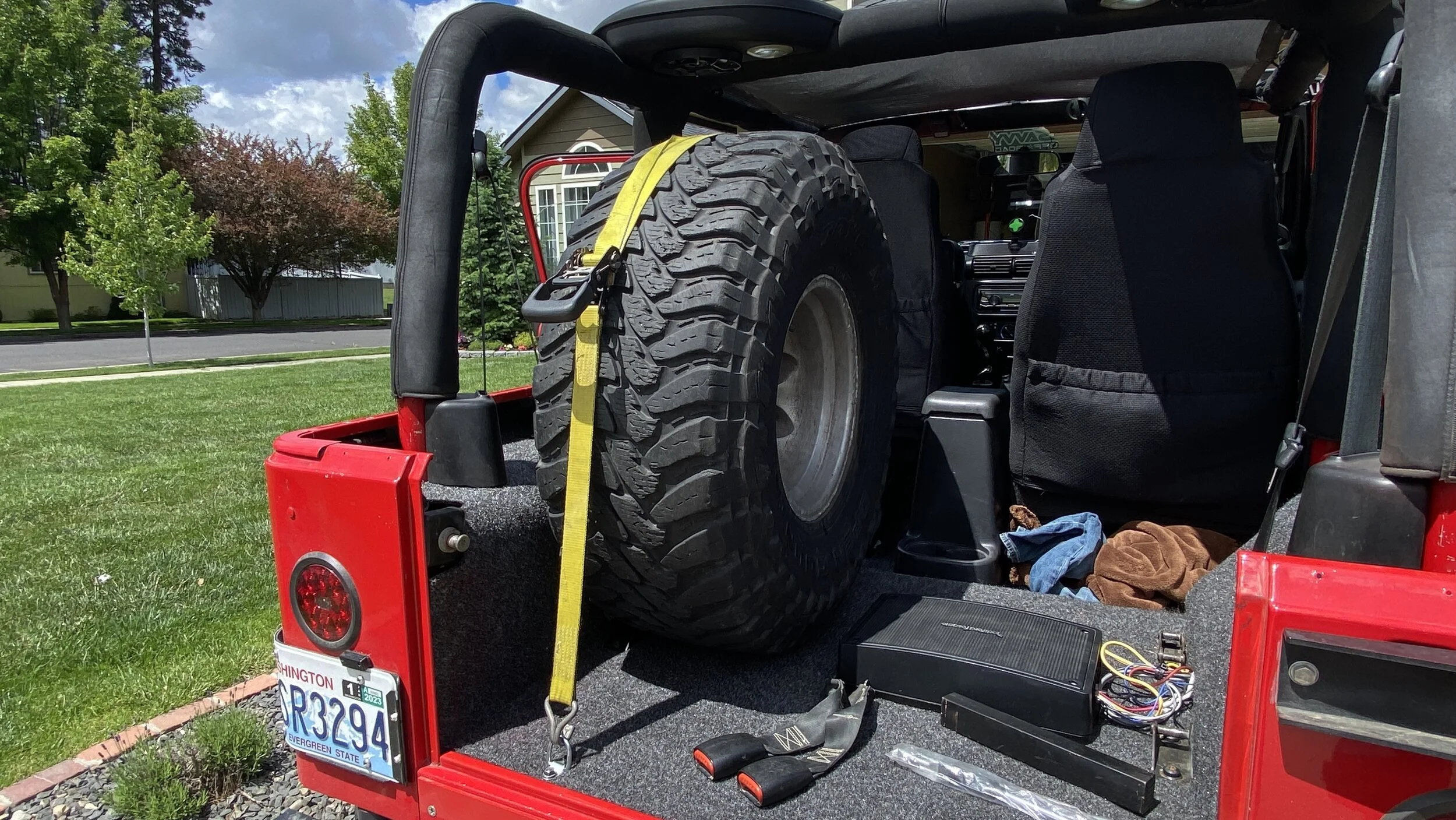

It held no problem for about 6 hrs of wheeling, then worked its way loose. I tightened the strap and it was good to go again. I suspect a 3” strap with cletes would hold it better.

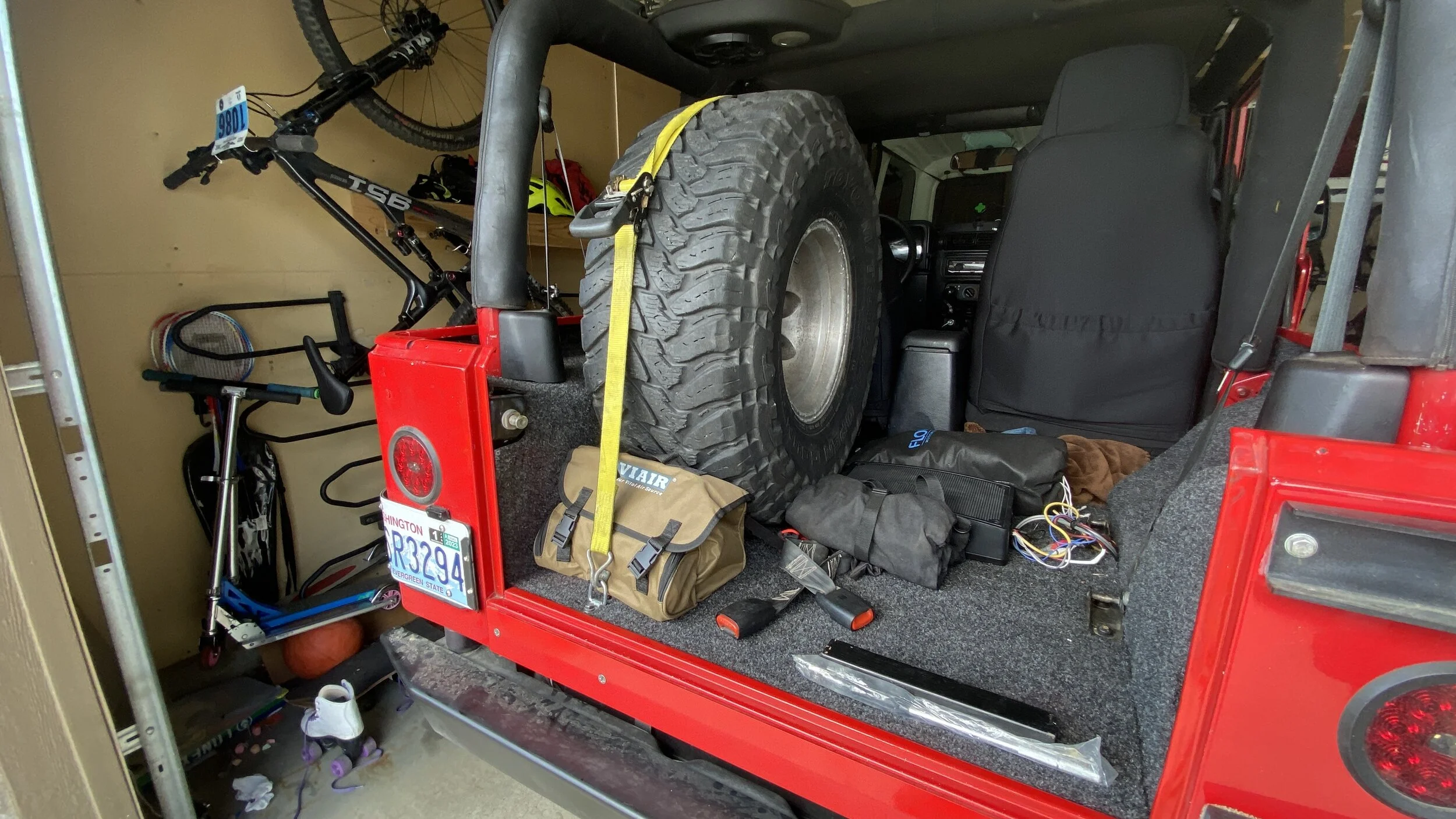

Was mounted behind drivers seat and so it did not impede visibility and still had floor space for storage.
