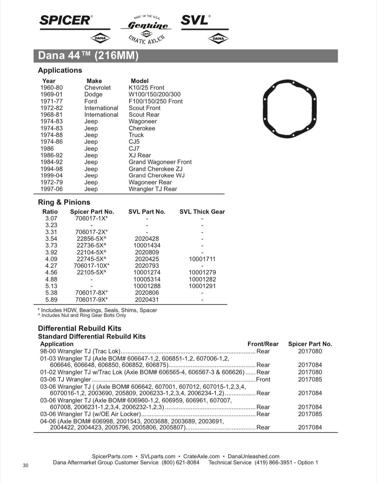

I would say Genuine Dana/Spicer gears that are made in the USA, everything else is made overseas. But they dont offer a 4.88 for some reason
what do you guys think about Alloys USA gears?
They are the ones available over here. Any experiences/insight?

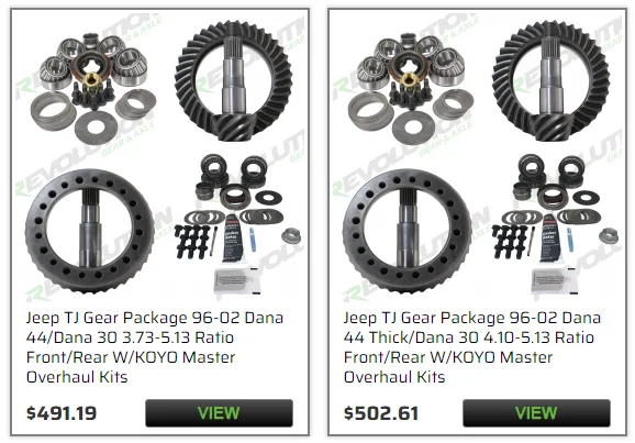

It looks like this would be my selection on Revolution Gear. Between these two for my jeep. What is the difference between the Dana 44 and Dana 44 Thick?
Thick means the ring gear is extra-thick so a low ratio gear like 4.88 can be used on a differential made for a high ratio gear like 3.07. The thicker ring gear moves the teeth of the ring gear over a bit more so they can reach the teeth of the smaller diameter pinion gear that comes from a low ratio like 4.88. What ratio is in your Jeep right now?
Reactions: TheBoogieman
3.73
Dana 44: You can use a thick gear set to continue using your Dana 44's existing carrier or locker. If you are going to install a full-carrier locker I'd go with a locker made for a lower ratio like 4.88 which would mean you'd go for the standard (non-thick) R&P gearset.
Dana 30: Use the non-thick R&P. The carrier break for the Dana 30 is 3.73 to 5.13 so 4.88 will work fine with it.
