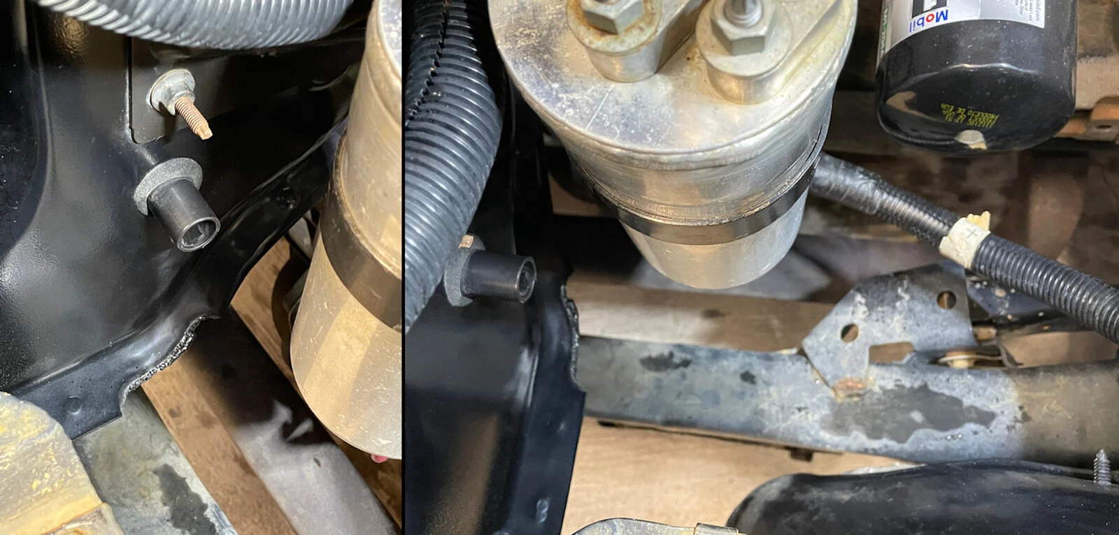

I read on a thread that someone installed a 3/4" 90 degree elbow on their a/c condensate drain. Should I also install a short length of tube to the elbow? Secondly, I get, what I call, a lot of water draining on the drive/garage floor, from the condensate drain. Is there a "normal" amount to expect?

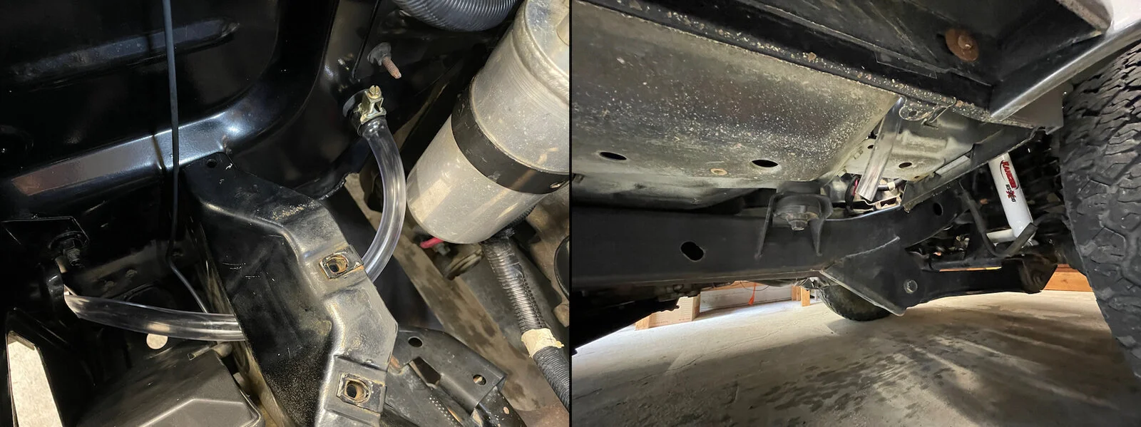

I could see how water from the drain was leaking onto my frame before the ground and wanted to avoid that. I bought a long length of coolant-like hose with a 90° elbow off the small drain spout, routed it down below the frame rail, cut off the excess and zip-tied it in place on both ends.
Supposedly, Mopar part #56000724AB fits the 2001-2006 models. Its a short extension with downturn you can put on the drain. However I didn't want it draining that high up and went a different route.

I ran a hose from mine down to the side of the frame so it drains directly to the ground. You don’t really have to.

I did the same, just used what i had laying around. Not really needed like you said, but it helps keep the water off the frame.
