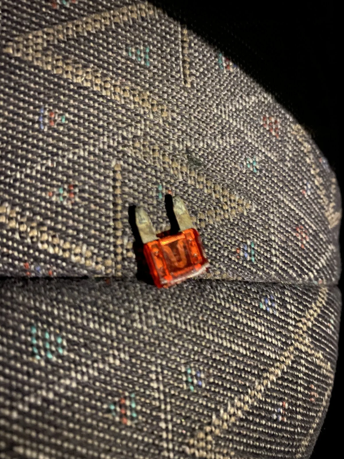

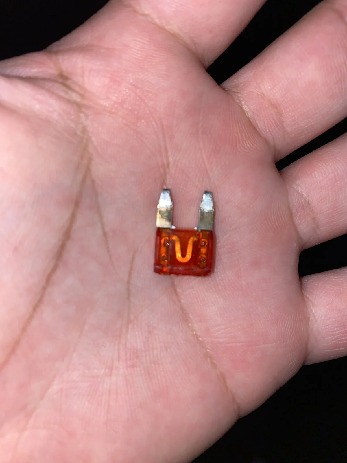

Hi everyone so after months of searching I finally found my TJ :) as I about to go for my night I drive I realized my instrument cluster and HVAC lights do not come on. My dome lights and floor lights work just fine. Blinkers, check engine, brake, high beams all that stuff works except that cluster lights. I’ve never done electrical work before so I am not sure what to look for. All help is appreciated. The one in the green is not lighting up. Sorry took with flash
It’s probably ok, but I’d pop a new one in just in case. Looks a bit smudged up at the contact areas…
Also check fuse #1
