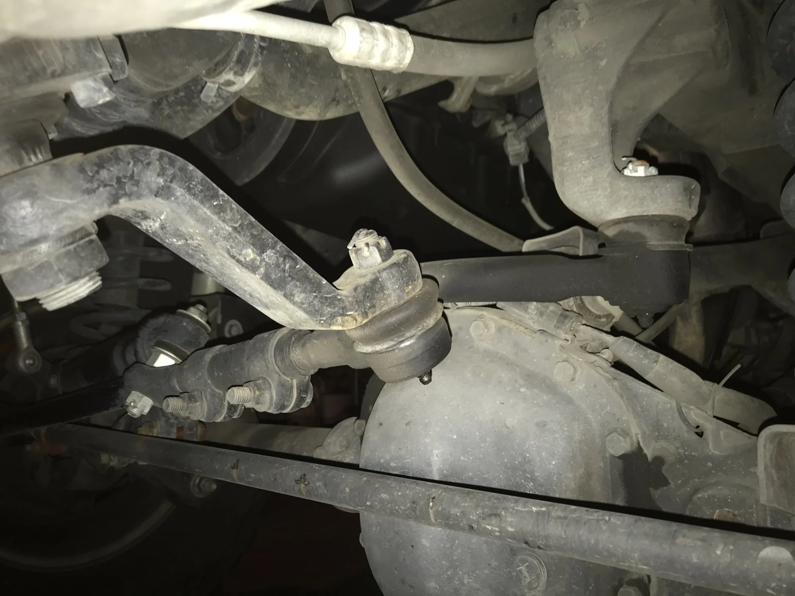

3'' lift. I have a dropped pitman arm, in my case do I just need to replace it with the stock pitman arm? I don't think I have a dropped track bar mount. I don't experience bump steer either.
