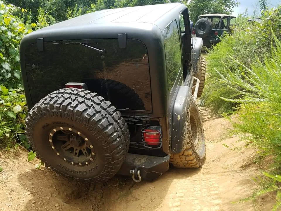

This is with a 4" RC with longer than stock fixed length LCA and stock UCA on the bump stop. No trimming on the tub or flares. The tires had slight contact to the flares. No sheet metal was harmed in this picture.
