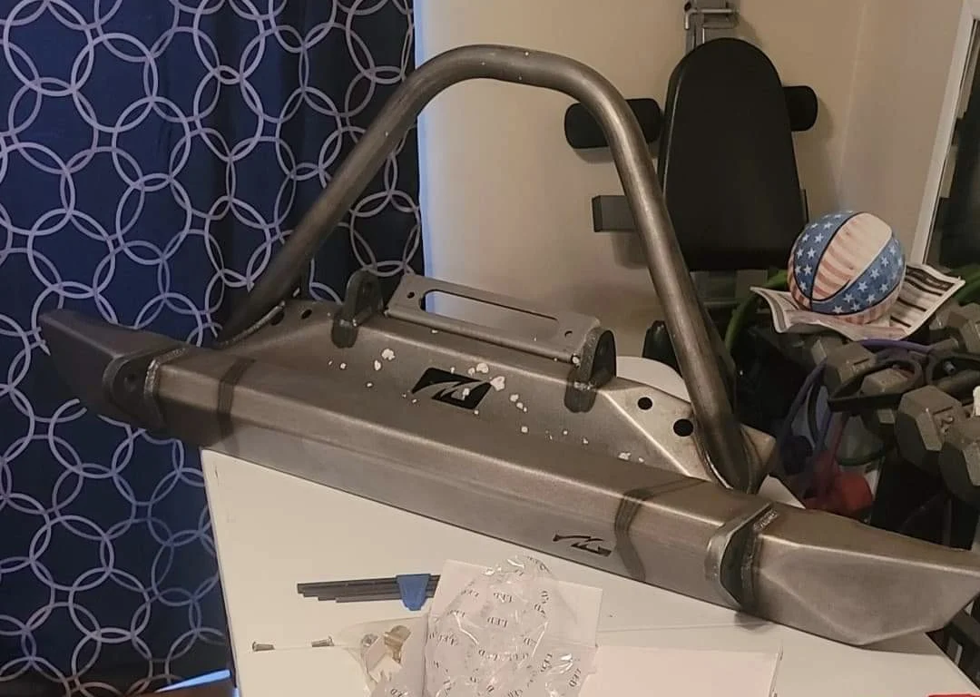

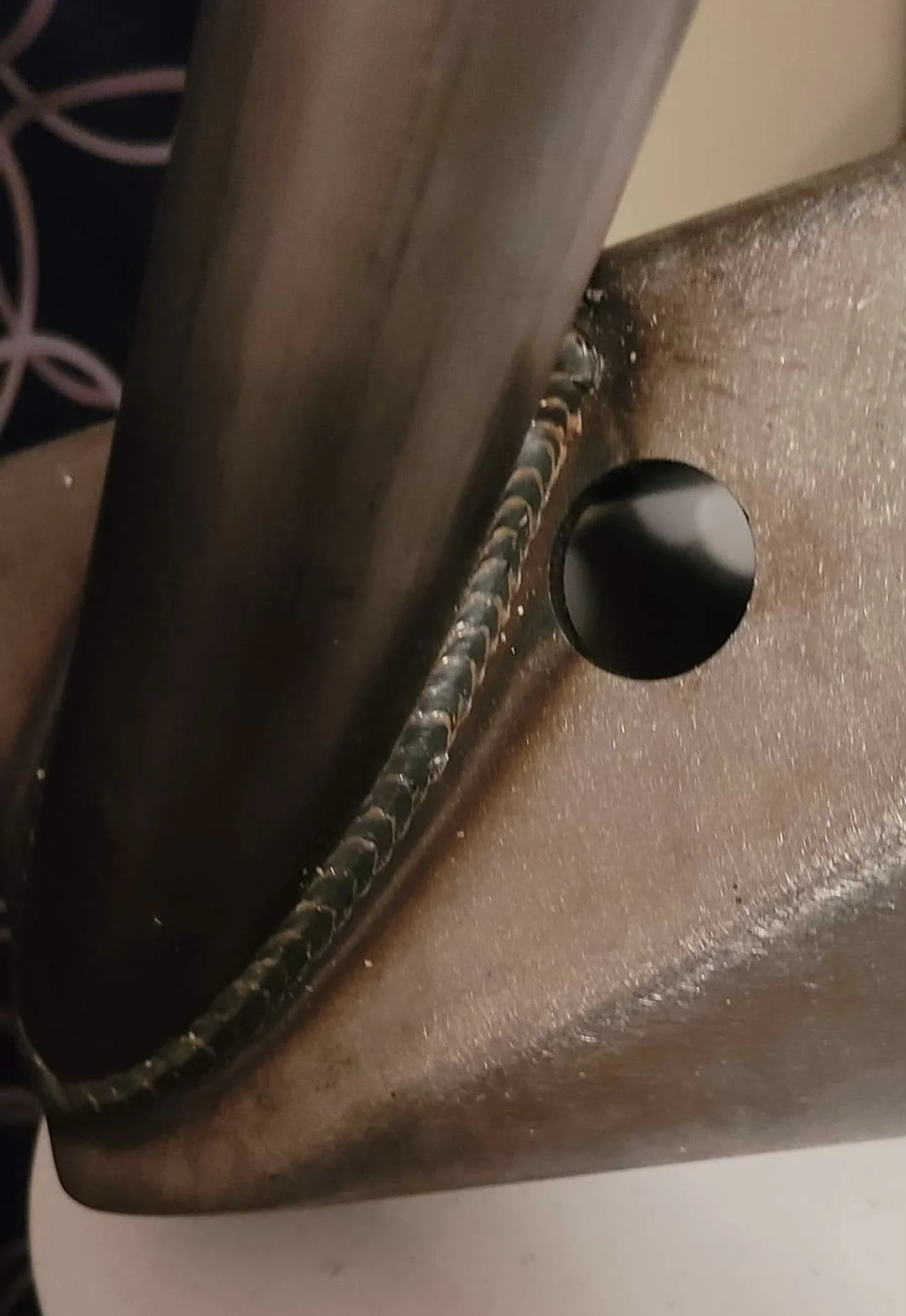

I certainly hope they are as these were Xmas gift from my wife thanks to BF sales. After seeing them happy with quality. I think @jjvw @Tray Burge and few others have Motobilt bumpers also.
Ignore the packing peanuts and other general mess please.

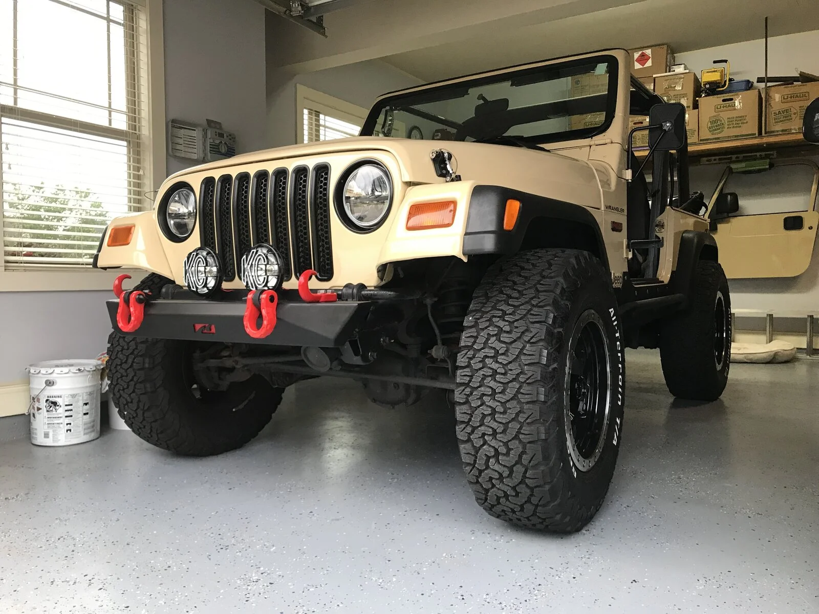

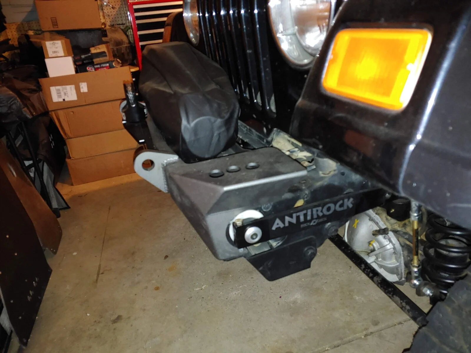

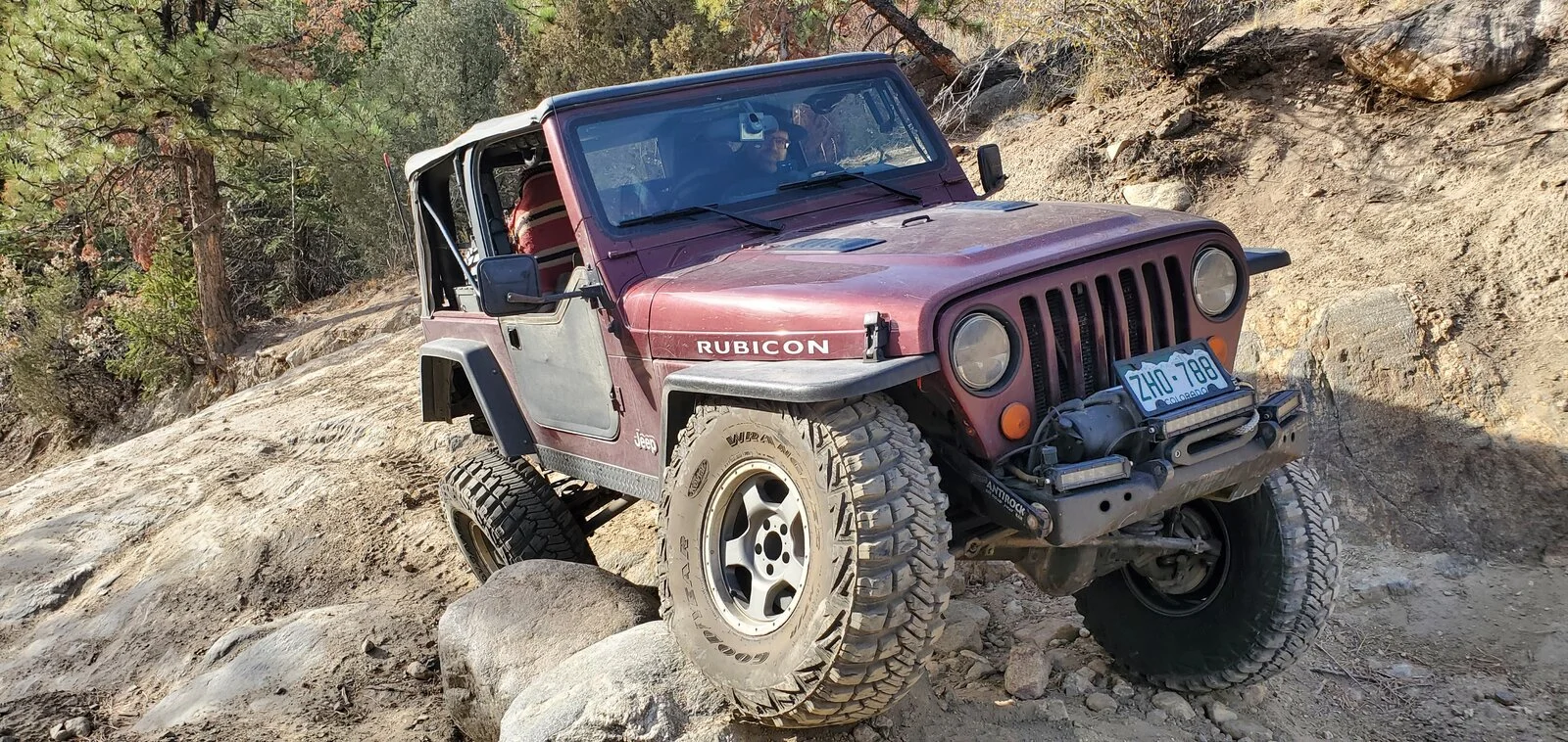

I have their front stubby bumper. Nothing wrong with it and I like it. Though I did completely rework mine into something much more than it was out of the box. The silly M is gone, too.

You filled in the logo, rounded edges on shackle mounts, and added additional upper mounting holes right? Anything else? I’m not bothered by logo (seems personal preference not performance) and will be rounding the shackle mount. Just wondering if is anything else should consider before paint and install.
I added material to brace the lower lip against the front crossmember so it can't collapse upward. The winch has been moved back a couple inches. The light mounts are welded to the deck. I added a thimble keeper. And it's been tapped for a steering box skid.
Beyond really not liking prominent aftermarket logos on my Jeep, I would consider the big M logo a performance issue. If you look at mine, the bumper face is being used as a ramp. I can't see the logo cutout surviving very long before looking worse and getting caught on rocks.
The pic you shared does clearly show rock rash in that spot. I took a quick look and lot of well known brands have logo in same spot. But the Motobilt ‘M’ seems to have more of opening than most.

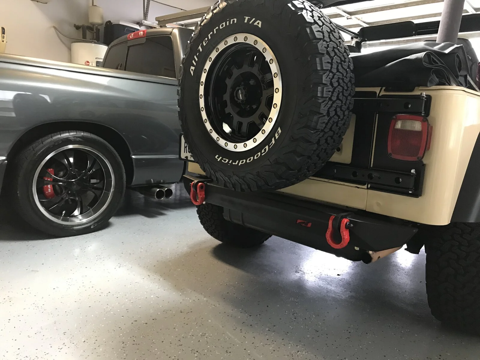

I don't mind the logos myself. They make great stuff too. I went with the stubby bumpers also, I just wish they offered powder coating as an option.

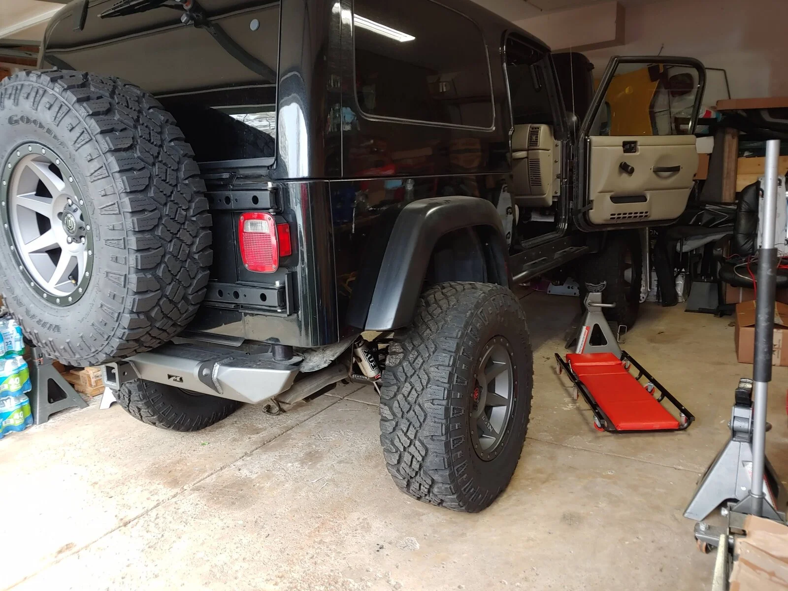

I like my front and rear bumpers, more so the rear. High quality welding and strength. For weight savings and simplicity, will probably go with Savvy for the front though and keep the rear MB. Just not a priority right now. I also am noticing the AR contacting the front bumper, so I'll need to clearance that (may be motivation to sell it).
