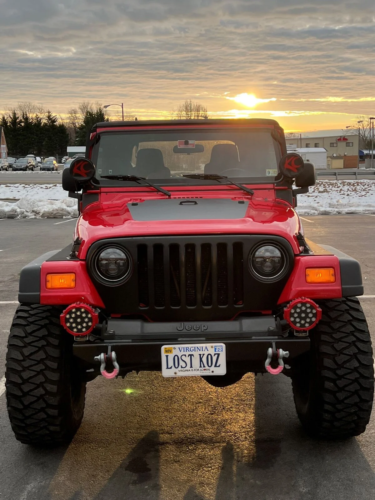

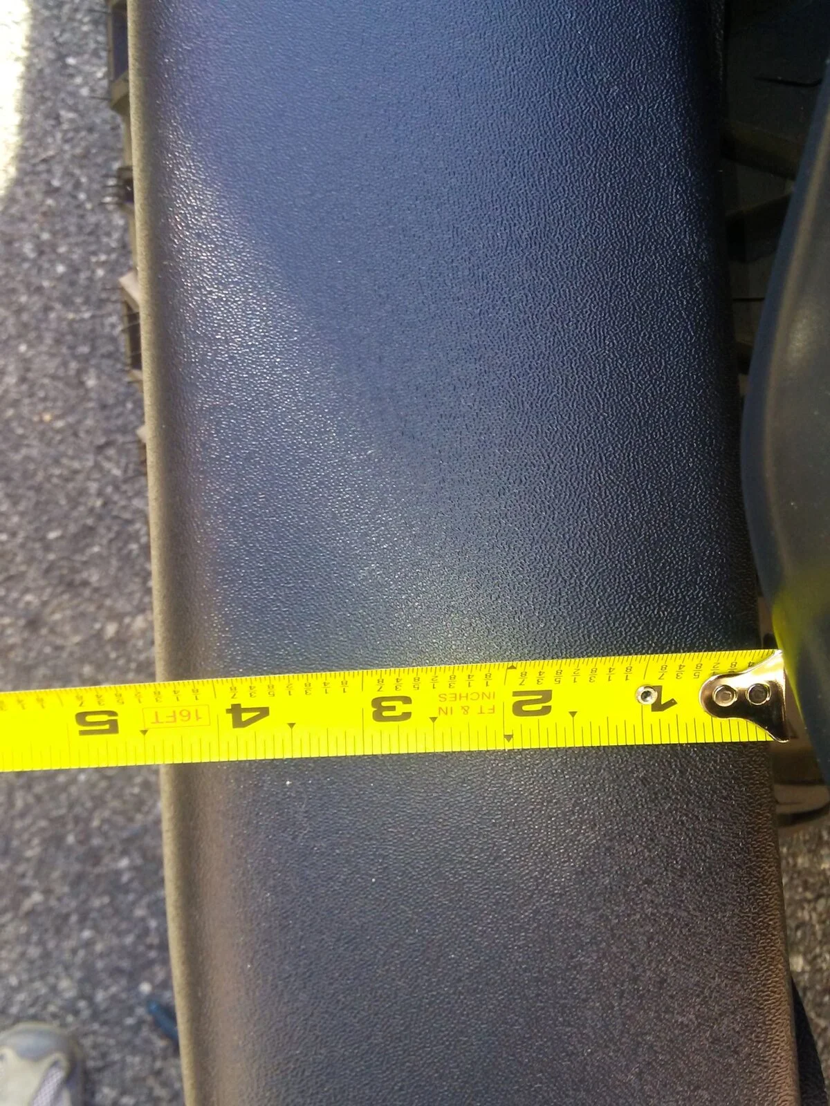

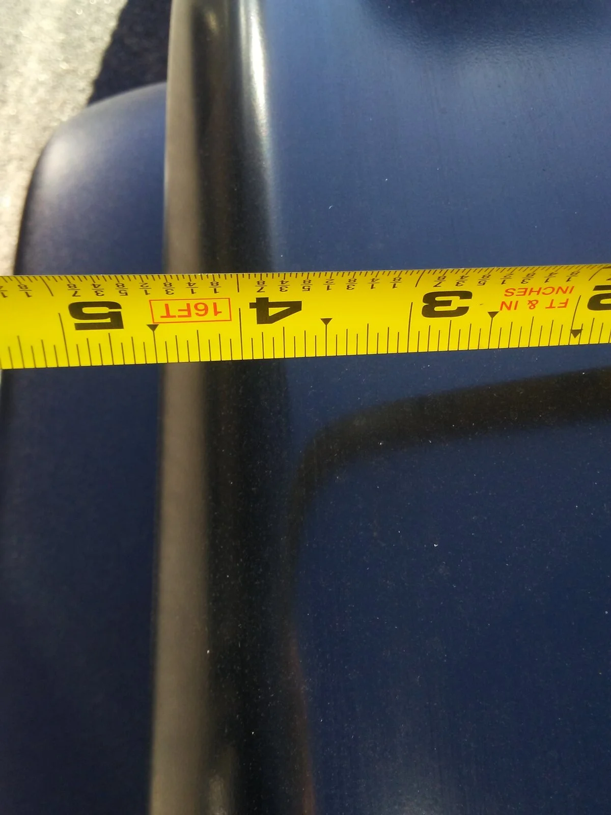

The new RC flares are not 5.5" wide as advertised. They're about the same width as the Rubicon flares.

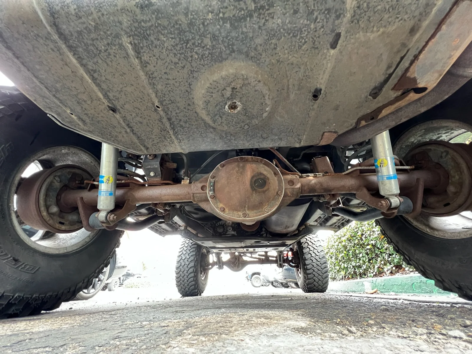

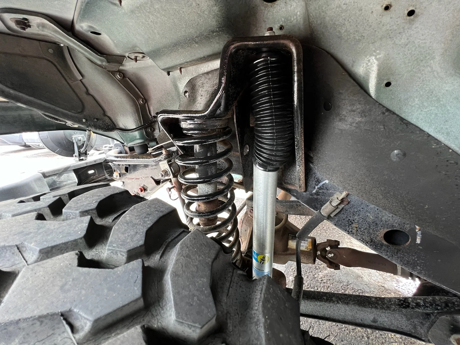

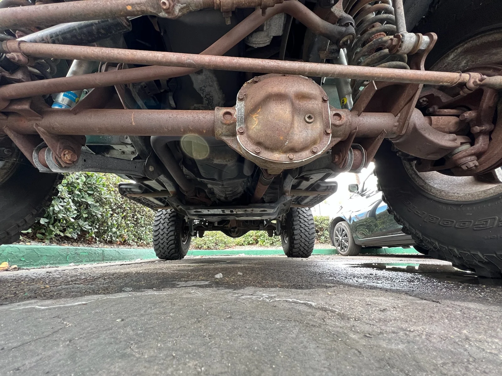

He sent me the carfax and it shows it's largely been sitting since 2008. 1,400 miles accrued during the past 14 years. Goes up slowly and predictably every 2 years with the smog check. What do you pros think? Im thinking the oil in the engine is 14 years old as well as all other fluids. The gasoline in the tank could be a year old or worse.
Some pics of the undercarriage also show a bit more surface rust than I was anticipating. But carfax confirms its only ever lived in Arizona and SoCal.
The rust on the axles is pretty superficial, no sweat there. The frame looks excellent. You will want to replace a lot of the rubber consumables(which you should do anyways) with it sitting like it has but I wouldn’t have any reservations about buying it. Seems like a great Jeep!
You’ll be pretty hard pressed to find a cleaner one with similar miles and price. If you pass on this, every Jeep you look at in your mind you will compare to this one.
Im thinking the same thing. Thanks. Besides all fluids and oils what rubber consumables should I start with?
Dana 35 on a Sahara? Maybe? Check the build sheet. There was a link for checking to the VIN.
I can confirm, I have a Sahara with a Dana 35. It was an optional extra on EVERY, non-rubicon/non-special edition, model with a 6 cyl. Some people who wanted a Sahara spent the money on the Dana 44, others sadly did not...
