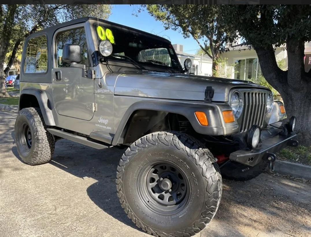

It's running on 33 x 12.5 tires you guys think the dana 30 in the front can handle that offroad? I'm new to jeep, and relatively new to offroading.
Reactions: TRE3TOP
The 30 can handle it. Its the 35 that can't, but that's only if you lock the rear diff. It will be fine for riding around town and some light trails.
I believe the dana 35 on it isn't even a limited slip let alone has any sort of locker. Guess time will tell
I was under the impression the bigger the number the beefier the axle?
Im thinking the same thing. Thanks. Besides all fluids and oils what rubber consumables should I start with?
Belts, radiator hoses, power steering hoses- ( good time to add a cooler) are the main ones. Check the date in the tires, I’d imagine they’re probably pretty old.
A factory limited slip is as much as the factory installs into the rear axle, and a stock Dana 35 is not strong enough for a locker. Generally speaking the higher the number the stronger the axle like Dana 30 is not quite as strong as the Dana 35 which is not nearly as strong as a Dana 44 is.

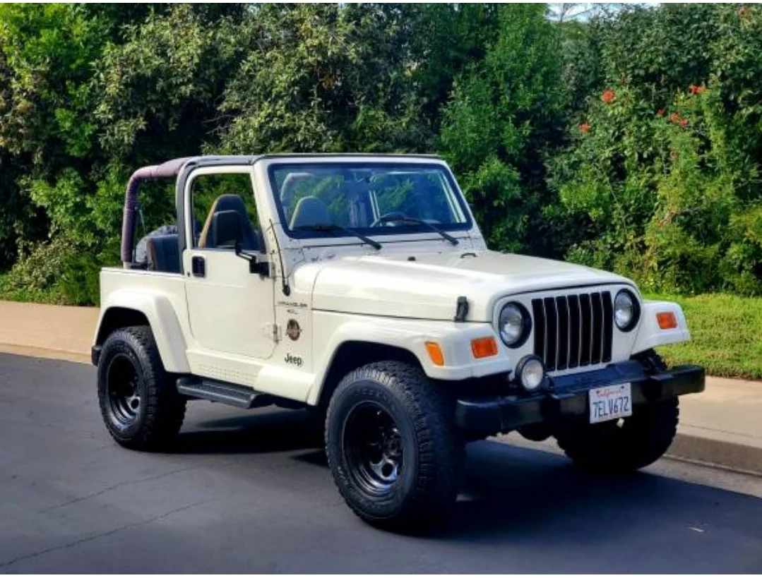

Ok boys i found another one. White 2001 Sahara with 150K on odo and this is the 4th owner I would be the 5th. Clean cosmetically but it has a "minor damage" on the carfax. He sent me pics of it it's just the stock front bumper bent a little which is in line with what the carfax says. It's also an automatic I really wanted a manual but Im reading good things about the 3 speed on this site. Brand new soft top. Full metal doors, and a bluetooth stereo. He's asking $11,900 and it's about 3 hours away I asked for some pics of the undercarriage but baring any major problems I'll be on the road momentarily. Anything else you pros can think of? I'm also hoping that the problematic head 0331 or whatever would've already been taken care of by 150K miles IF it were to be problematic. Carfax shows several transmission services so hopefully tranny is in good shape
