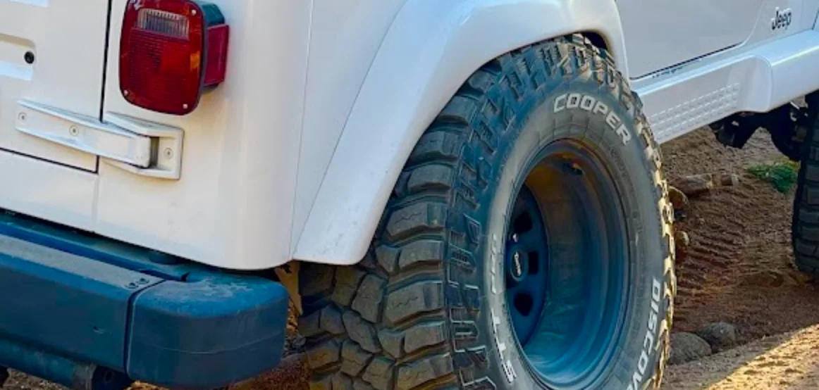

For reference, this was my first outing in my 4" TJ at full compression with 33" tires.
My bumpstops were set ONLY with concerns to the factory 'metal' fenders.
Flares are irrelevant to me.
Use your imagination and you'll understand how 35"s would act in this scenario.

Either way, that is not the pressing issue with factory flare clearance as long as bump-stops are set correctly in relevancy to the Fender (NOT the flare)
Clearance issues with factory/oem fender flares are not at the top of the fender, it's more-so an issue along the back edge.
Note in the photo the rear of the fender folding over on itself.
Ultimately this led to a lot of cracking/wear to the fender itself as well as shredding the paint off those rear fenders.
(which is the complete opposite of what it sounds like OP is wanting to happen)
Now look at the photo again, and imagine that, with the extra 2" of tire that OP has versus my 33's in the photo.
