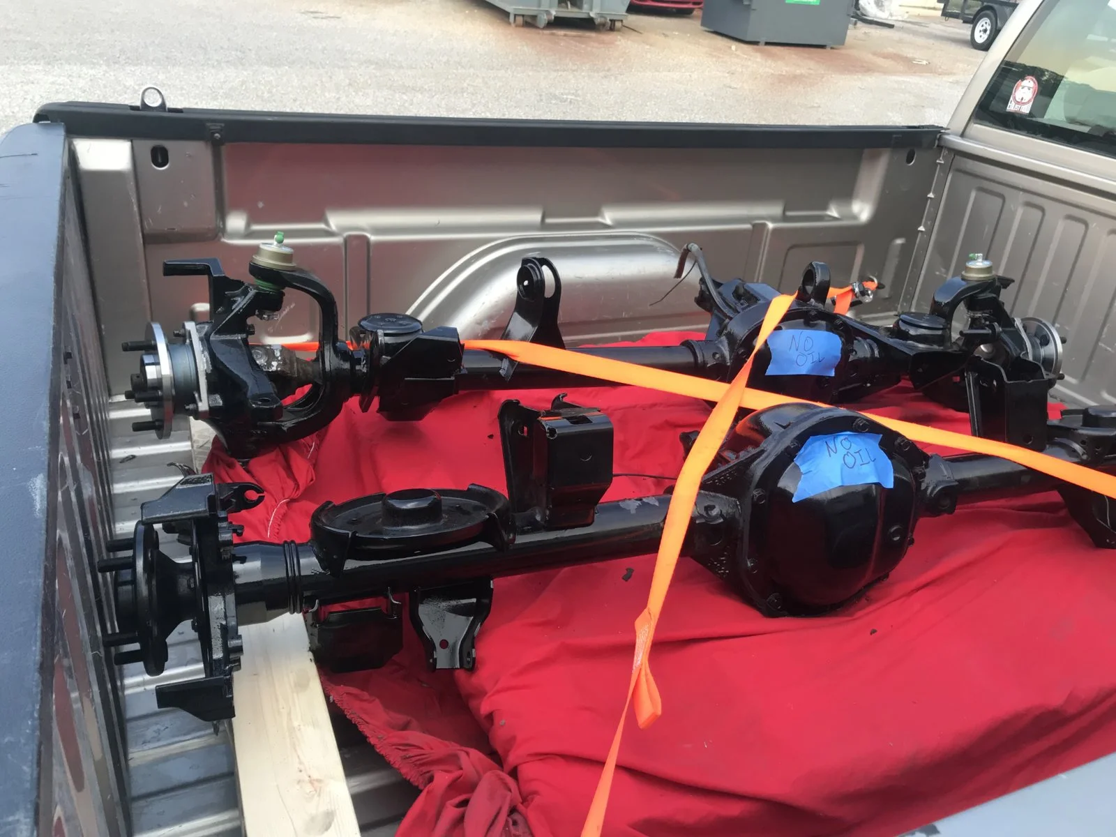

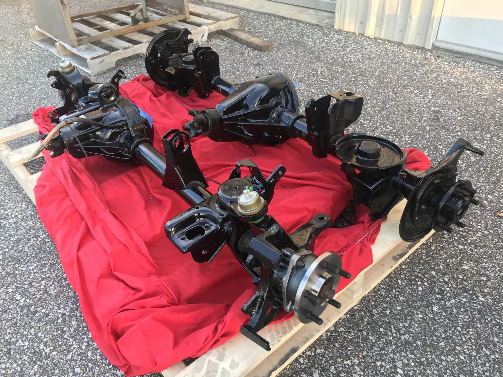

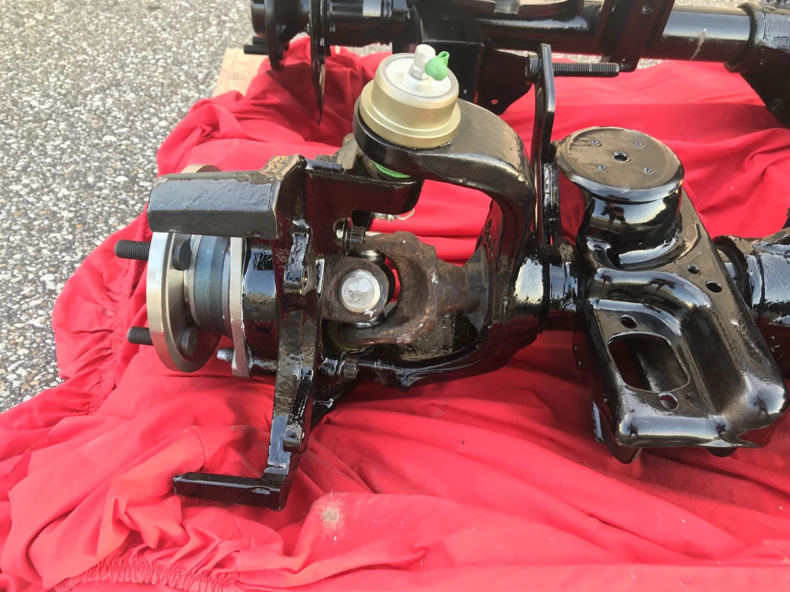

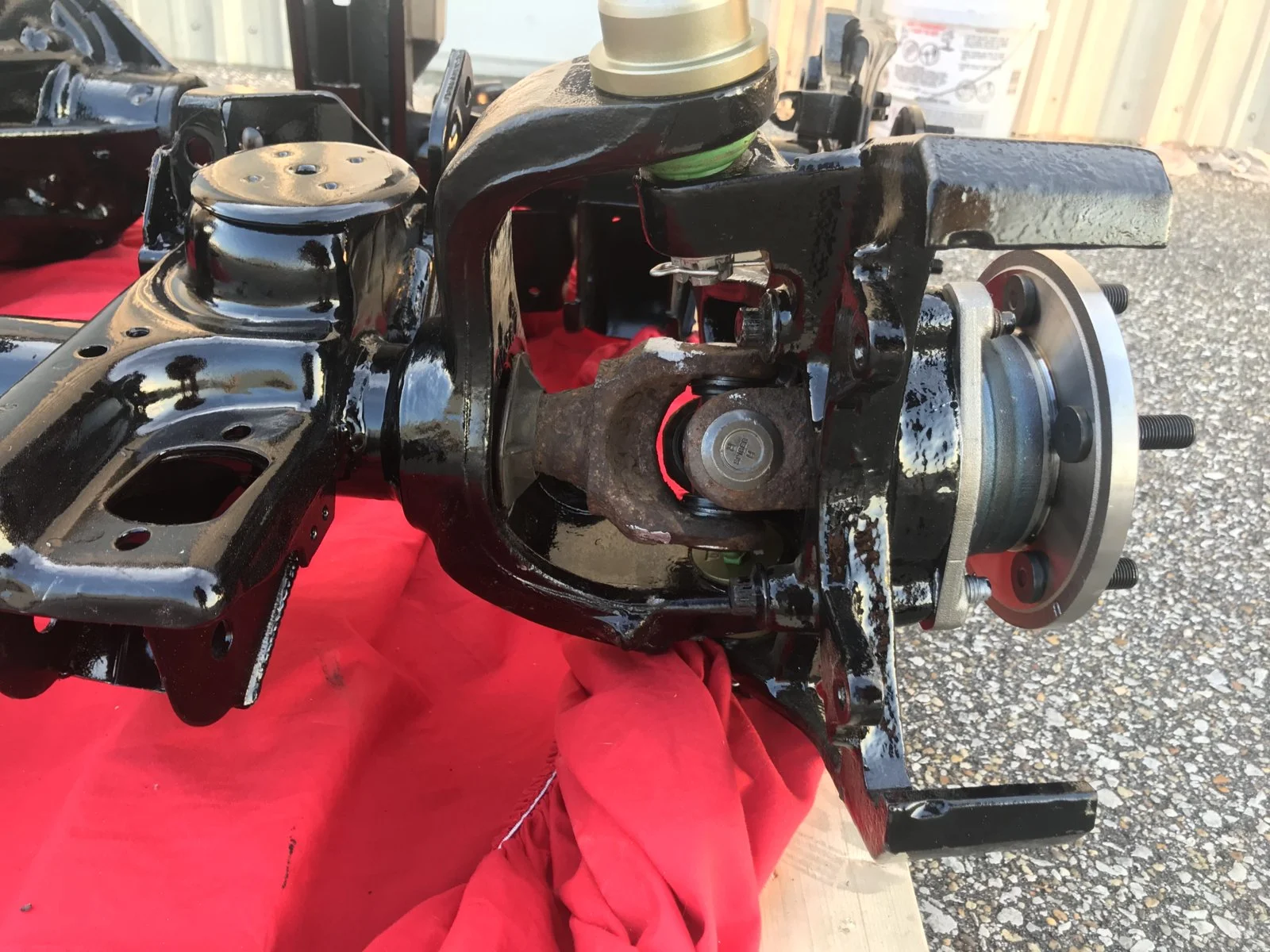

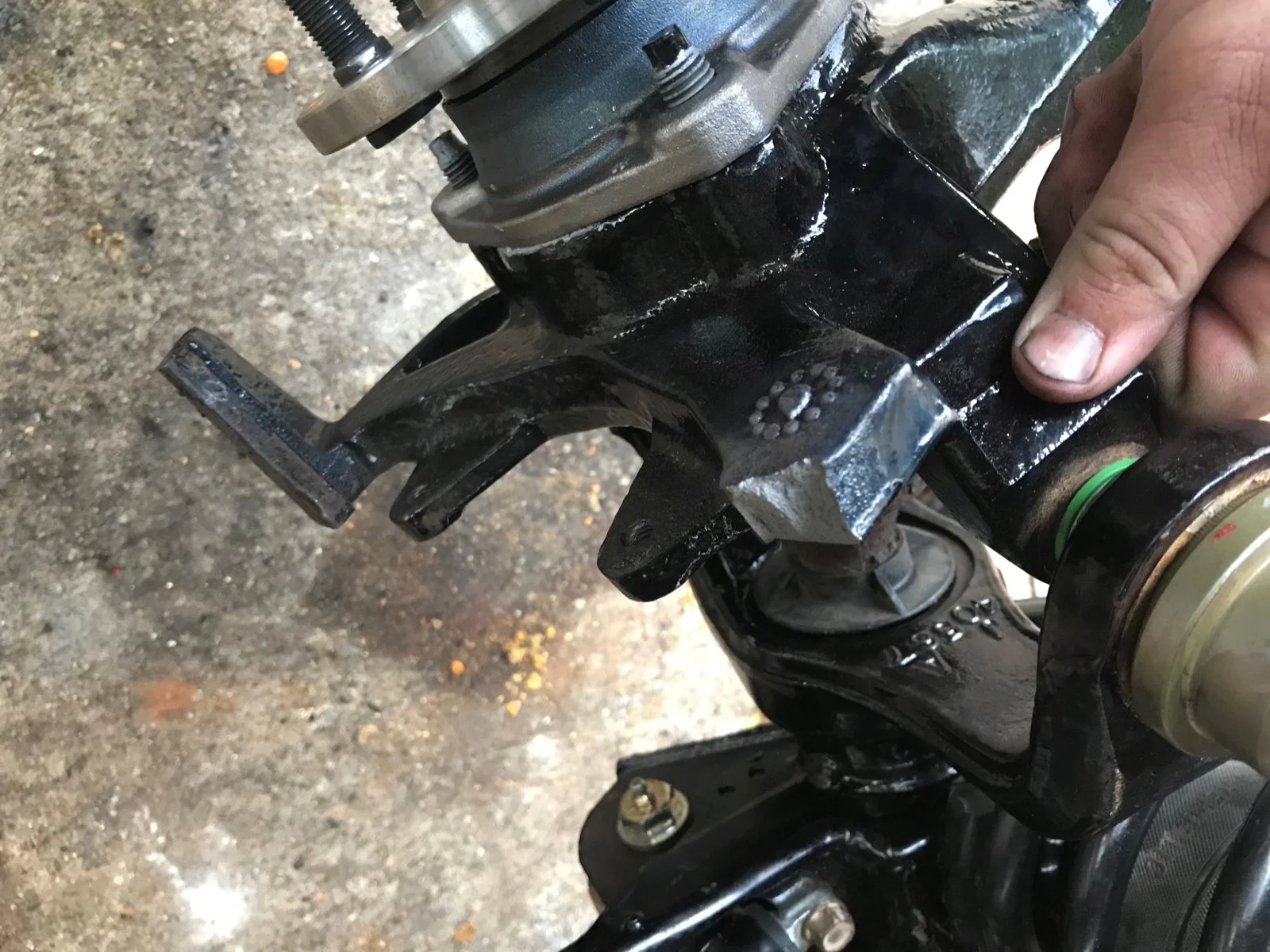

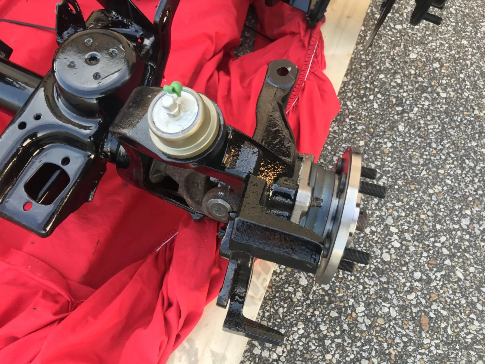

    Another update! Got the axles back from Motobilt today!! They look great, did get scrapped up a bit getting worked on but nothing I can’t touch up. The Spicer ball joints I ordered for the HP30 would not fit and they ended up installing their premium house brand ball joints. The spicer joints spun freely in the mount, never seen anything like it haha. Here are some photos, I start tomorrow!

    They look great! I'd recommend putting a couple of spots of weld then grind smooth where the brake pads sit. That'll let them slide the way they are supposed to.

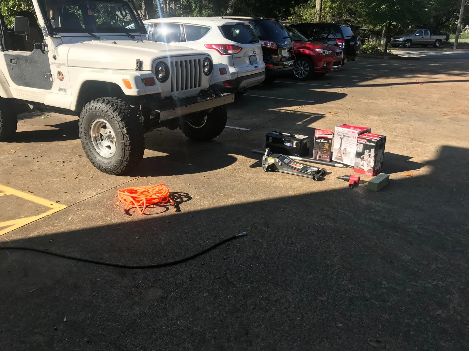

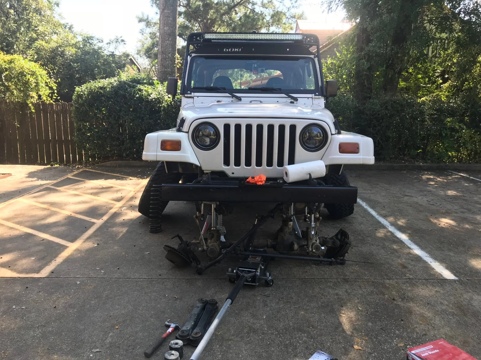

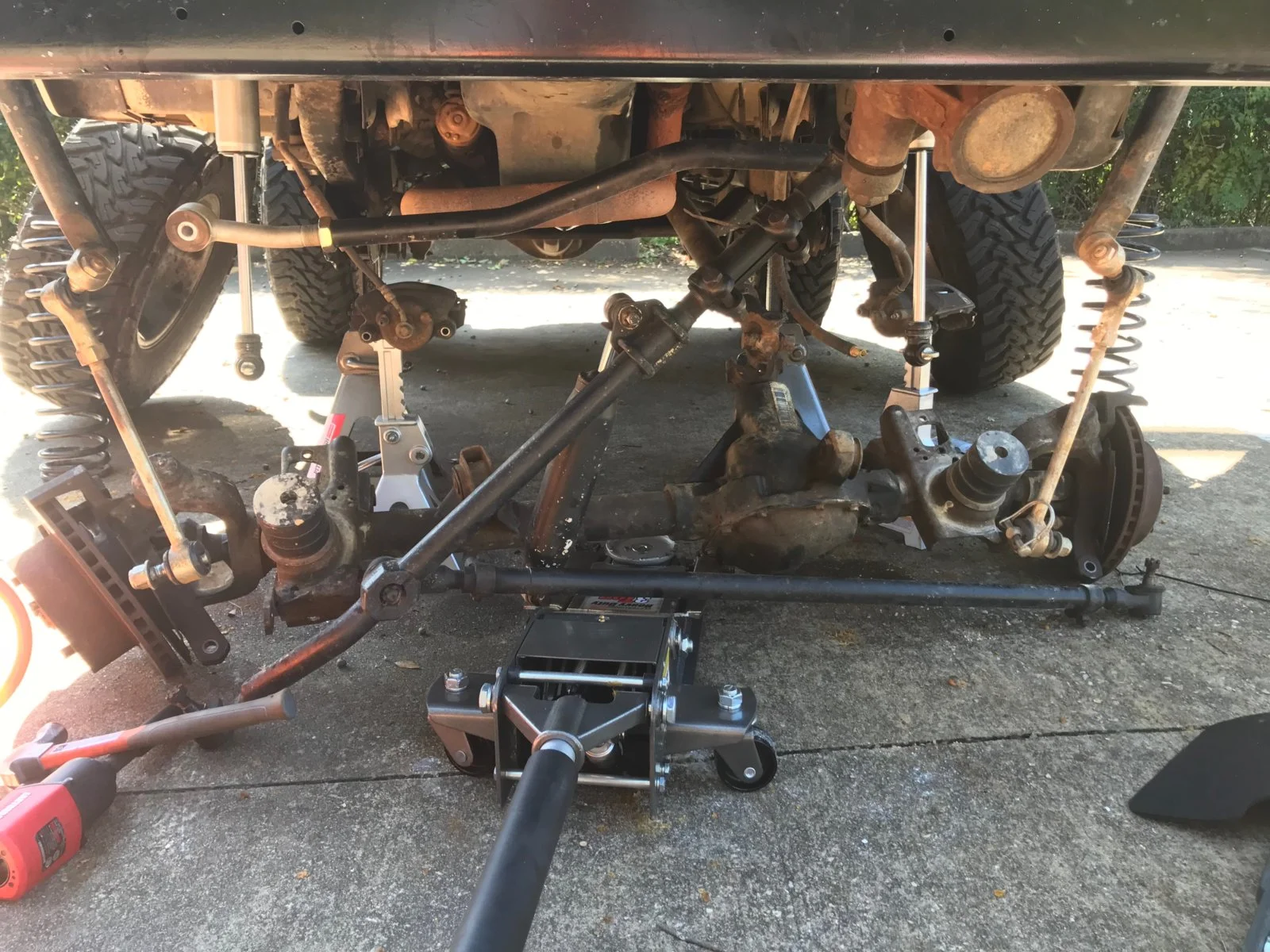

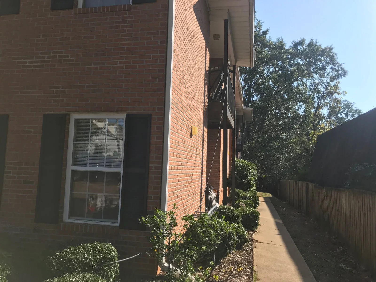

    Update! I got quite a bit done today, I failed to take photos though because it got dark very quick.
    My neighbors love my 100ft air line to my patio:

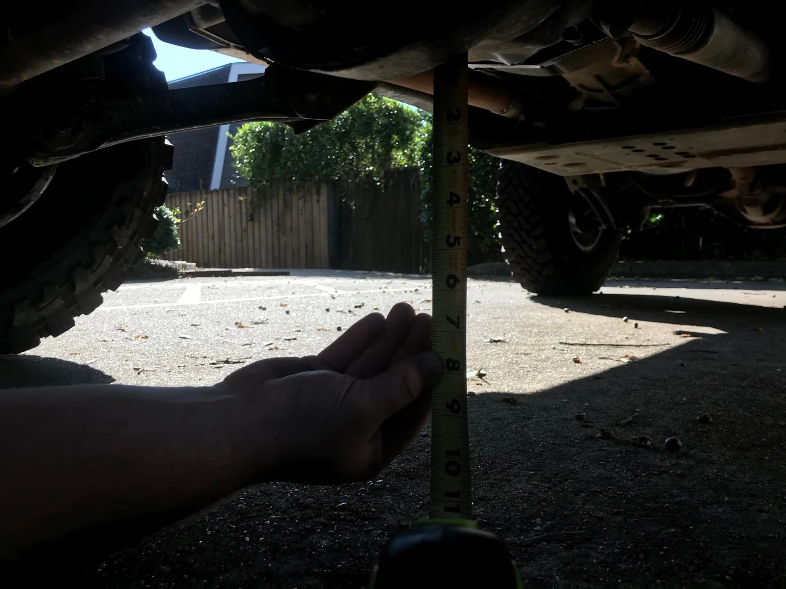

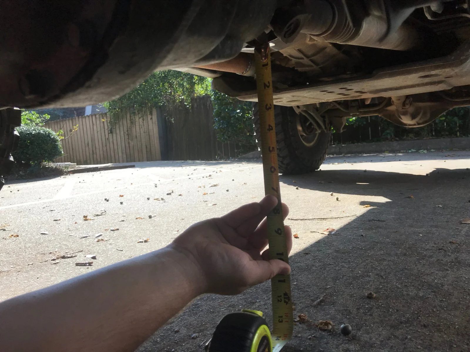

    I took two photos of various points of the Dana 30 housing to depict the housing distance from the ground for the LP to HP switch. Below are the LP measured at the back of the Dana 30 housing and the driveshaft straps:

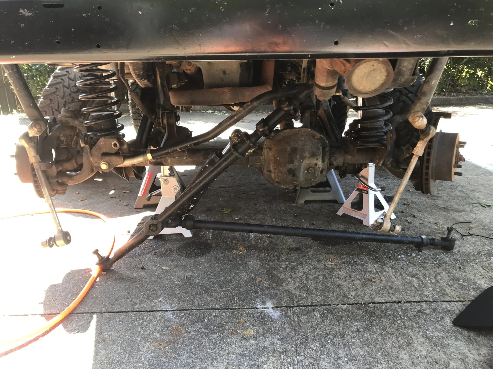

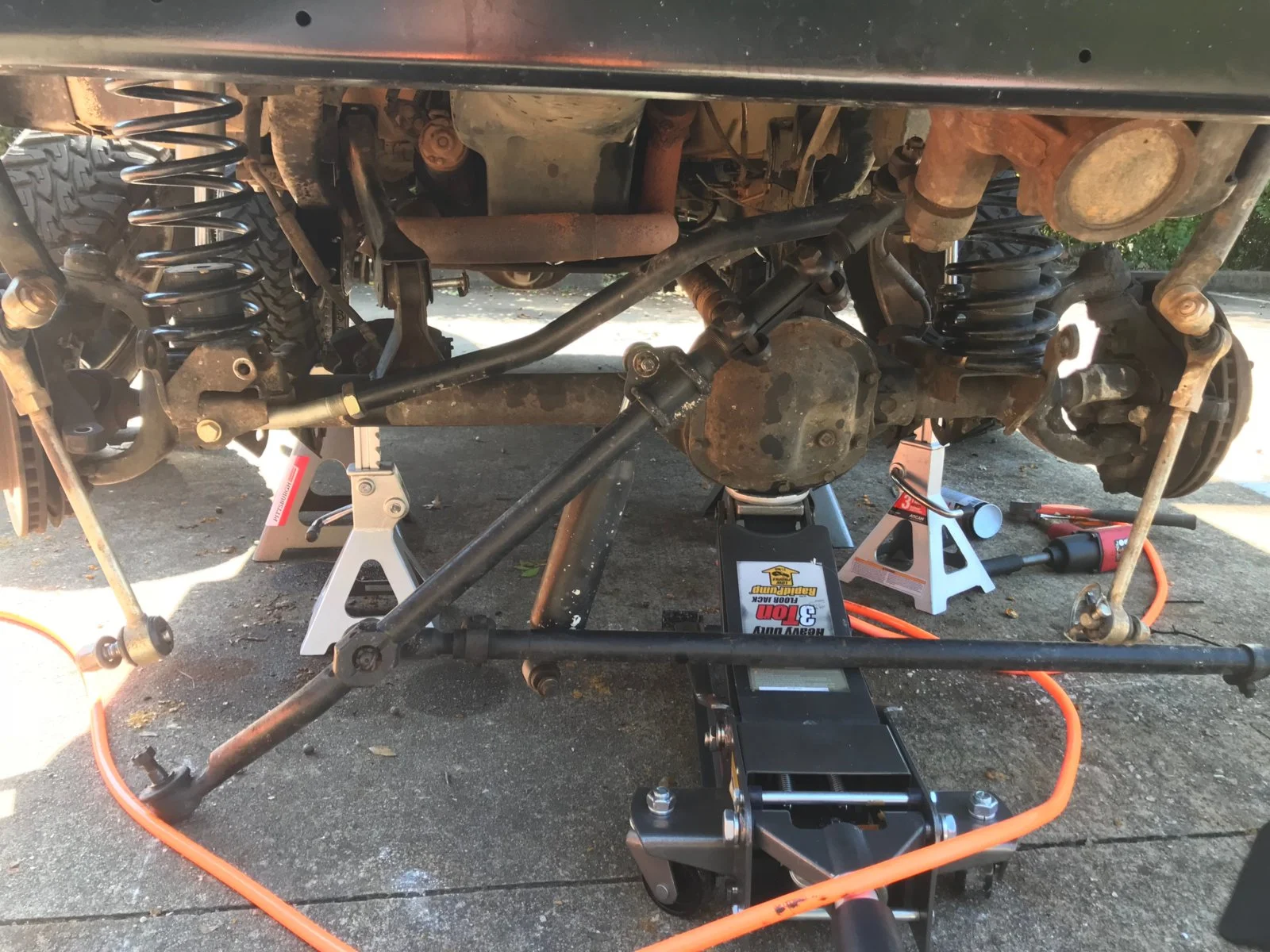

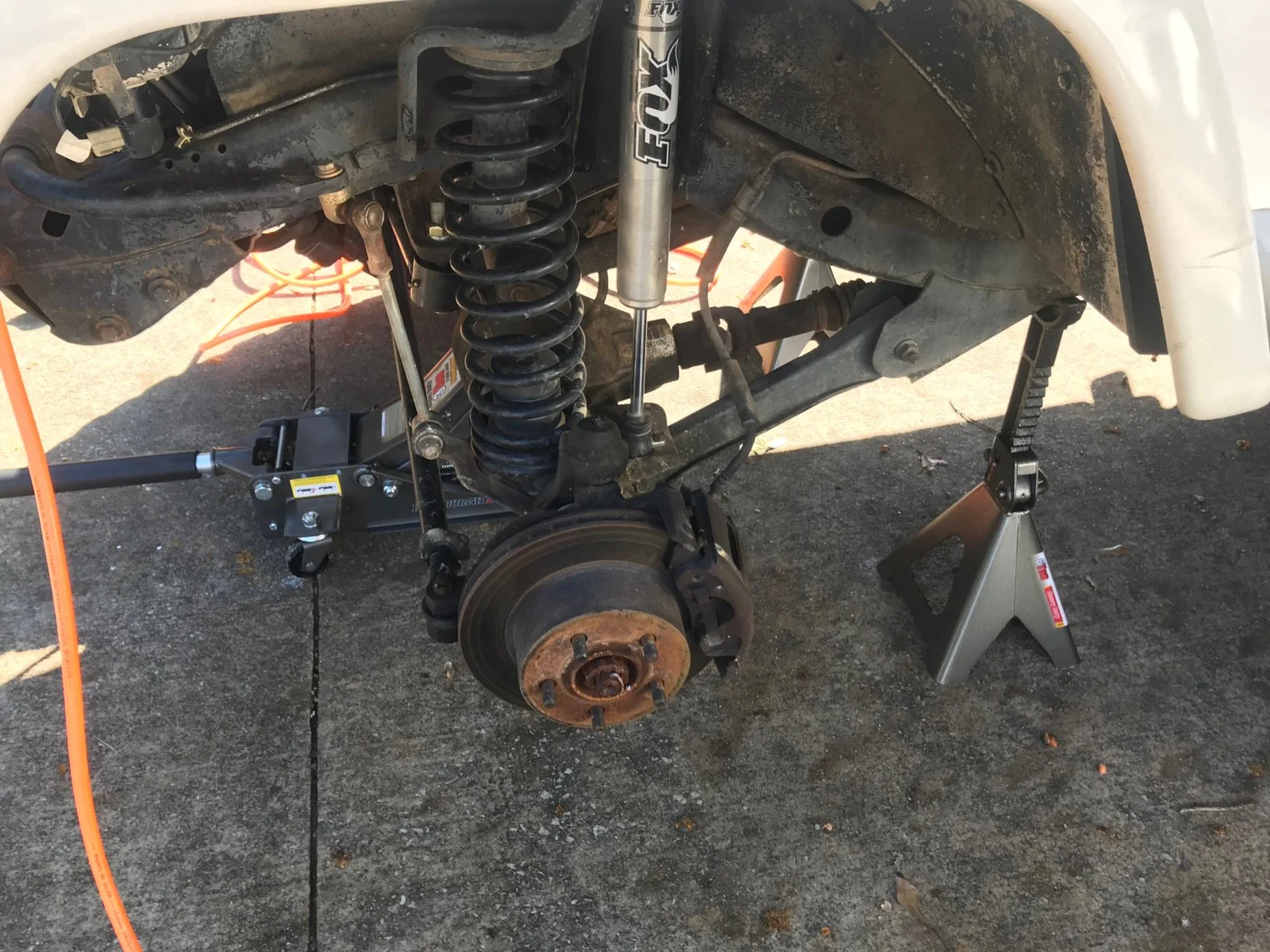

    Started to tear everything down:

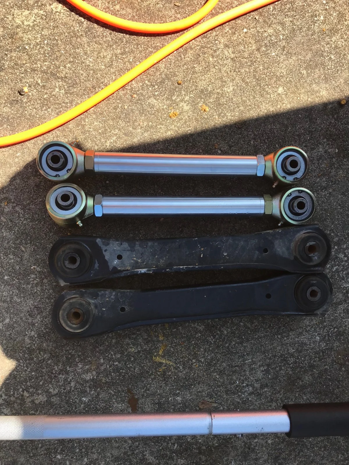

    Most basic photo ever comparing the LCA's, I also pressed on the UCA Bushings from Moog:

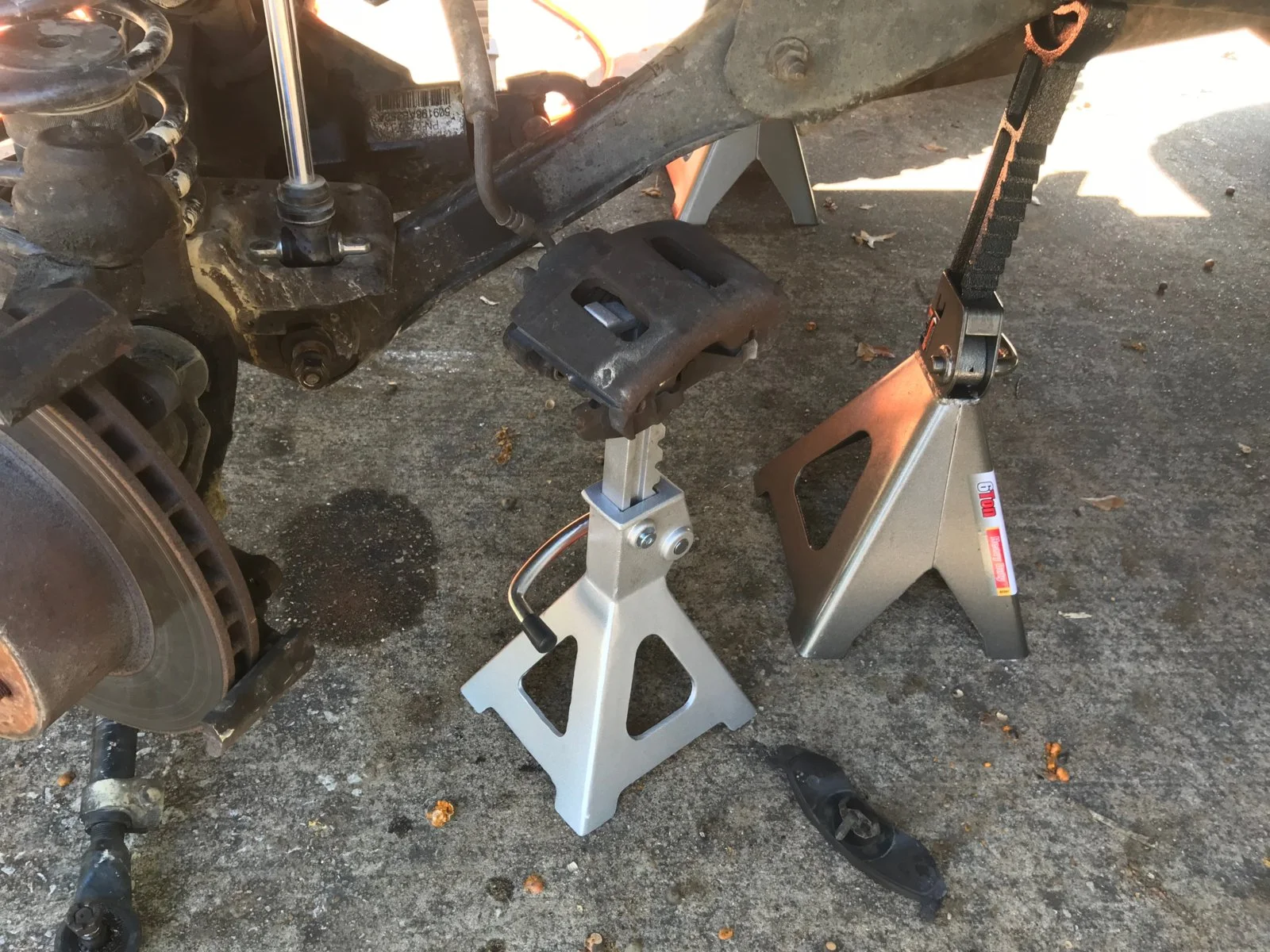

    I ended up getting the lower control arms mounted, but sadly I will have to remove them as I didn't understand the shaft needed to be center on them. There are 3 more threads on one side which is a no go apparently. I got the springs/bumpstops back on& started the brake install. I can't get the caliper mounted but I think its user error working in the dead of the night. As always more to come!

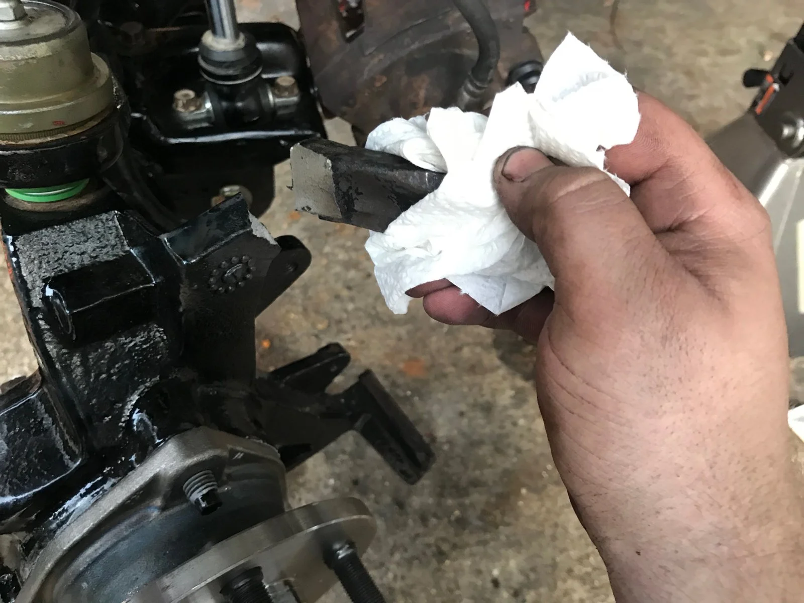

    Um today did not go very well. I spent the better half of the day trying to figure out why the brake caliper wouldn't seat into the rotor:
    After talking to BMB on the phone and testing a couple things the ear of the brake pad retainer was slightly bent causing the pad to not go in. Using 5 minutes of propane heat until the joint was ungodly hot & then using a 3lb hammer ended like this:
    So I had to make a bunch of phone calls to find someone with a ball joint tool (God dang it why don't I have one of these yet). Have a peer bringing me one tomorrow to press out the old ball joints on my old Dana 30 and remove the Steering Knuckle and unpress my current new ball joints from the HP30 and repress them into the old steering knuckle going on the new hp30. Lots of work ahead, not a setback I was even remotely expecting. Nor did I expect the axle to be bent there! At least the housing and tubes are straight. More to come as always.
