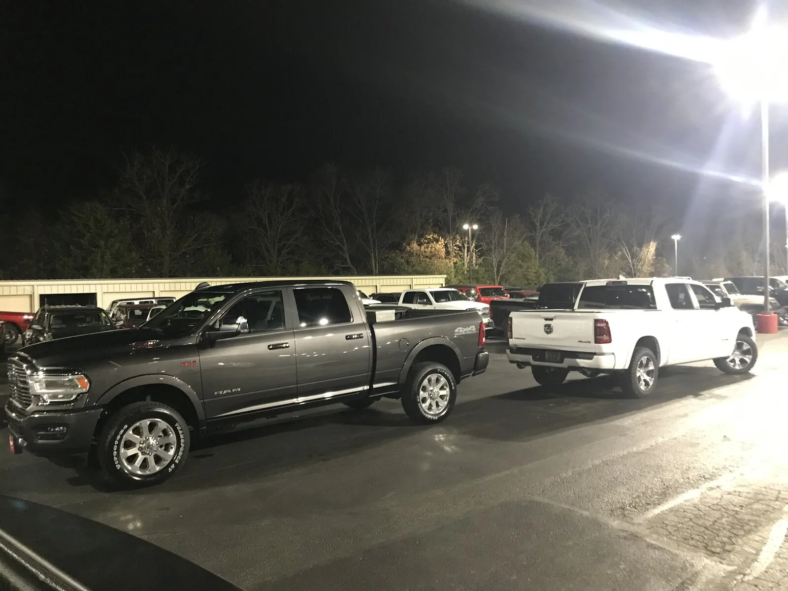

The rest of the story, I decided to upgrade and arranged a trade deal over the phone with the same Ram dealers I purchased my 2019 Ram 1500 from about a year and a half ago. We set out around 3:00pm Friday heading towards St Louis, stopping in Sullivan Missouri to trade out the truck at Laura CDJR. I decided on a 2020 Ram 2500 with a gas engine. I know a lot of you like the big diesel engine, but all things considered the 6.4 Hemi is a good fit for us. My new truck is a 2020 Ram 2500 Laramie trim level with Off Road package, 4.10 gears and body colored bumpers (I do not like chrome). It has a lot of the same features as my last truck, but I did skip on the $2k 12" touch screen, and sunroof this time. My cargo cap. is over 3K and towing is over 17k.
Here are both the trucks as we are swapping things over. I did have to redrill my tool box to get the "J" hooks in. Seems the bed is a little wider on the 2500. I can also tell the bed metal is thicker gauge. It did not bend when tightening down the toolbox like it did in the 1500. My wife says it needs some step bars, I am 6'3" and it takes a hop to get my ass in the seat, she is 5'4" and has to use the grab handle to climb in. I told her powered steps are $1400, and would make an excellent Christmas present. She was not amused and found a set of fixed step bars on Amazon for $300 she likes. We will see who wins.

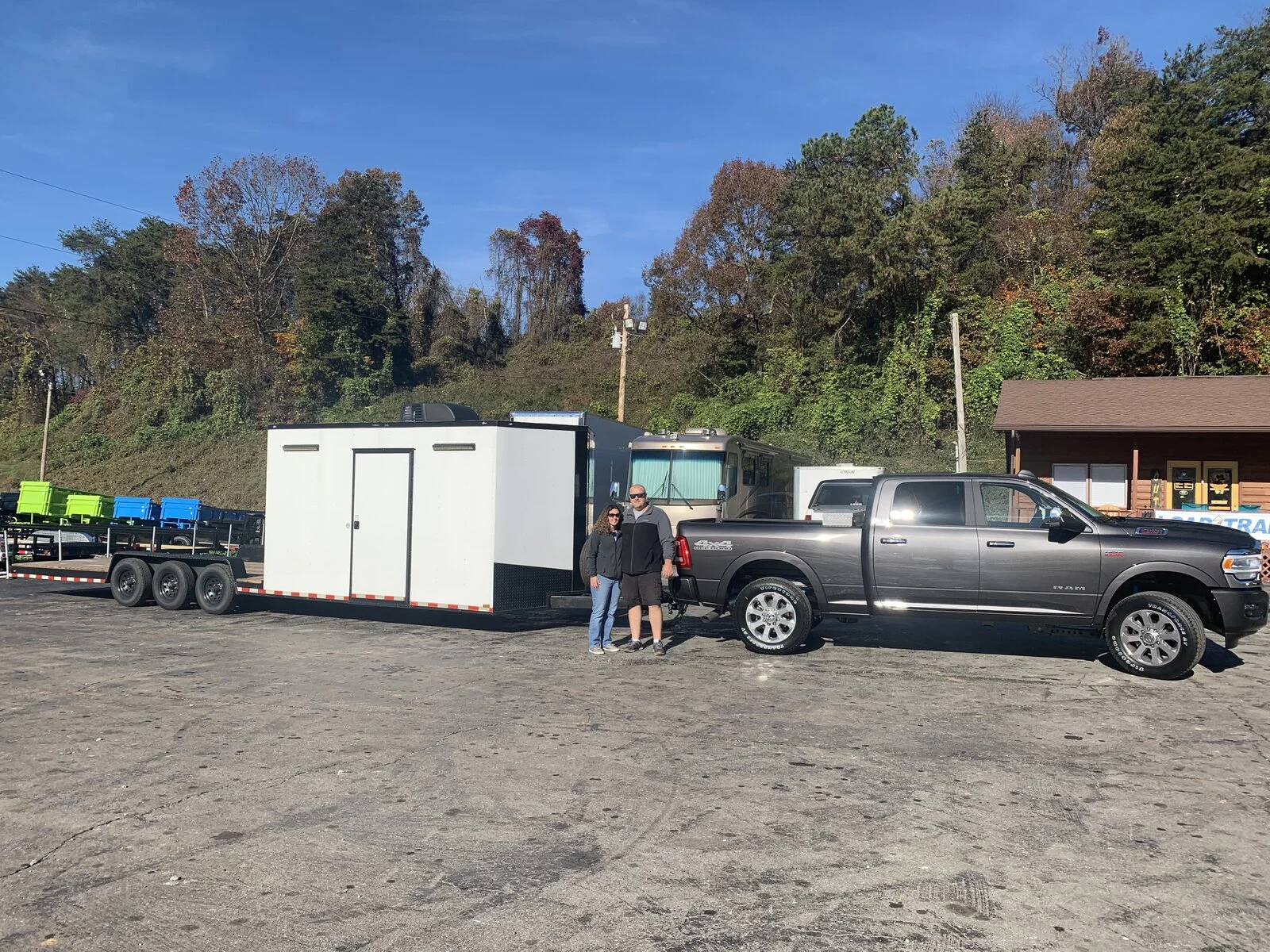

Here we are hooked up and ready to roll nearly 600 miles home.
We departed Loudon around 10 am heading back west for home. We are limited to truck stops for the most part with this trailer due to length. It's 18' of flat deck, and the cargo box is 12' along the flat part of the sidewall. With the "V" nose and tongue its nearly 37' overall. I set up and tested the electric brakes and settled on a gain setting of 4.5. It pulls great but my wife complained about the jarring ride. I checked the TPMS on the dash screen and found all 4 tires on the truck are inflated to 100 psi. We dropped them to the recommended 65 front 70 rear and the ride improved a lot. When I get the Jeep on board and the WD hitch set up it will likely improve even more. Hwy 40 and 24 in TN are pretty beat up. Lots of trucking traffic and in need of repair.

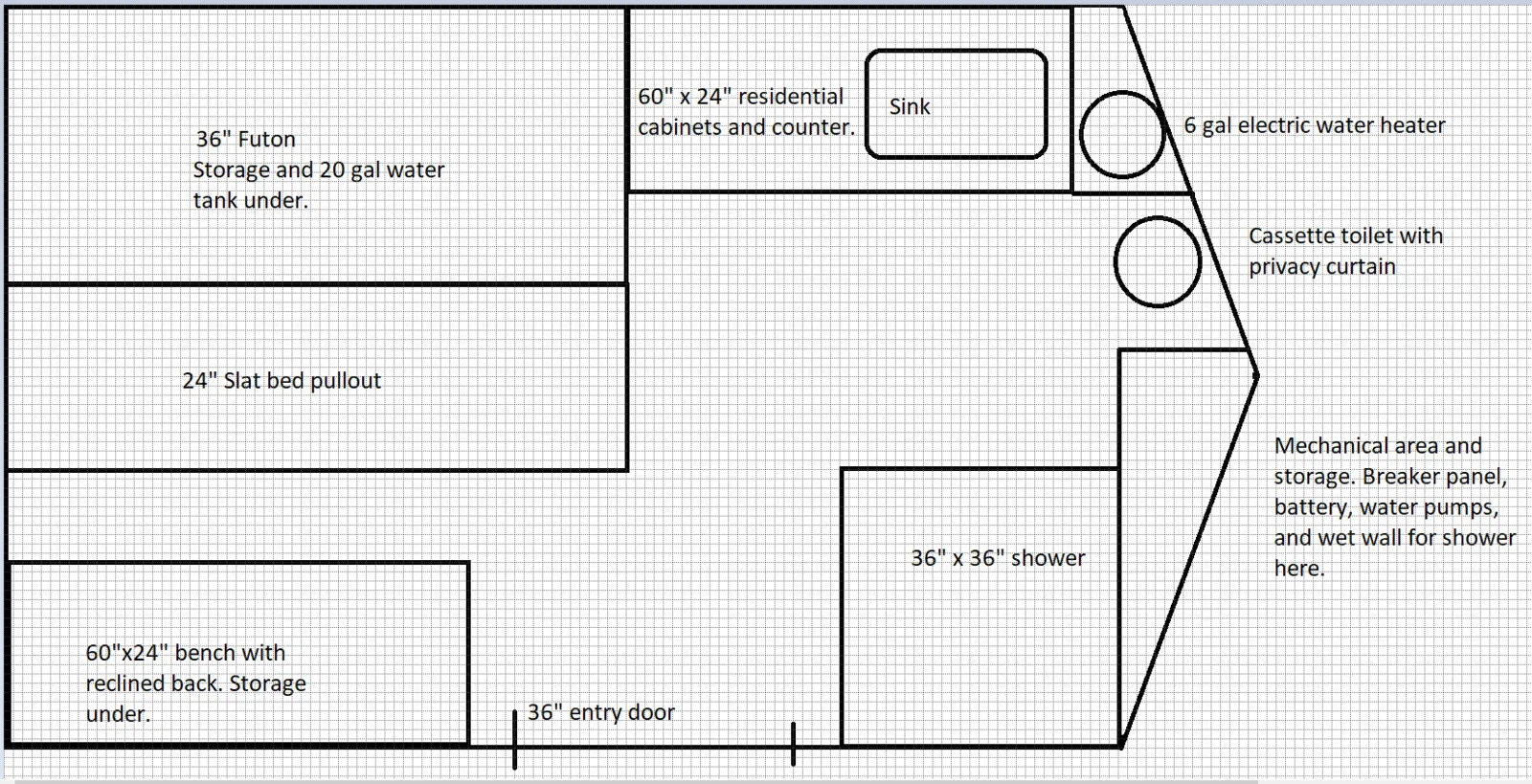

Those of you that draft, don't laugh. I lack some skill here. This is to "scale" just using grid lines on MS Paint. Just a concept at this point. We have 8'x12' plus the v nose to work with. We cannot undermount tanks due to ground clearance so will use a portable grey tank with the water tank mounted beneath the bed.
Let me walk you through my idea here starting top left and working clockwise.
36" futon slat bed will pull out to make a 60"x80" residential queen. Storage underneath for water tanks and mechanical. With the bed retracted we should have plenty of room to move around. Bed base will be 18" high with a 4-6" mattress on top.
We will have 5' of residential sized cabinets with a single basin sink, and one cabinet mounted overhead. The sink will be under the forward window. A bulkhead wall will separate the mechanical items and have shelves for storage above the 6 gal electric water heater.
The cassette toilet will have a tracked privacy curtain hanging from the ceiling (think hospital curtain). I think a door would make the space too small and a curtain is an easy solution.
Next is the mechanical area, housing the breaker panel, battery, water pump and accumulator, and wet wall access for the shower plumbing.
Next a 36" x 36" shower pan. We will install fiberglass shower walls on wet wall side and the trailer wall side. The other two sides will be open, and another hanging curtain will be used to enclose the shower when in use.
Left of the entry door, a 60" x 24" bench with a reclined back (18" -20" of seat bottom with 4" - 6" to build the angled back) storage will be built into the base. Custom cushions will be made.
We are also going to pull out the rubber floor and add either loose lay vinyl, or a click together plank floor.
Thoughts?

Why not put a 1x1 rail on the edge of the 60x24 bench and have the slat pullout that could then rest on that rail so you'd have a wider bed? Just a thought.

Its shorter than the bed by 20" and the mattress will be considerably thicker than the bench cushions. I think the queen will be plenty big. I could make the bench a pull out and have another small bed, but I really don't want company in the camper aside from the wife. Trying to find the balance between adding all the amenities my wife wants, and saving some floor space. Might drop the shower size to 30x30.
Next step is to use painters tape and tape out all the outlines in the trailer to see how it flows in real life 2D. If the wife say "go" I start buying parts and lumber. All the furniture will be built in 2x2 and trimmed out with beadboard and trim. My goal is to make it look clean and like a factory (or better) built camper. No redneck plywood bullshit at least where you can see it.

If it were me, I wouldn’t go smaller with the shower. 3‘x3’ is small. I would switch the location of the sink/cabinets with the shower. It’s closer to the heater and keep the curtain on a track for elbow room.

I had it that way initially. I don’t want a window in the shower so I had to move the shower to the other side.
