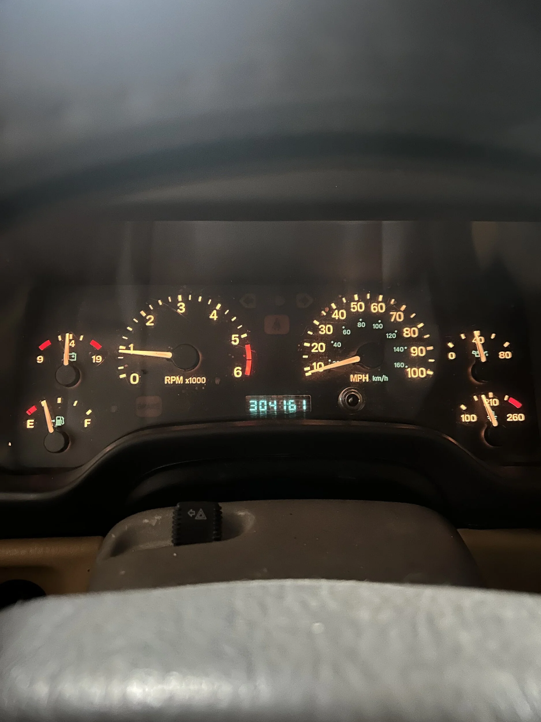

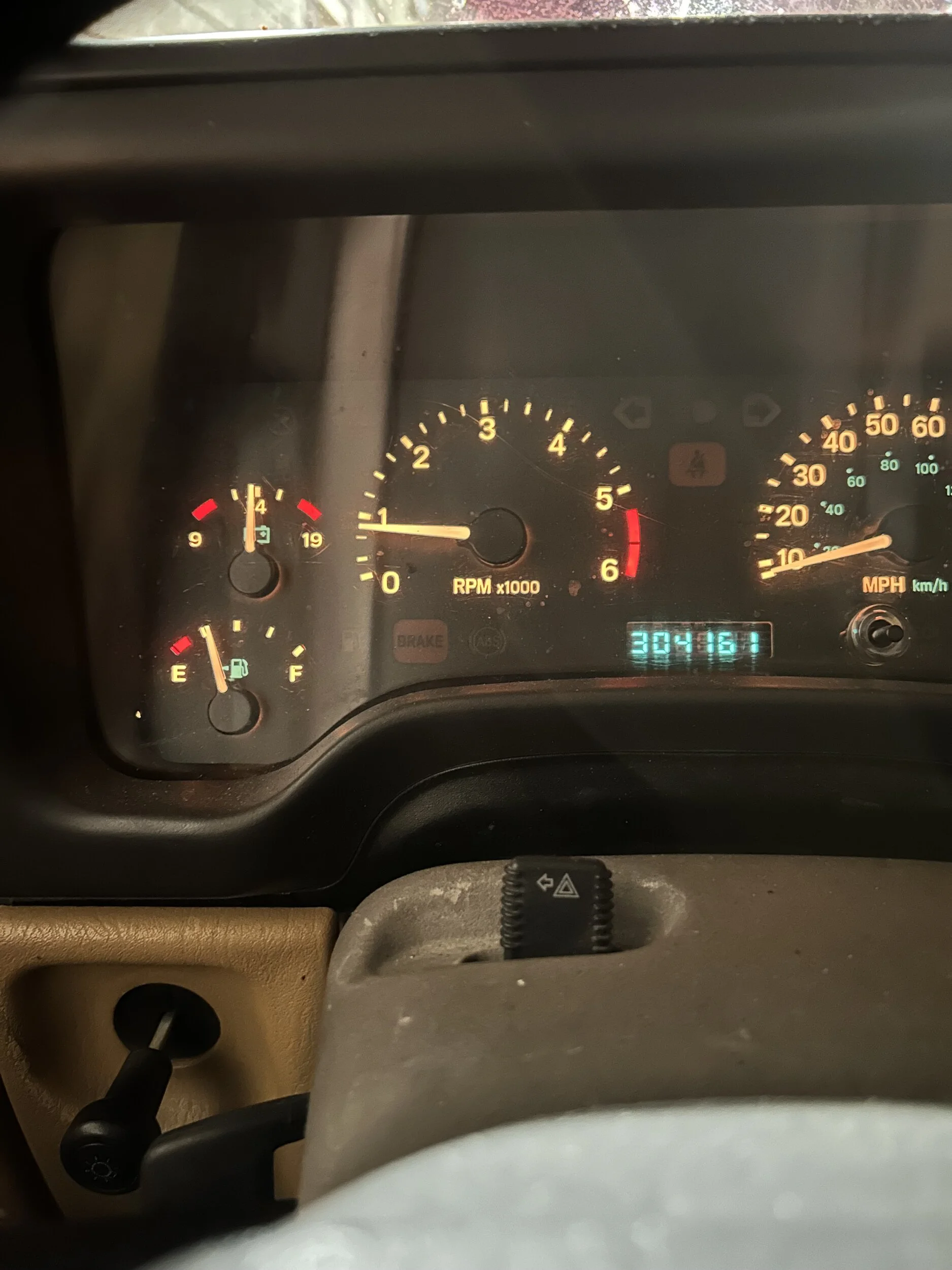

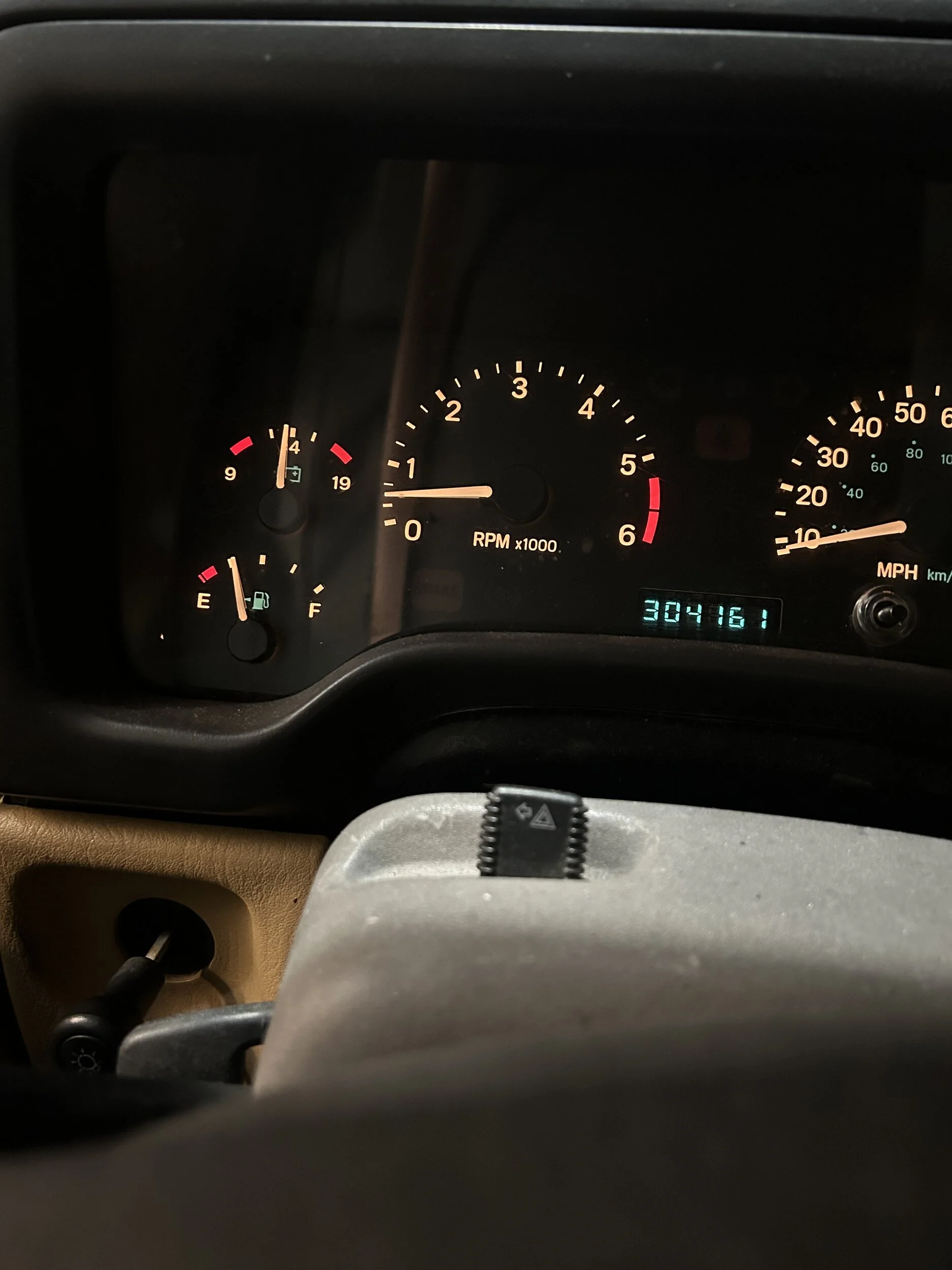

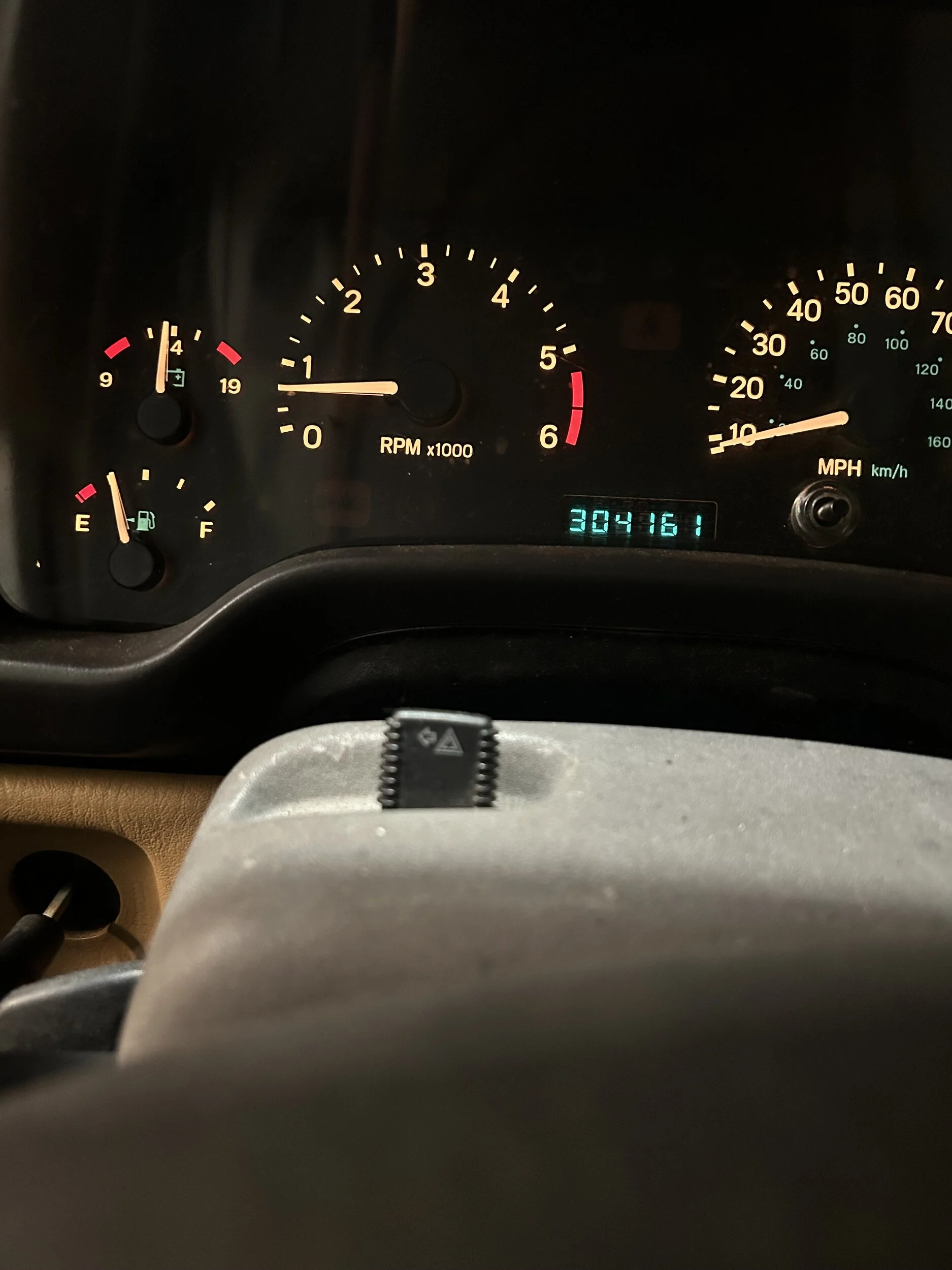

There’s some videos idk if that helps at all but those are all after startups individually I also revved it to keep it from dying in one video and one I’m holding steady not in gear but the rpm’s fluctuate
