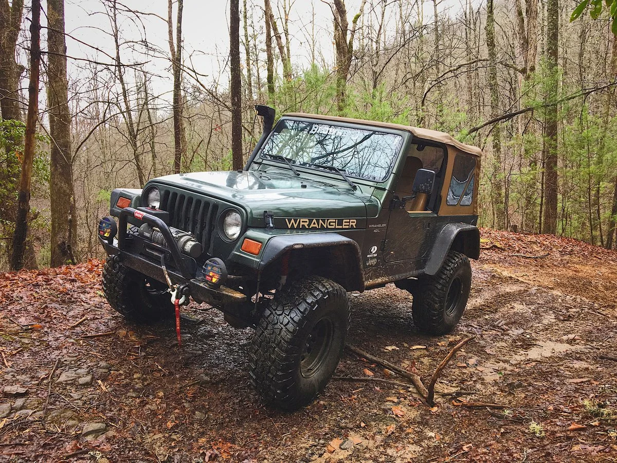

Nice looking TJ, and welcome! How did you tuck the soft top rear corners up like that and still keep tension on the top?
Thanks! I tuck the corners on top of the roll bar and then wrap them with a bungee ball. It does a pretty good job at keeping the rear bow from springing all over the place. I like the solid top to give me shade and still get the open air feeling of no windows. I need to get a couple more to keep the rear seat belts from flapping when I use them on the top.
I forgot to add my first mod that I did. Swapped out the 23 year old mirrors for some NOS export mirrors. The driver side has the same lens as the passenger side which is a wide angle. It's SUPER helpful when on the road.
It took a few drives to get used to, but once I did it was great. Those first few drive made me sick though... it was weird looking at a wide angle on the driver side.
Bungee balls are the best invention next to sliced bread! I have them on the seat belts to keep them quiet and wrap one around the rear corners to limit the flapping in the wind, but never thought to tuck them up like you did. I'll have to try that this summer.

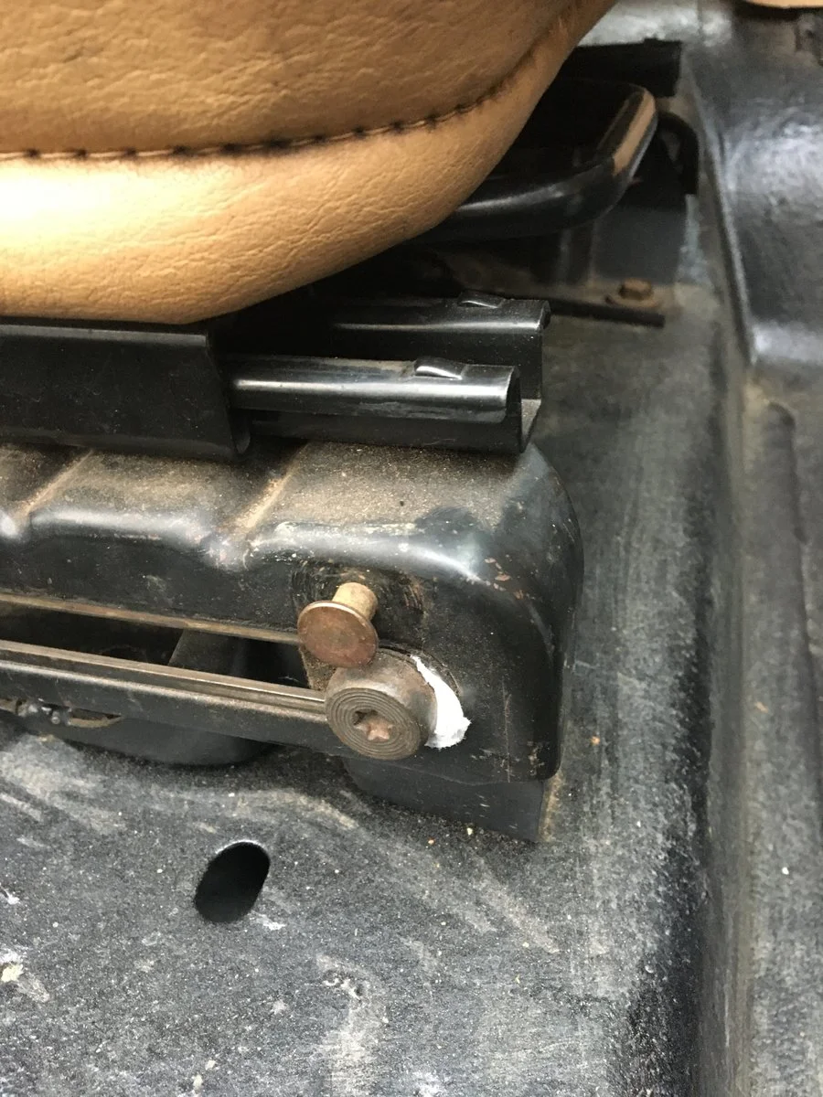

When I got home I checked over everything since and cleaned up some oil drips from the filter being removed. My passenger seat has been squeaking since I bought the Jeep (the fold and tumble bushings are nowhere to be found) and I figured I’d see if I could make it stop by stuffing some of the clean bits of paper towel into the track. Sure enough it worked! I hardly use that feature so it ought to stay rattle free for a little while.

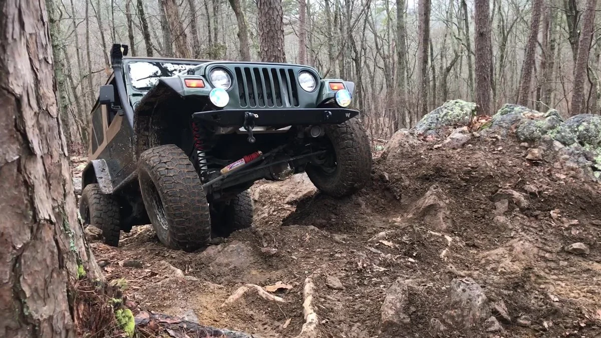

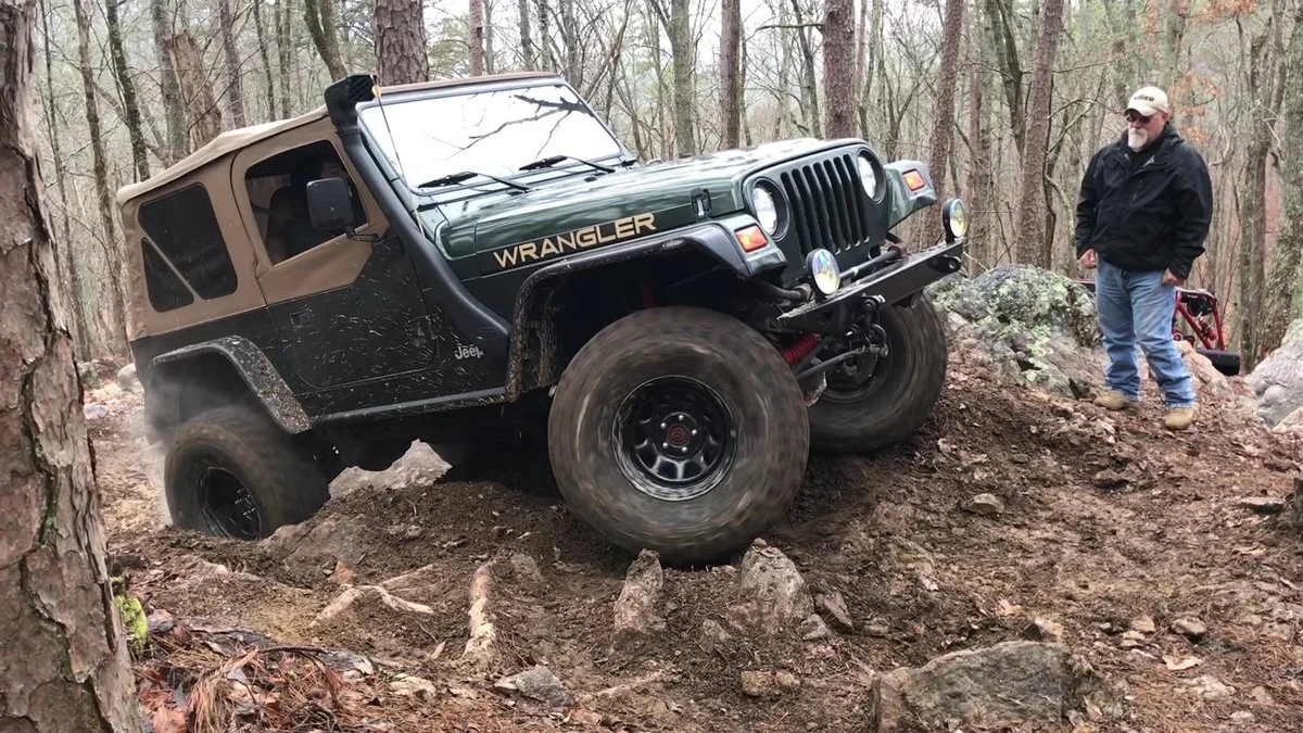

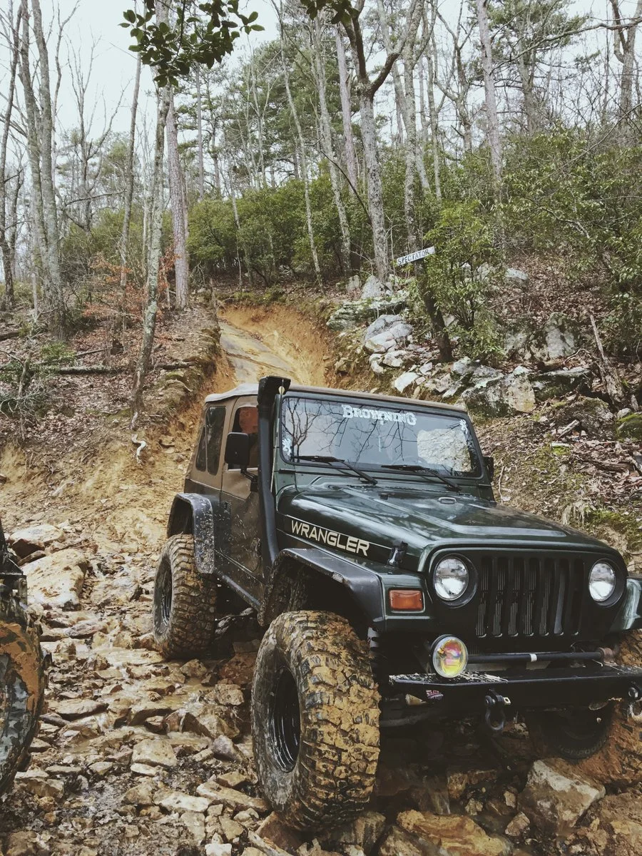

Took the Jeep out to Choccolocco Mountain on Saturday and wheeled with some new guys. I had the smallest tires and least built rig, but was still able to hang with them... well for the most part. I had to get winched out twice throughout the day. The first time I just didn't have the clearance to get over a ledge, the second time I took a bad line and wedged myself in a spot where all four tires were trying to climb some slick rocks.
Overall, I was super impressed with how the Jeep performed and wouldn't hesitate to go again. It may be time to upgrade the steering components though, they're looking a bit rough after taking a hit on the ledge I couldn't get over.
I'm cleaning her up tonight and then gonna start going through and searching for any actual damage tomorrow.

Right before I took the pic at the bottom of the slick muddy hill, I folded the mirror in on the wall and was cursing myself for getting rid of them. It wound up only having some small scratches on the housing so it was all good.

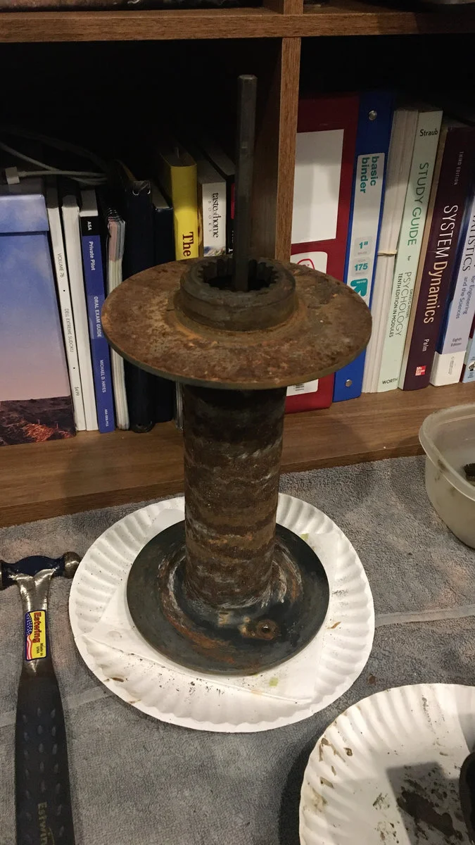

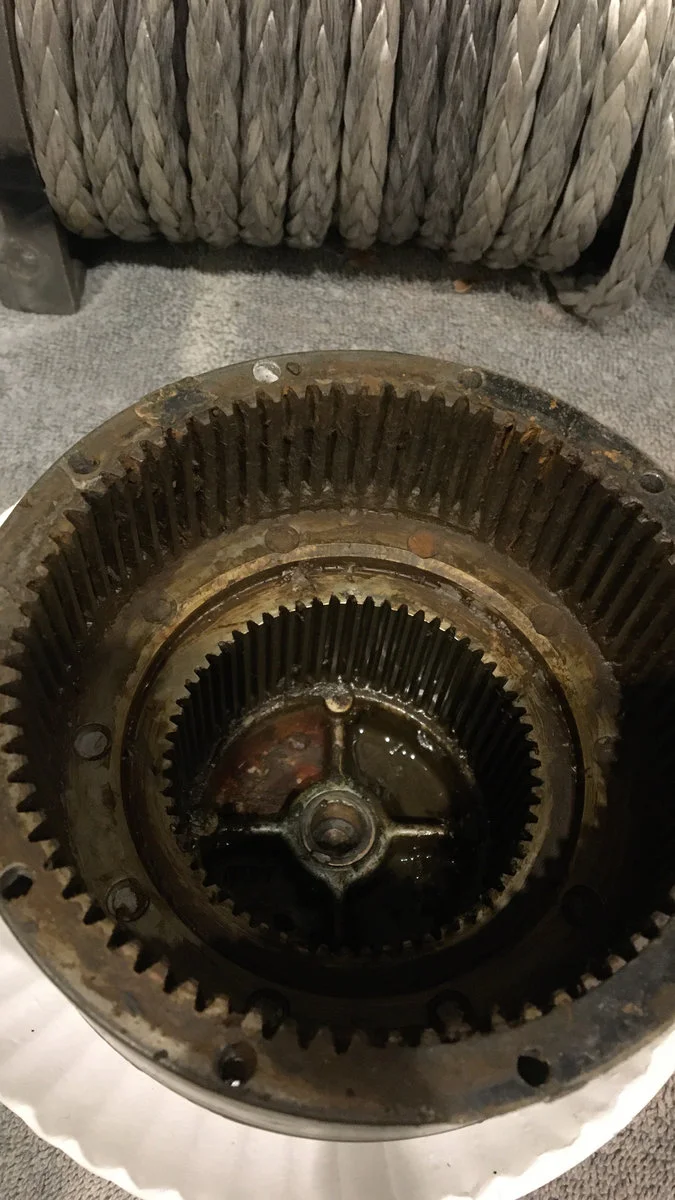

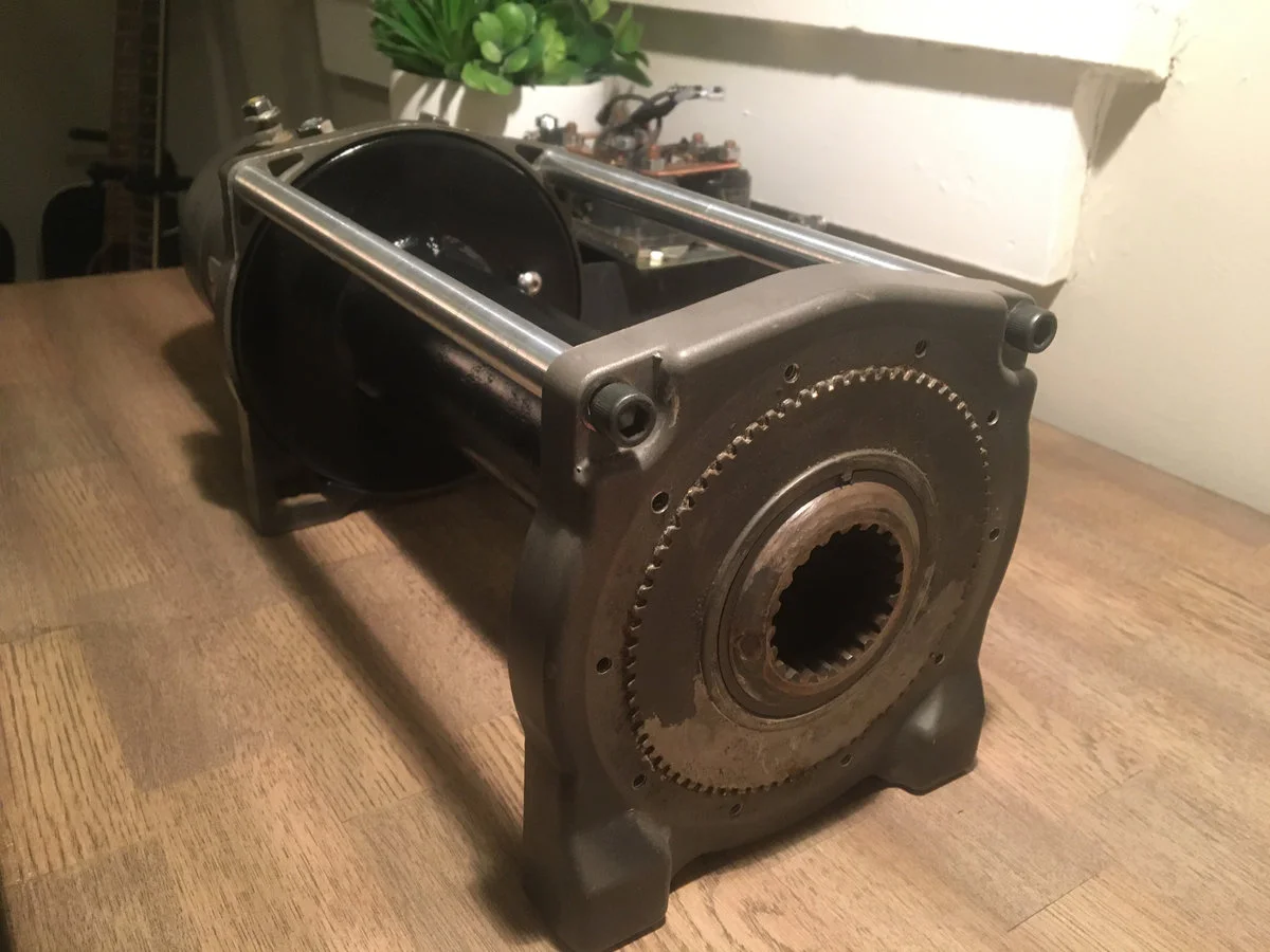

Finally pulled the trigger on the last part for the winch rebuild. The sliding ring gear had seized to the housing and the clutch lever was about halfway broken from me trying to use brute force to free it all up. Also ordered a replacement lower shift boot since mine is ripped all the way around. Think I'm gonna try and find a leather upper boot to install once the lower gets swapped out.

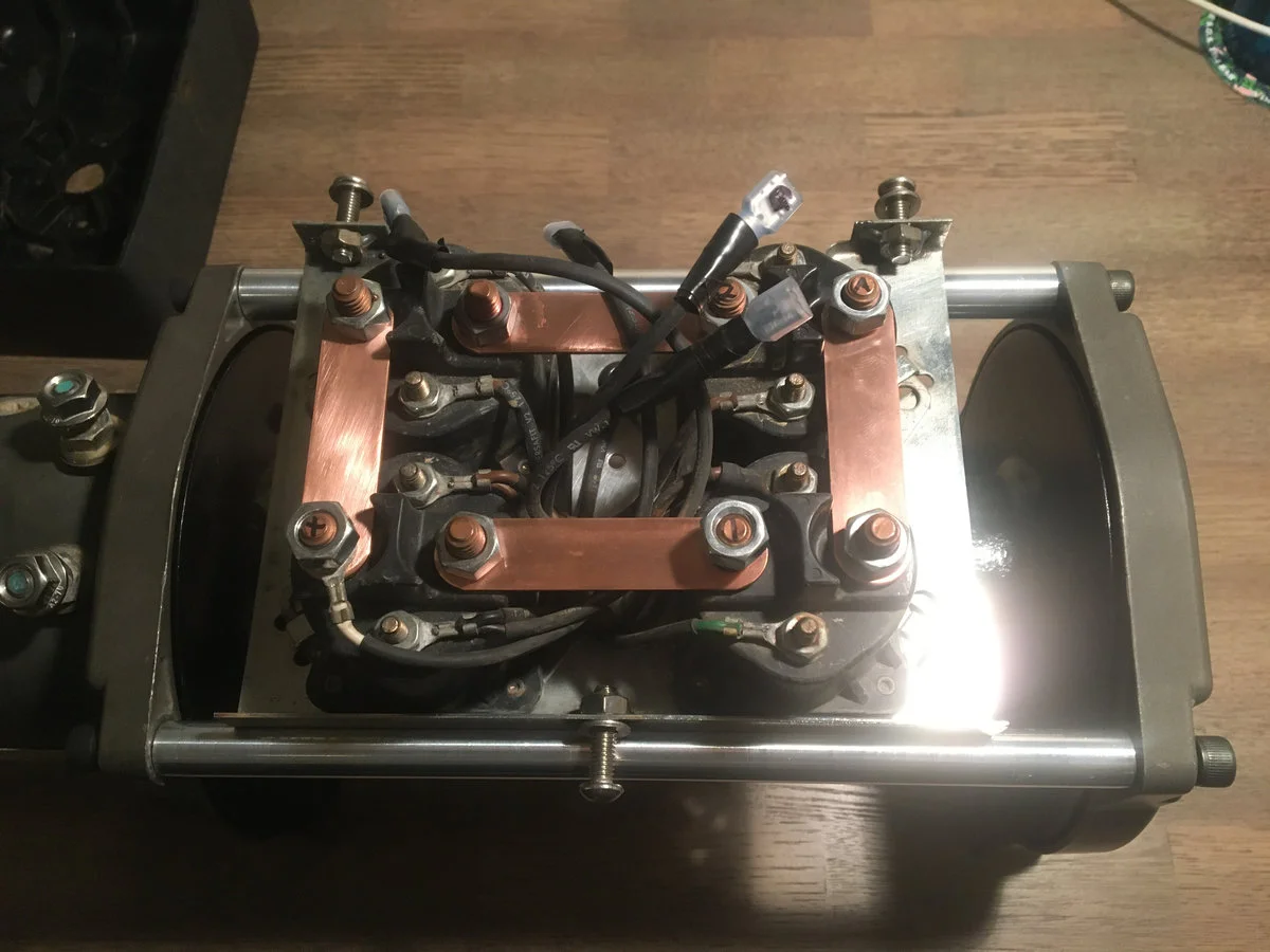

All I have left to do on the rebuild is paint the housings and clean up some bad wiring done by the PO in the control pack. Thinking about splicing in an in-cab control switch while I'm at it. Then pack it full of some AeroShell 64 grease and button it up.

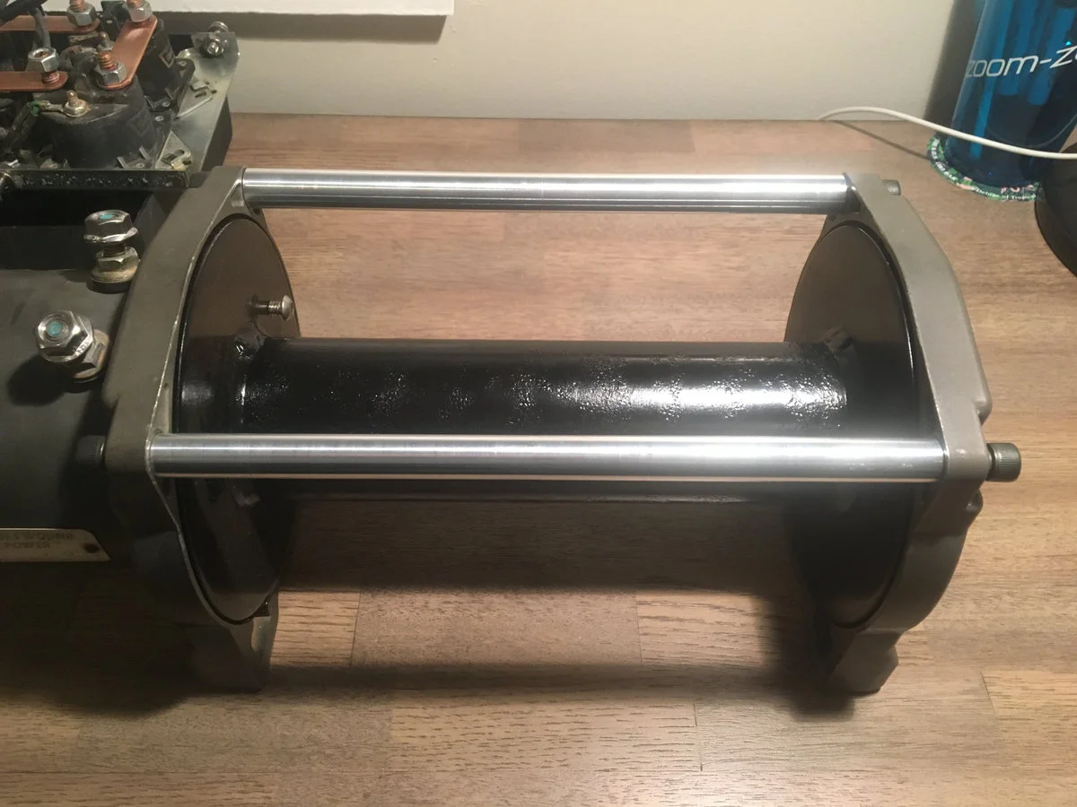

After some cleaning, sanding, and painting:
I decided on making an in-cab winch controller. It’ll use an on-off kill switch with momentary switches for spool in and out. The switches showed up yesterday but I was too busy enjoying the nice weather and drinking beer outside by a fire to do any wiring.

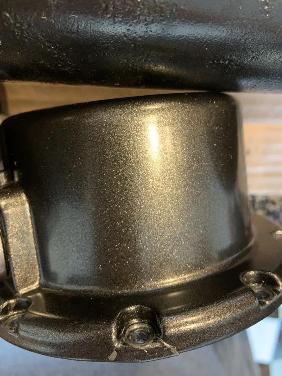

I have a color picked out to paint the housing, just need to buy it and spray away. Waiting on the weather to clear up as more rain has rolled in to Atlanta.
Got the winch painted and bought my AeroShell 64 at the local airport. Ran my wires for the in-cab controls and now it’s time to design the switch panel. Nothing beats some good ol’ CAD work for figuring out button placement!

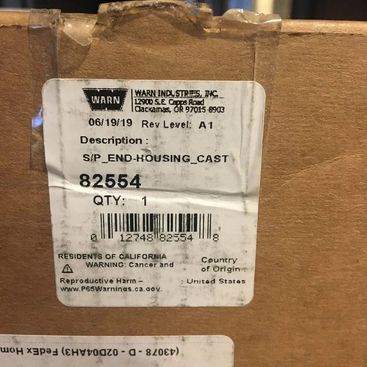

Welp, this weekends winch rebuild didn’t go as planned. Got the switch panel tested with the motor and it worked exactly as I hoped. That’s where the good things stopped. I got the gears all greased up and put in the housing, bolted all the pieces together, and when I was tightening the last bolt on the brand new clutch housing using a 1/4” drive the casting cracked in two at the bolt hole. Tomorrow I’ll reach out to Warn about a replacement since this is clearly a casting defect. There’s no way that it should have cracked that way.
Reactions: Blondie70
That is got to be a pain! Sorry it happened Jesse.
It’s certainly not ideal, but fortunately Warn has the best customer service hands down when it comes to off-road. Maybe even in general. Just got off the phone and the guy didn’t even hesitate to send me out a new end housing. 10/10 would recommend a Warn winch to anyone that is searching.

Thanks! The wiring was super easy. I have a 5-pin controller so it was just connecting one switch to the “in” solenoid, one to the “out”, and bridging the ground of those solenoids to the winch body instead of getting grounded through the controller. I’m going to pull the signal power from the cig. lighter in the center stack.
