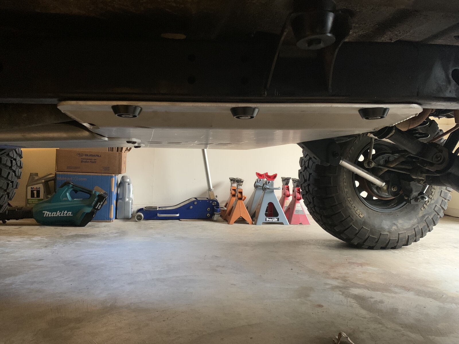

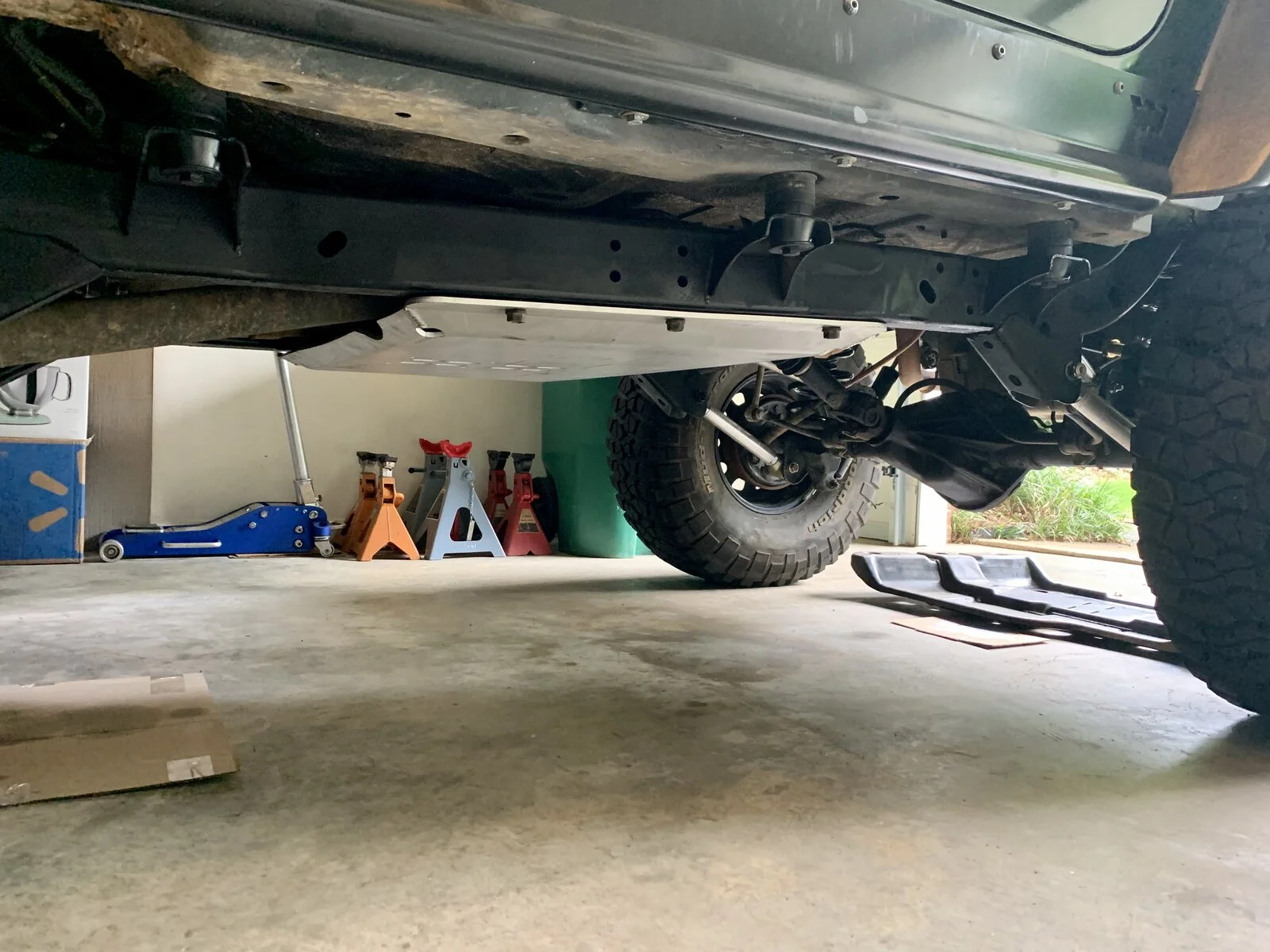

Made some progress on the Jeep yesterday. I installed the transfer case skid and the motor mount lift to complete my tummy tuck. Everything was smooth and easy except for getting the last bolt on the motor mount to start threading. I moved it around every which way until the wife came out and asked what I was doing. I asked her to work the ratchet while I adjusted the mount and before I could even get under the Jeep she had it threaded.

Engine skid is up next. One of these days I’ll wheel this thing again!!!

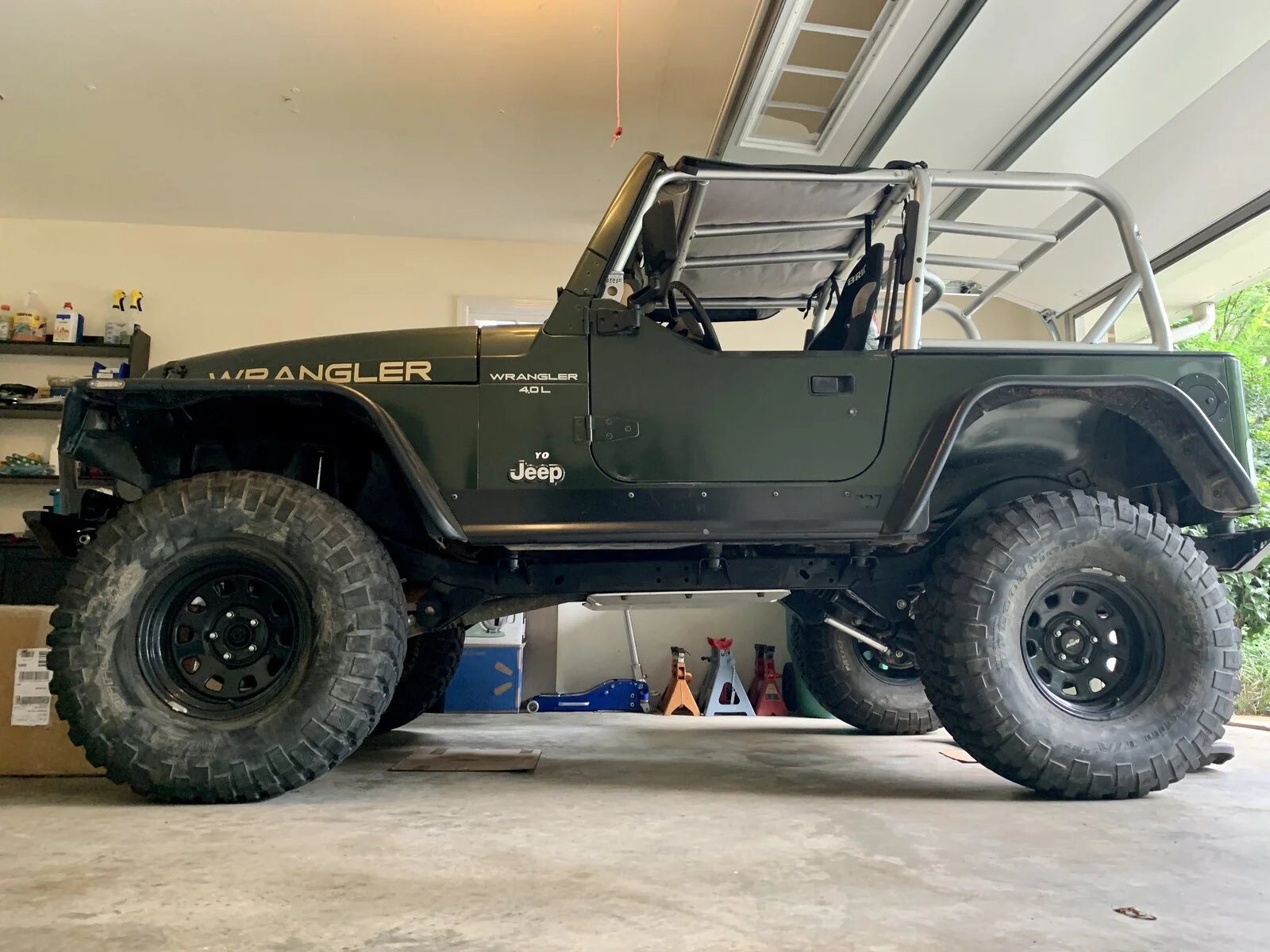

Got my engine skid installed the other day, and finally placed my order for some new shocks. I decided on the SkyJacker Black Max's. Got the B8525 (9.8" travel) fronts and B8563 (11.1" travel) rears. Still have a lot of work left to do until it's ready to wheel again unfortunately.

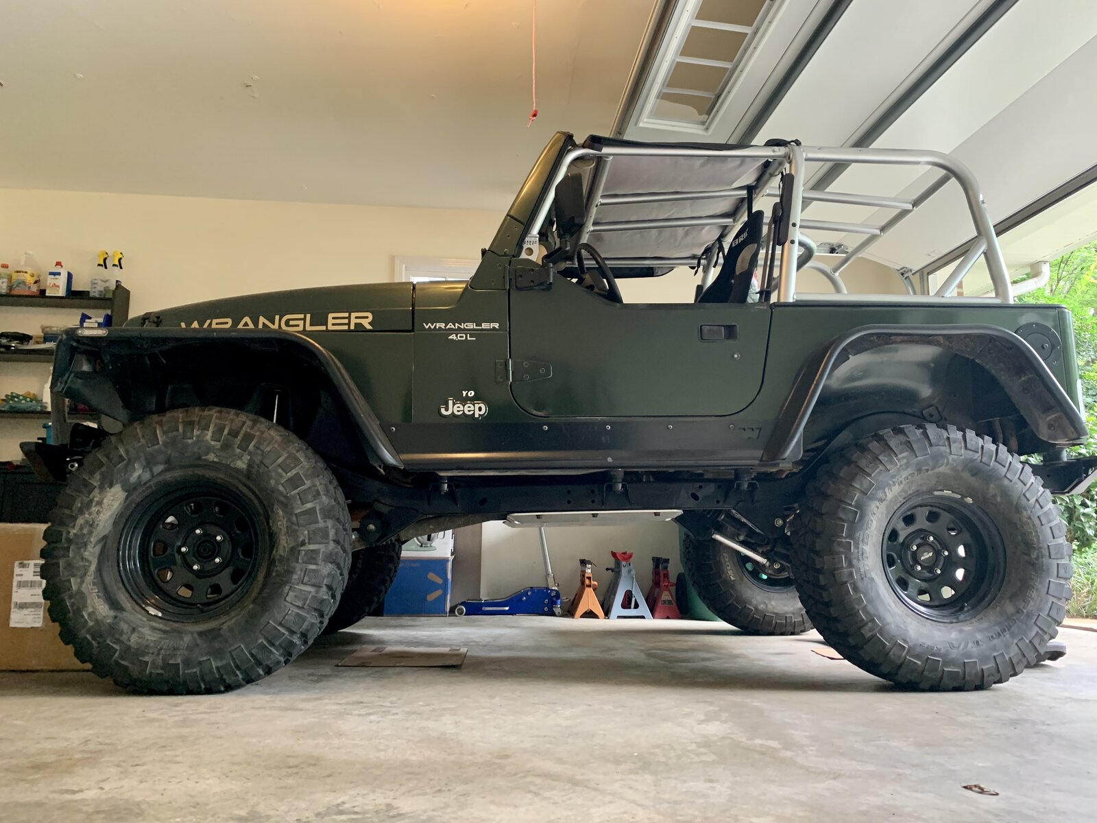

Really slacked on this Jeep build over the summer/fall, but had to get it running and driving again by the beginning of November to get the emissions done for my tag.
My Optima Yellow Top battery died, so I replaced that. It had a date code of 2017. I replaced it with a Duracell AGM battery from Sam's Club. I have the same one in a different size in my daily (2015 BRZ) and I've had no complaints over the last two plus years.

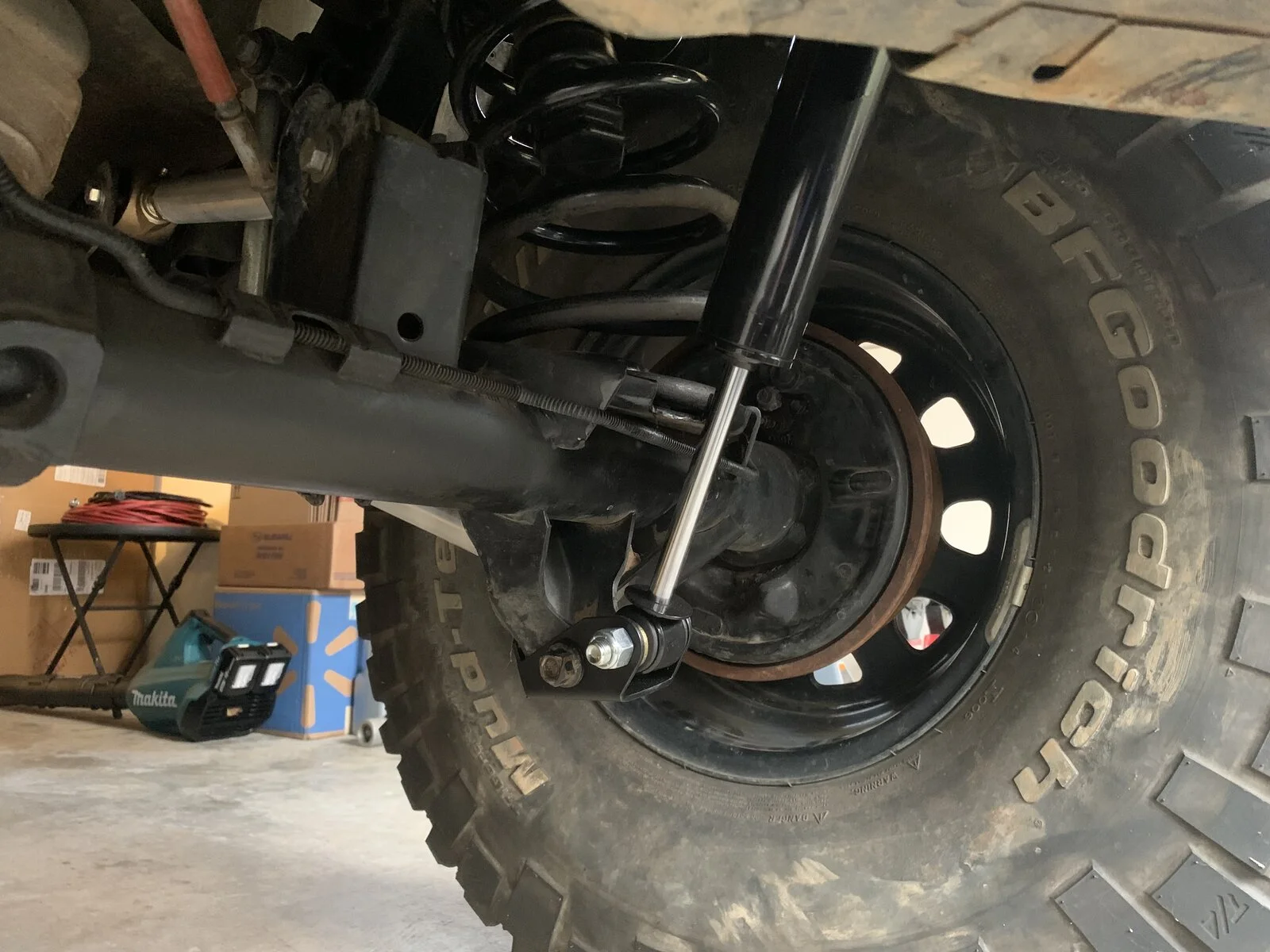

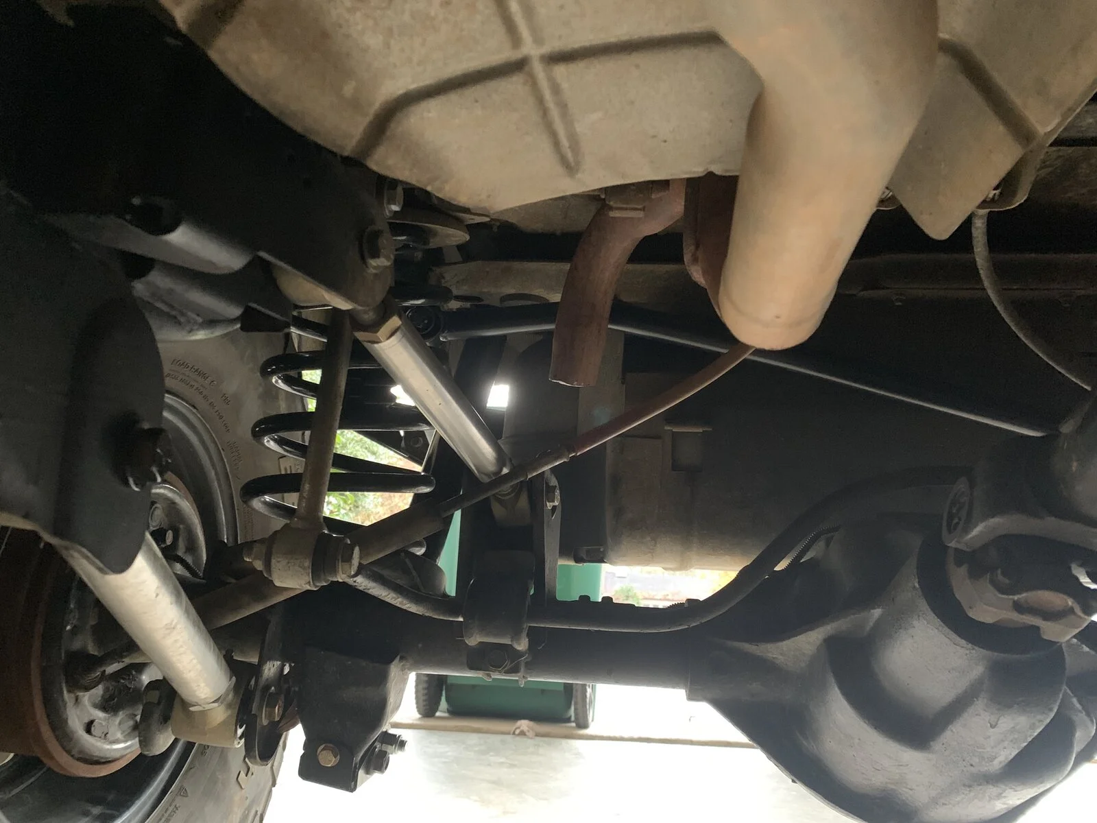

I installed the Black Max shocks, but once I re-adjusted my pinion angle I realized I still needed some shock relocation brackets. I purchased the Currie/RockJock CE-9601 brackets and they do exactly what they're supposed to. Got those installed and am enjoying the shocks on the TJ so far.
After getting the shocks on and pinion set, I had to cut the exhaust off right after the hump over the rear axle because it was contacting the back side of the shock body. This is not my best work, but without dropping the gas tank I will take it for now and clean it up in the future... maybe... if I remember lmao!

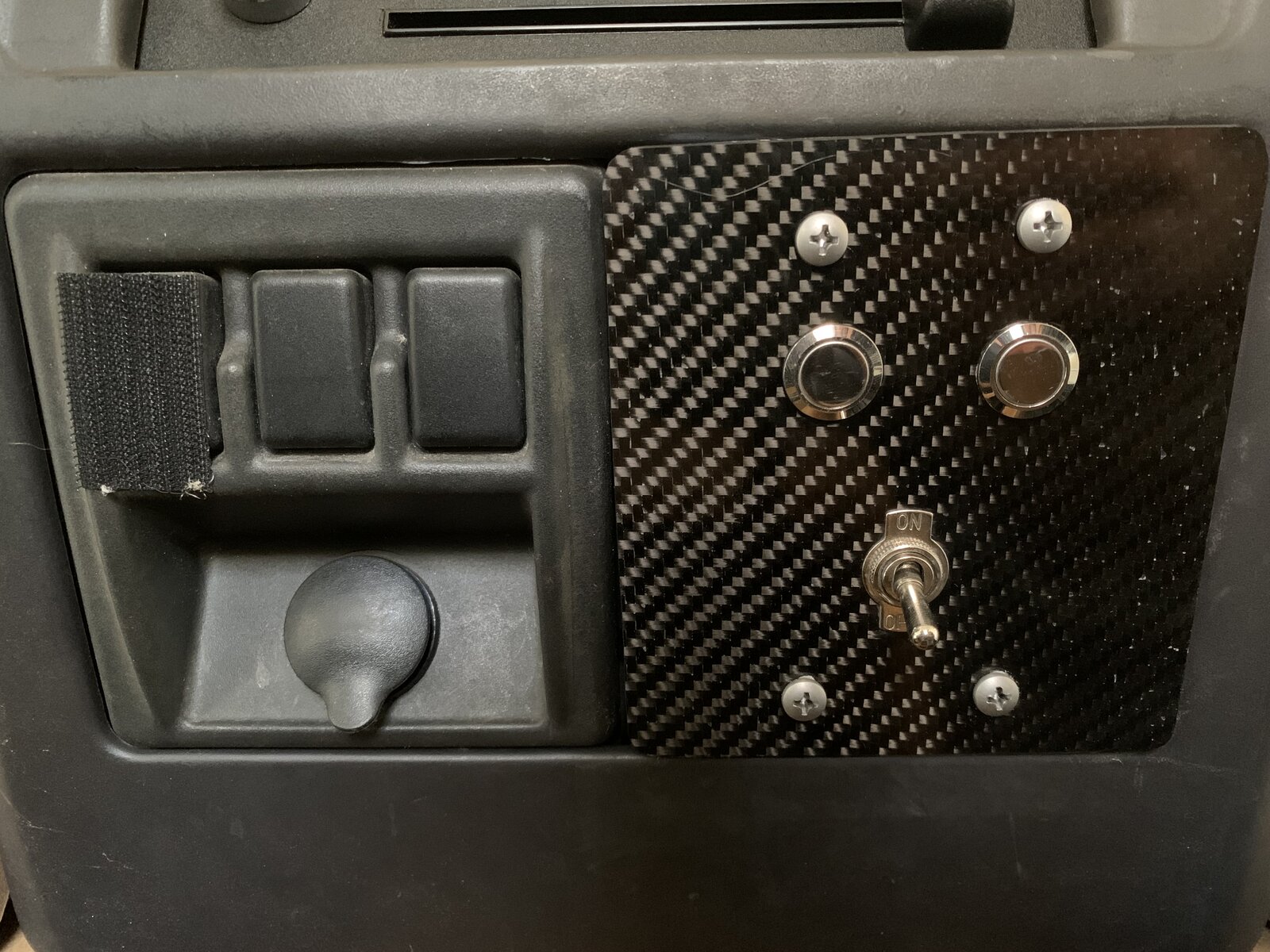

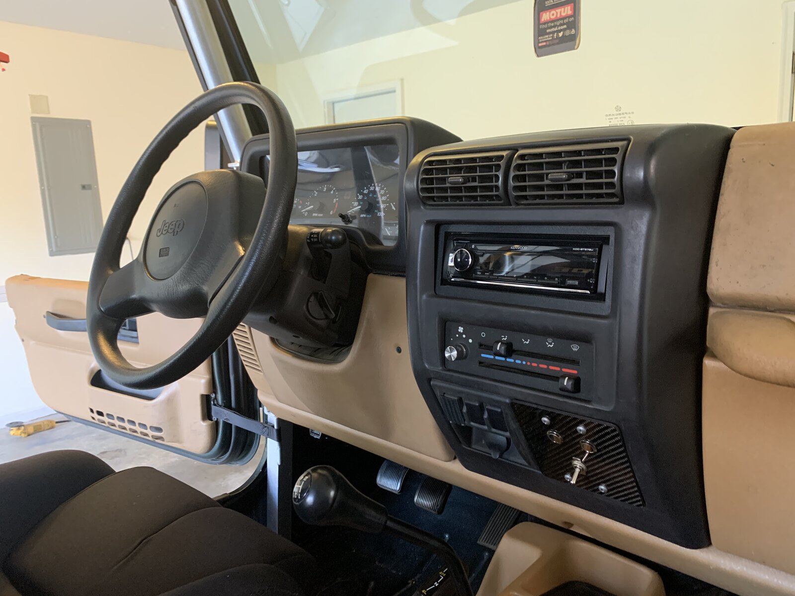

After all the real work, I decided I would have some fun making parts for the first time in a while. I had a switch panel designed out of cardboard that I taped in place over a year ago and finally spent the afternoon making it out of carbon fiber. Normally I'd say it's excessive, but my wife is a composites engineer and actually did the layup that I used. It's nice to have a part that she helped make on the Jeep.

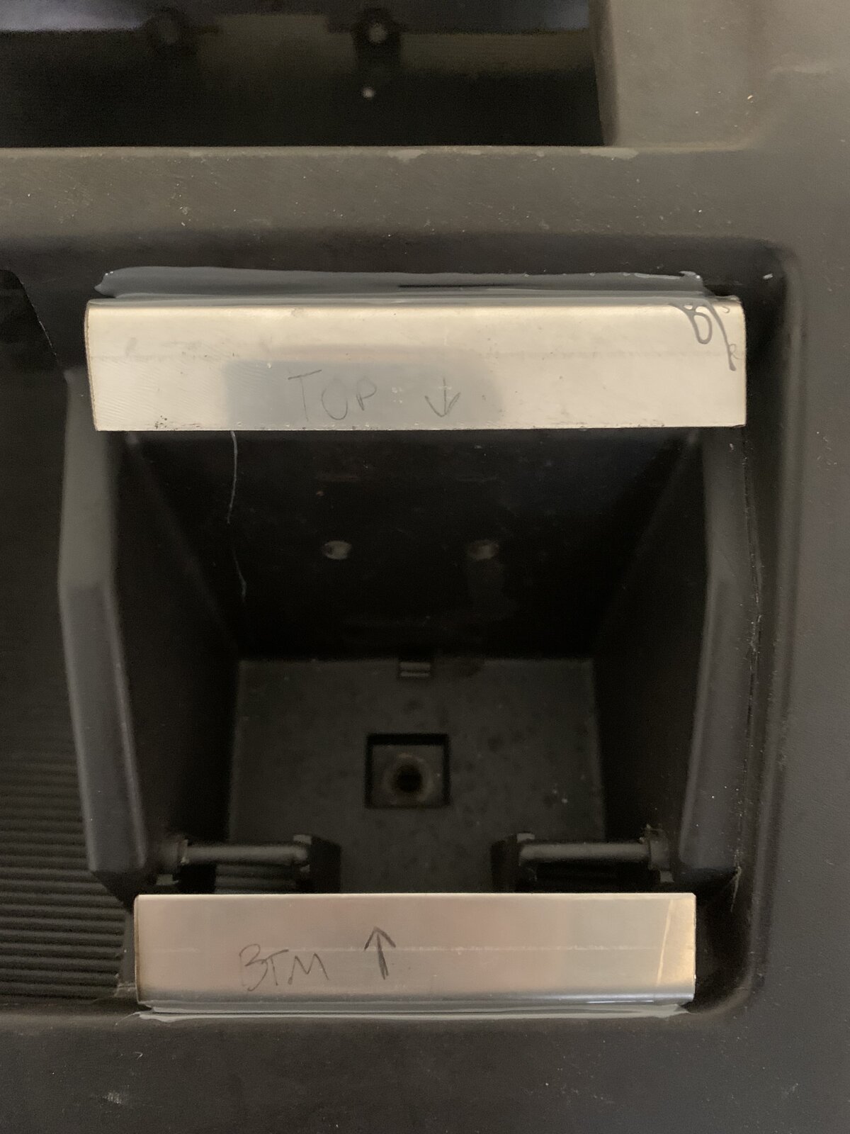

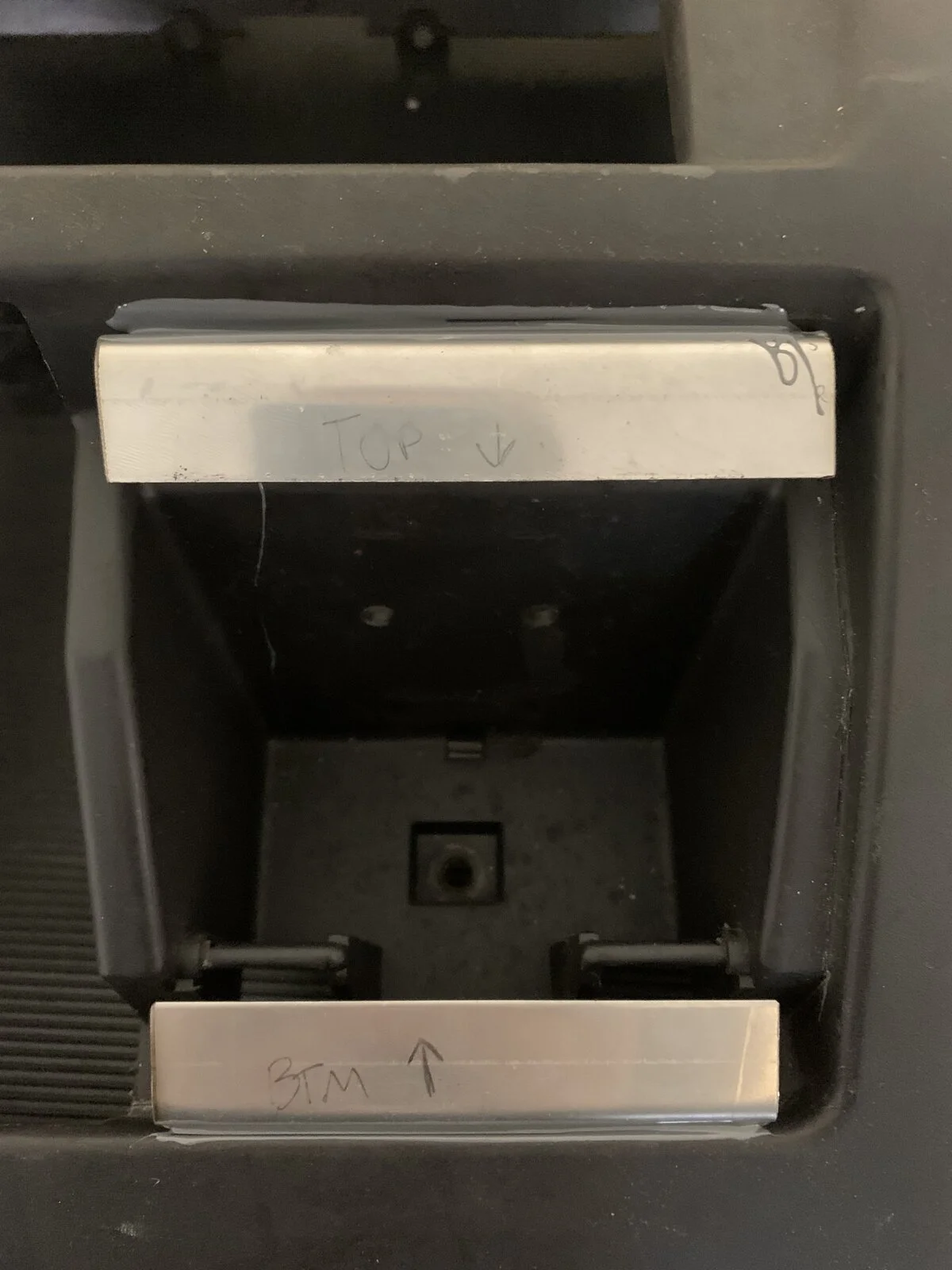

I used some 1" x 1" x 16ga stainless flanges that were in the scrap bin at work, bent them to the approximate angle, and JB Welded them in place on the center stack where the ash tray went.
I then cut and drilled the carbon fiber panel to the right size and slapped that bad boy together! On/Off is power to the buttons, the left is spool in, and the right is spool out.

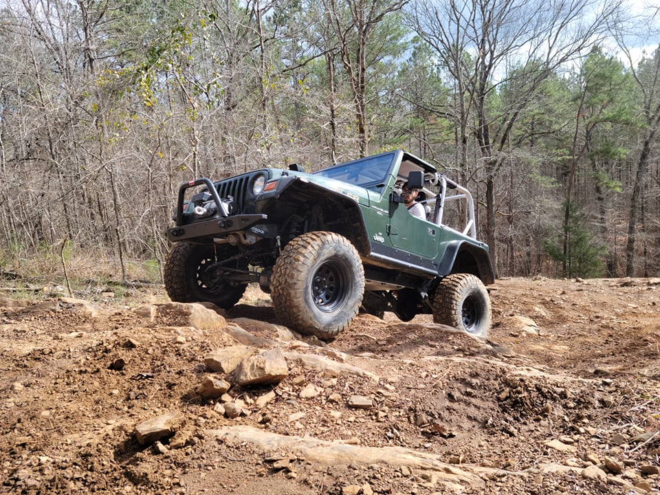

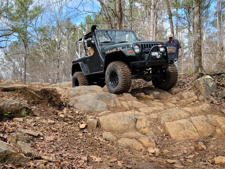

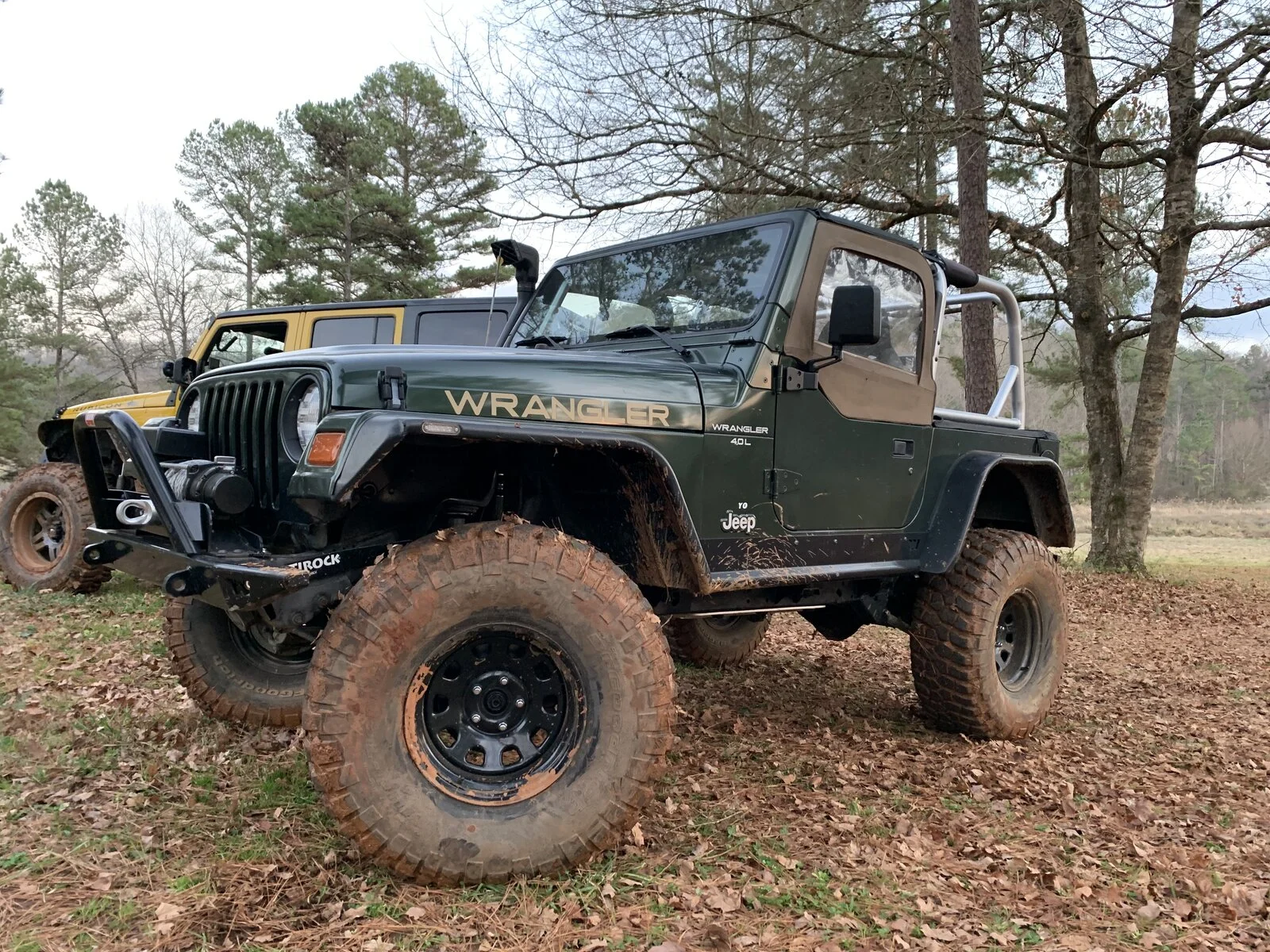

Made it out to Morris Mountain yesterday and got in some wheeling for the first time since May 2020 when I busted my brake line. Overall the improvements I've made to the Jeep since then are wonderful!
  • I didn't get the skid hung up on anything like I used to with the stock one!
  • The new shocks are a world of a difference. So much smoother and better overall ride.
  • The AntiRock coupled with the new shocks kept the front end much more controlled than it used to feel.
I was wheeling with a JKUR on 38" Swampers and noticed a few instances where the wheelbase made a world of a difference on obstacles. There was one in particular (if you take the bypass to the right of V-Notch and then go up to the left) where I was getting all four tires caught in undercuts trying to climb up rocks and it just wouldn't go. The classic short arm wheel hop started happening as soon as I would try to get going. With it being as slick and muddy as it was I didn't want to just send it. I backed out and reset a few times to try different lines with none of them working. My cousin in the JKUR was able to walk right up it since he only had one axle trying to get out of the undercuts at a time.
Aside from needing more wheelbase/better geometry the only other issue was that when I was using my newly made switch panel for the winch, the push button switch sometimes didn't stop providing power so I was using my kill switch to stop/start. I need to investigate this further with a multimeter. I also need to hit my exhaust with a BFH since the tip was contacting the track bar randomly at idle and would make a miserable rattling noise.
No great pics since we were busy wheeling, but here are a few from the beginning/end of the day.
