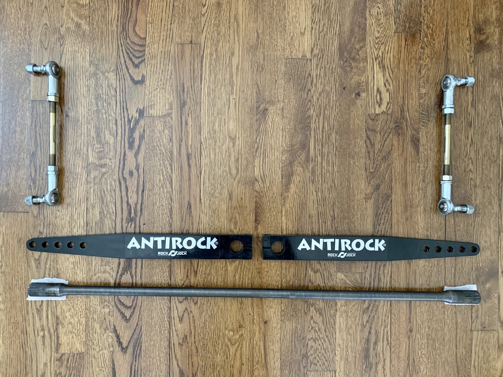

And boom! Installed on the stiffest setting. Need to do some flex testing before I take it out on the trails, but looking forward to getting it out there.
I'm curious to hear how you like it on the tightest setting. I've never tried to run it on that setting. The most I ever tried was the middle when they came with 5 holes.
I was really interested in it too. I figured that most people didn't use it which is why they dropped the front two on the new versions, but I wanted first hand experience as to why. I'll report back once I get a chance to test it out.
Reactions: Wildman
I did use it on the stiffest setting before and liked how it drive in the street. Off-road I thought it was a little limiting, which is why I moved it to the middle setting. The middle was my compromise, better of both so to speak. You can see the hole locations on the arms where I used it.

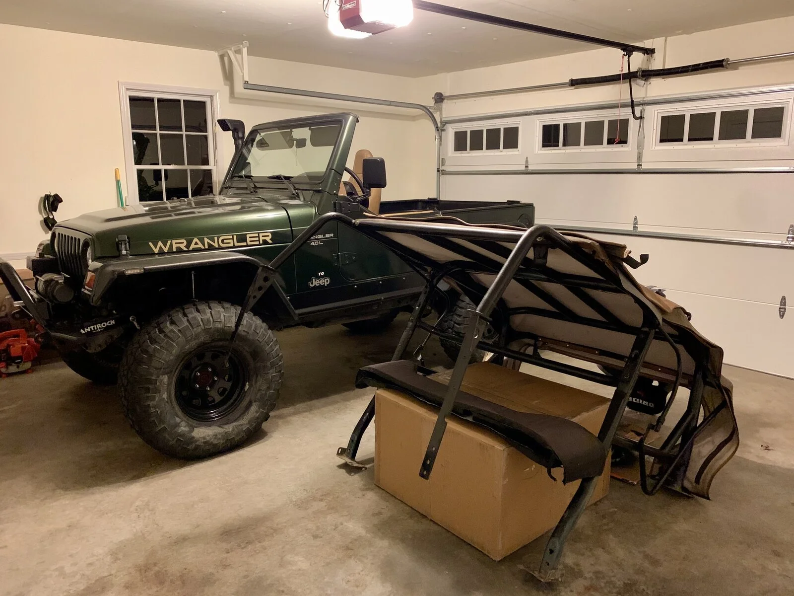

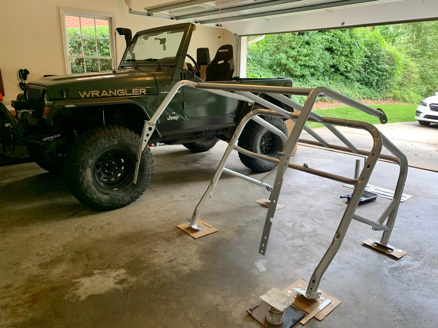

I picked up a sport cage from a club member that has the OR-Fab weld on cage conversion done to it for $200 the other weekend. Stu Olson has a write up on the cage here. I am working on cleaning it up and plan to paint it a matte silver. I’m getting the Jeep cleaned up as well while I have it all out.
If you know, you know why I painted these cross bars like this instead of taking them out. It’s always bothered me that they were rusty since I put the Bride in there.

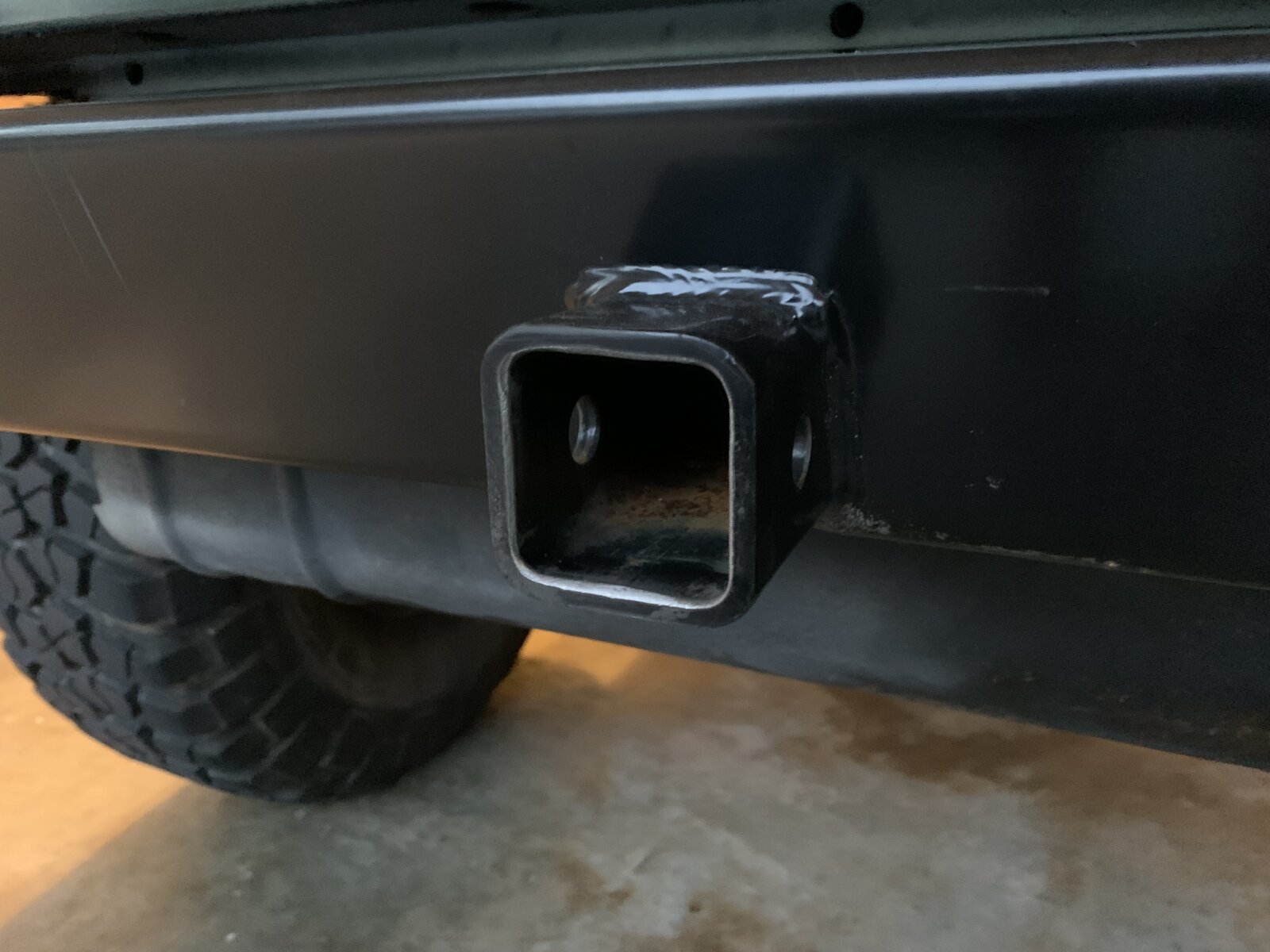

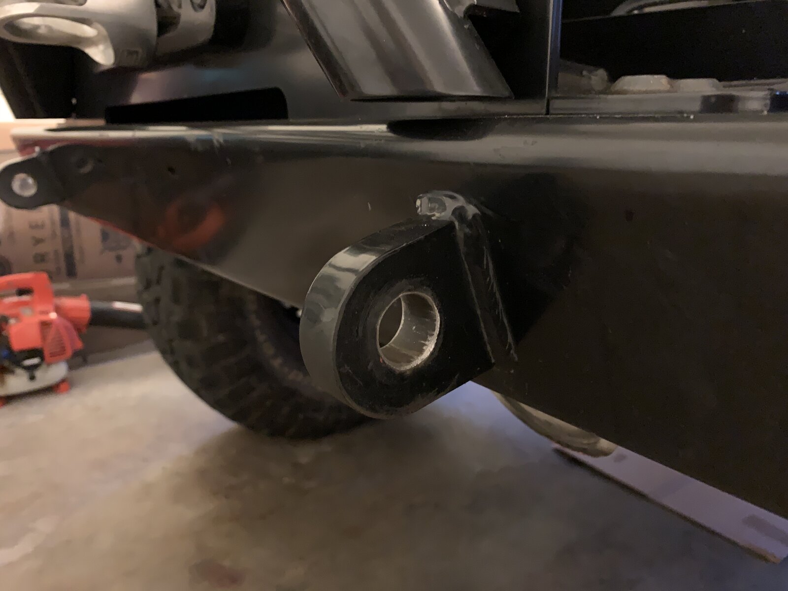

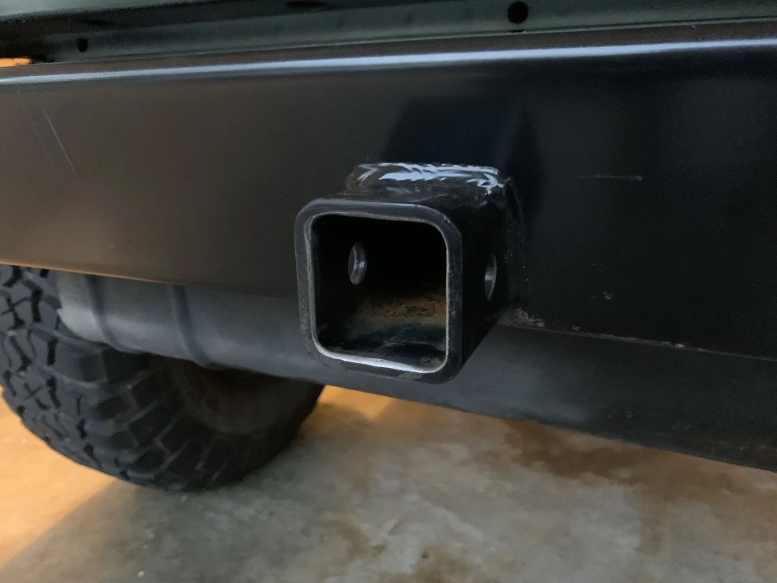

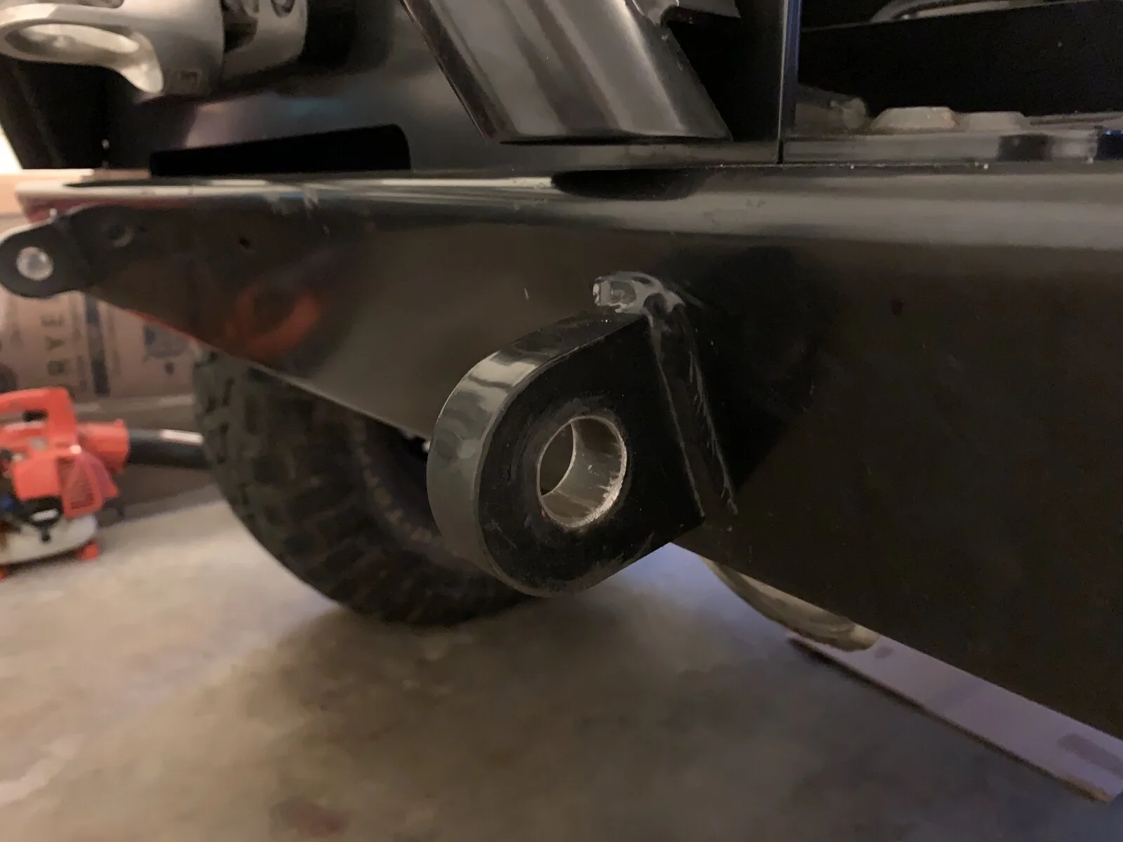

I stopped by Harbor Freight today and picked up some rotary rasps. I took the evening to round off all my recovery points. I finished them off with some 150 grit. All that’s left is some paint.

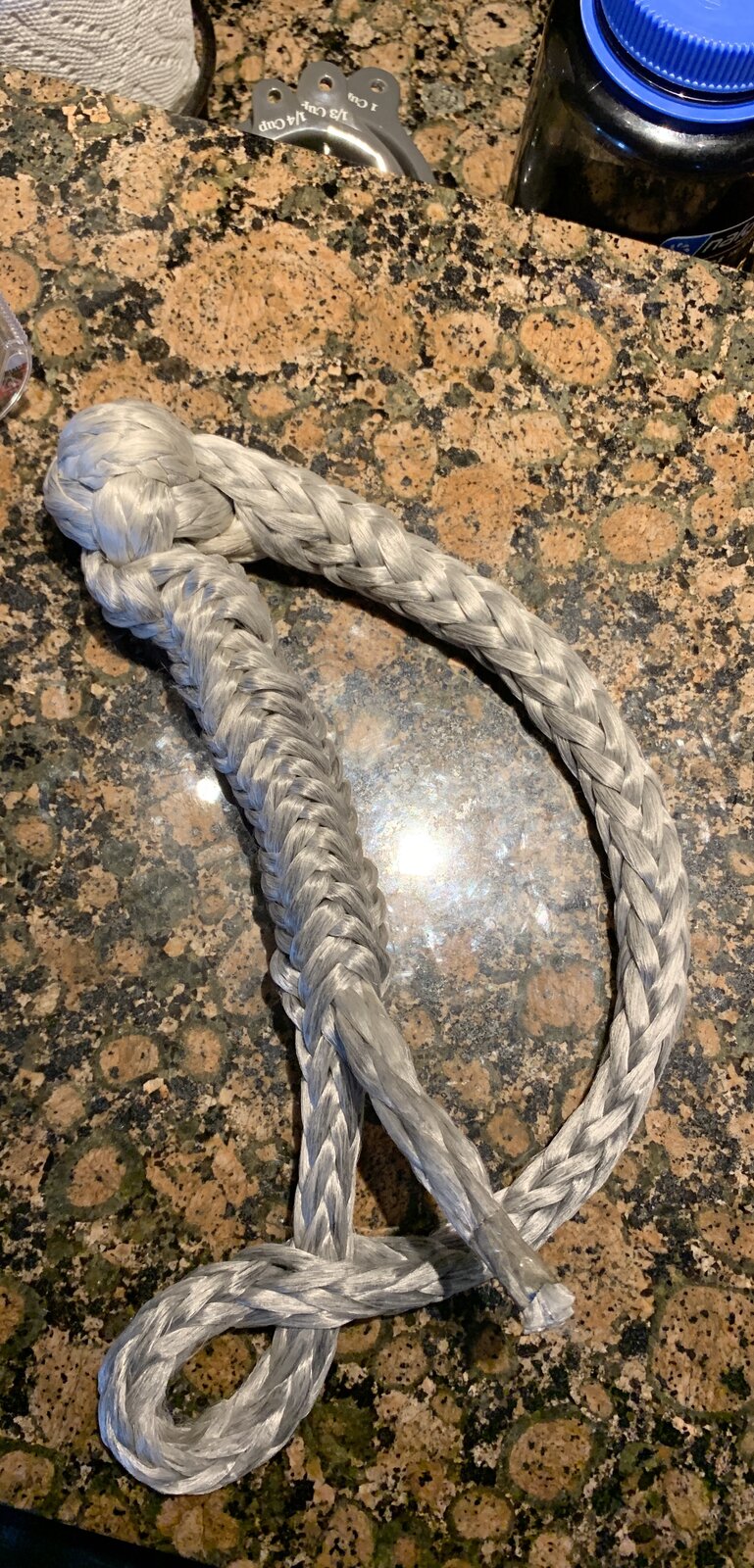

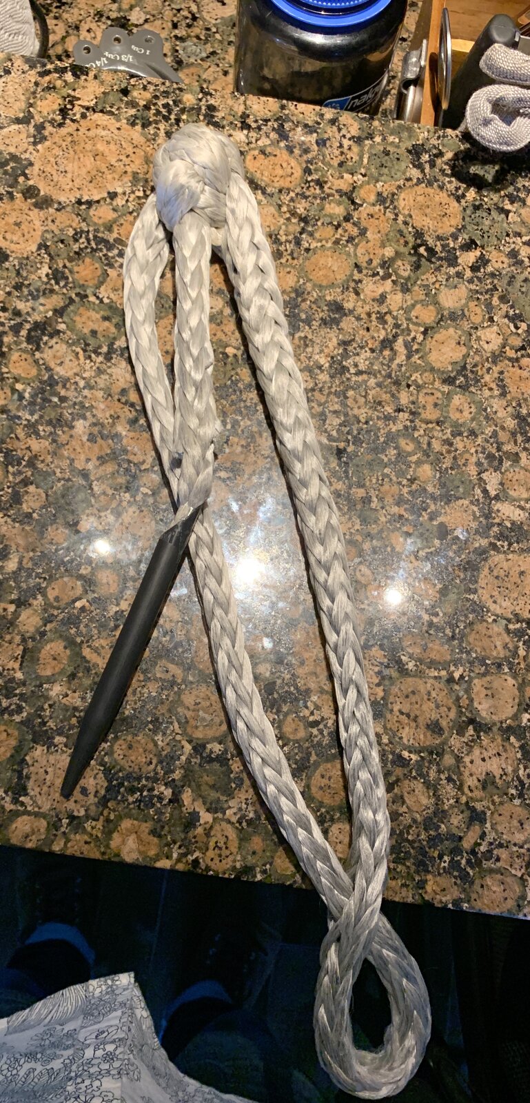

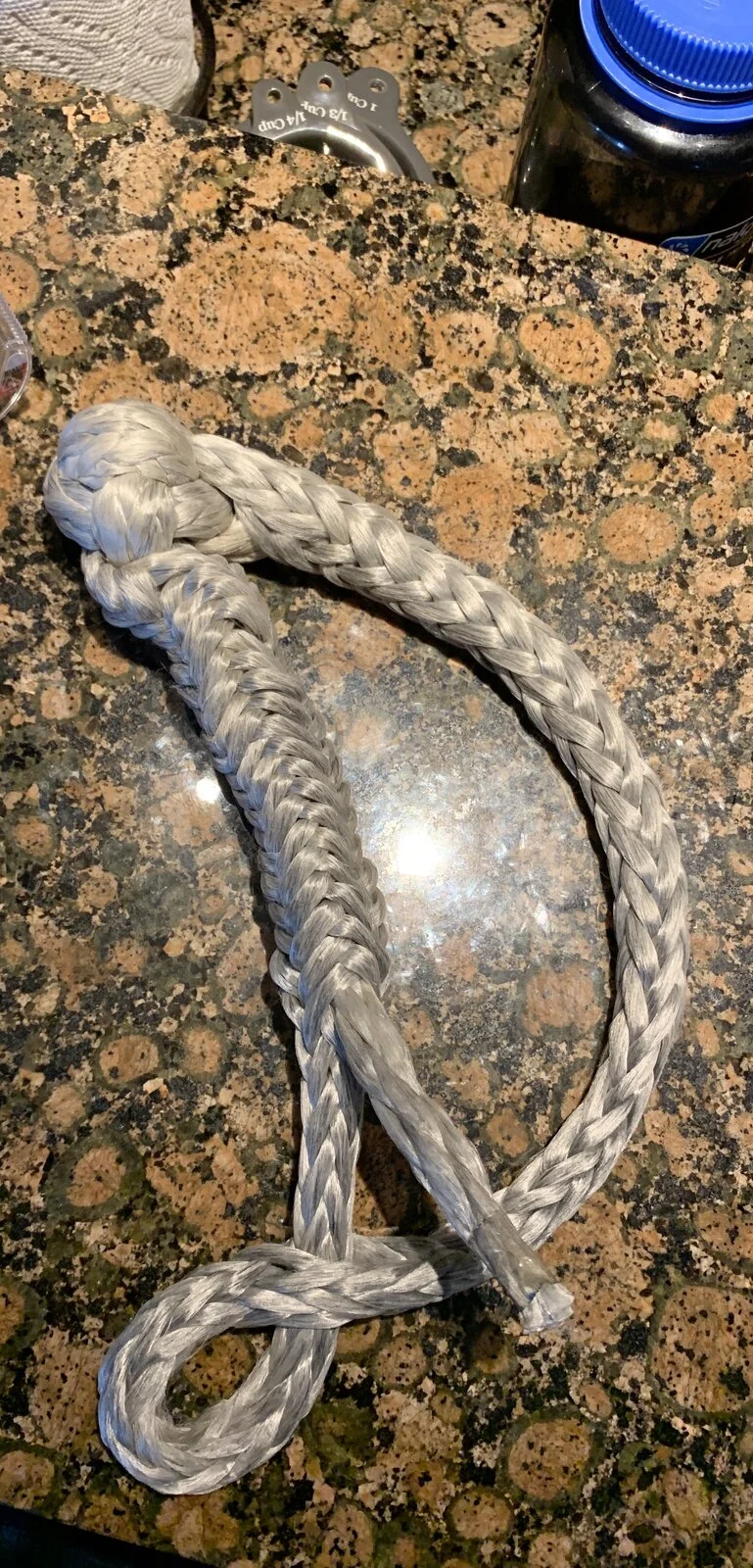

Ripping your newly made soft shackle would suck a big one! Good idea. Got any finished pics of the shackle? I still haven't made the switch from the old steel ones.
I have some pics from when I was burying the tail. If you want to come by one weekend we can round yours off for when you make the switch

I finally got a chance to pull the cage out after test fitting it and got two coats of paint on it over the weekend. Now all that's left to do is one final coat and buy some good hardware for it. I really cant wait to get back out and wheel this thing... it's been over a year now.
