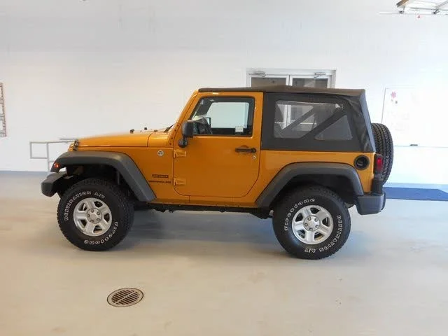

OK great thanks glwood I appreciate it. While browsing, I saw this 2014, a lot of clearance between fender & wheel.
