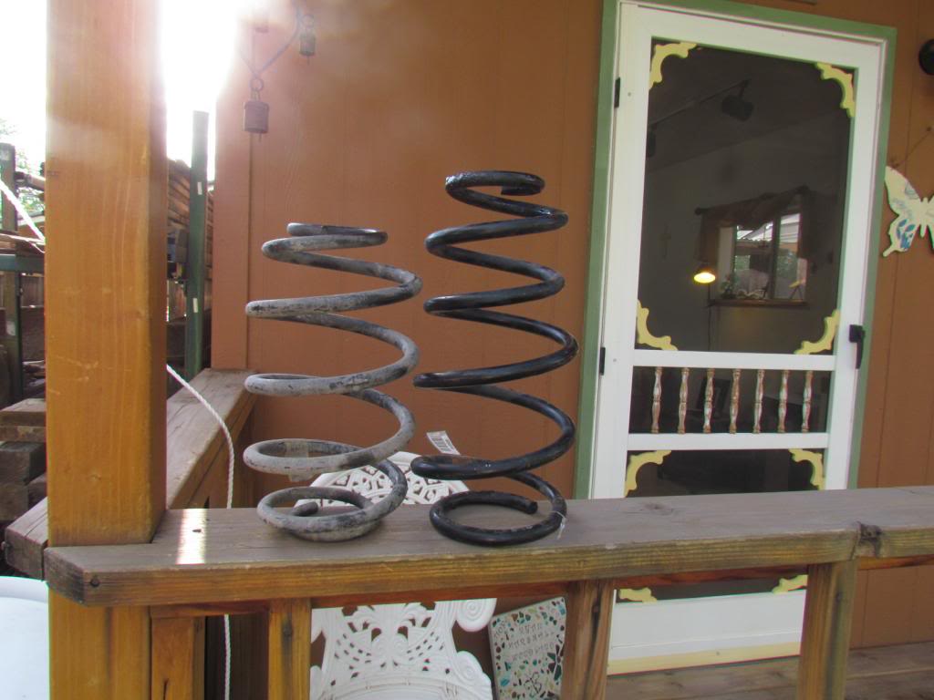

Rear, TJ on the left, JKUR on the right, you can see why the lift:

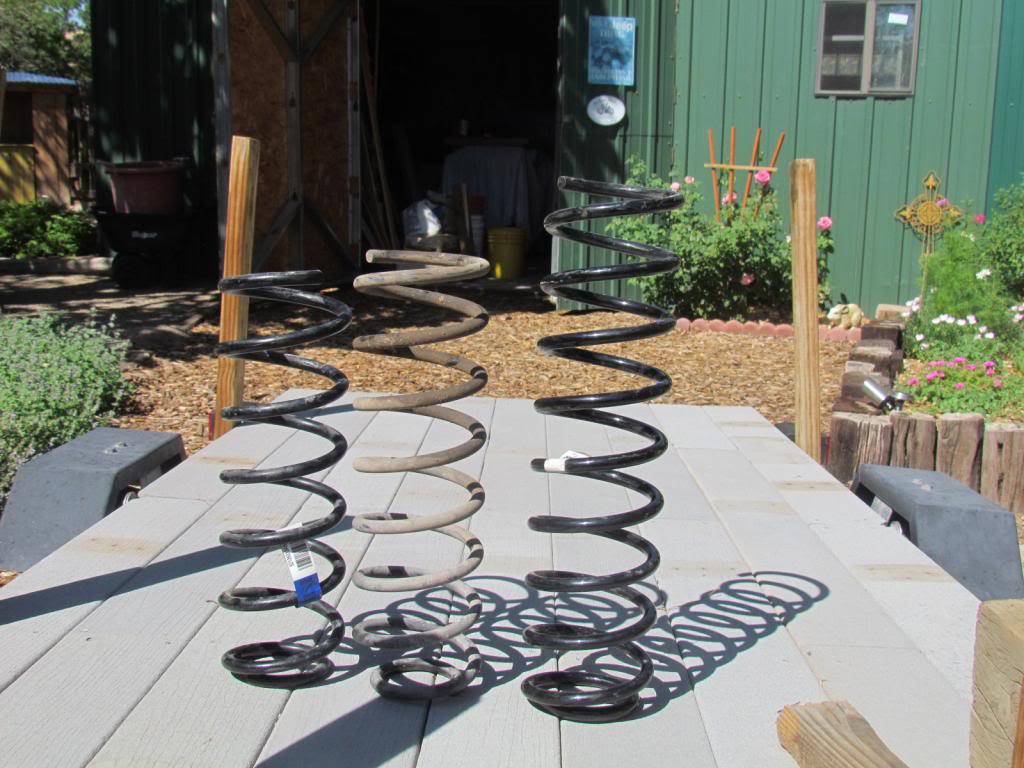

Front JKUR on the left, TJ X in the middle, OME springs on the right:

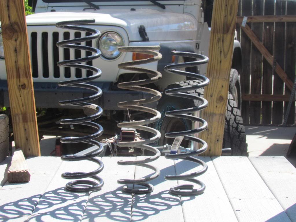

Reverse, OME JK springs on the left, TJ X in the middle, and JKUR on the right.
