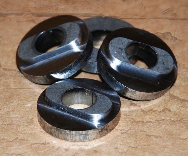

I think zero noise or movement is the gold standard for ball joints, but that movement on the lower control arm is almost certainly your clunk. The hole in the mount is slotted to allow for some adjustment from the factory via an eccentric bolt. BMB sells a set of fancy washers for basically getting rid of the slot and helping hold grease in. I bought a set while chasing my clunk and while it obviously didn't fix my issue, they are worth a look for you I think.
https://blackmagicbrakes.com/ols/products/johnny-joint-washers-set-of-4

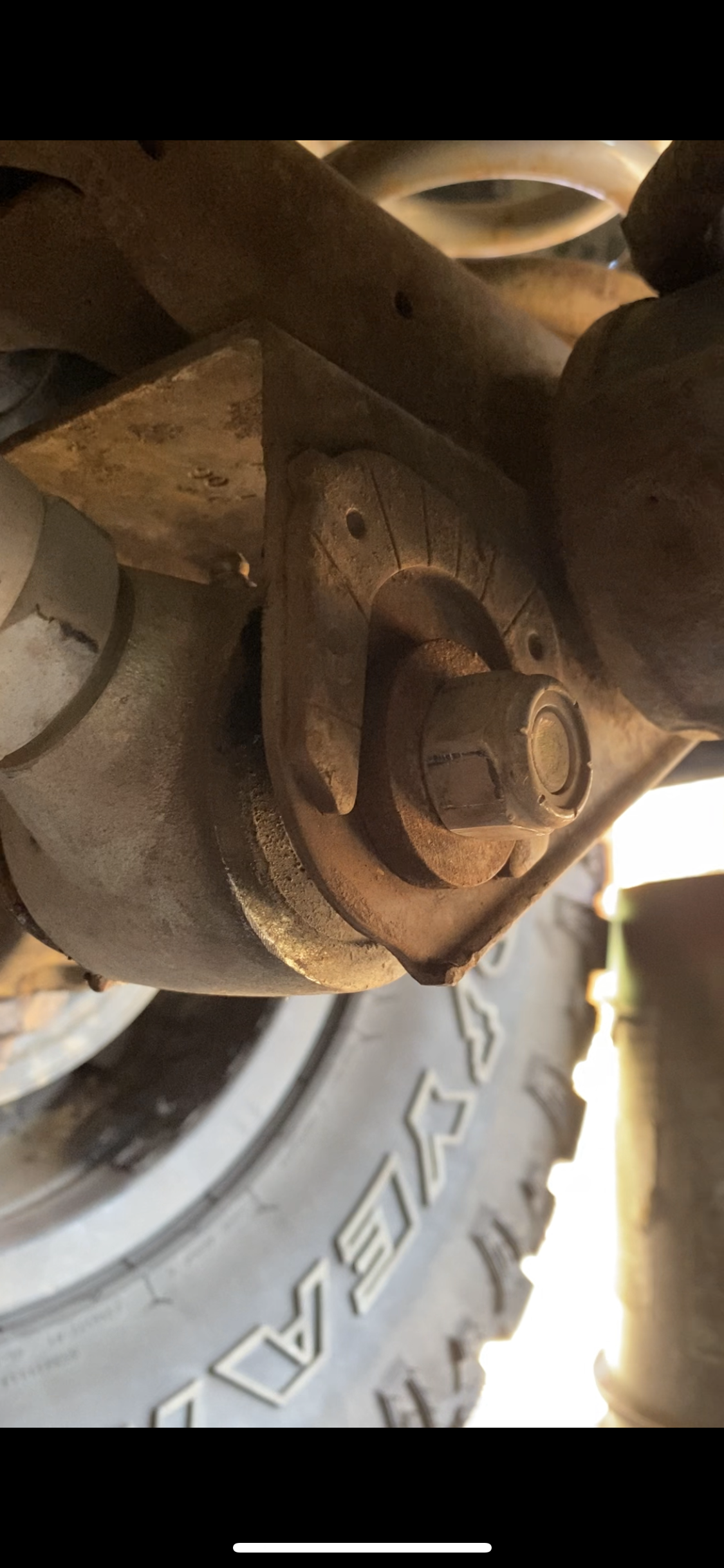

That’s what the bolt looks like fully torqued. It always seemed a little on the short side, but wasn’t certain if it was or not. I torqued to 130 originally. I just retorqued it to 150 today.

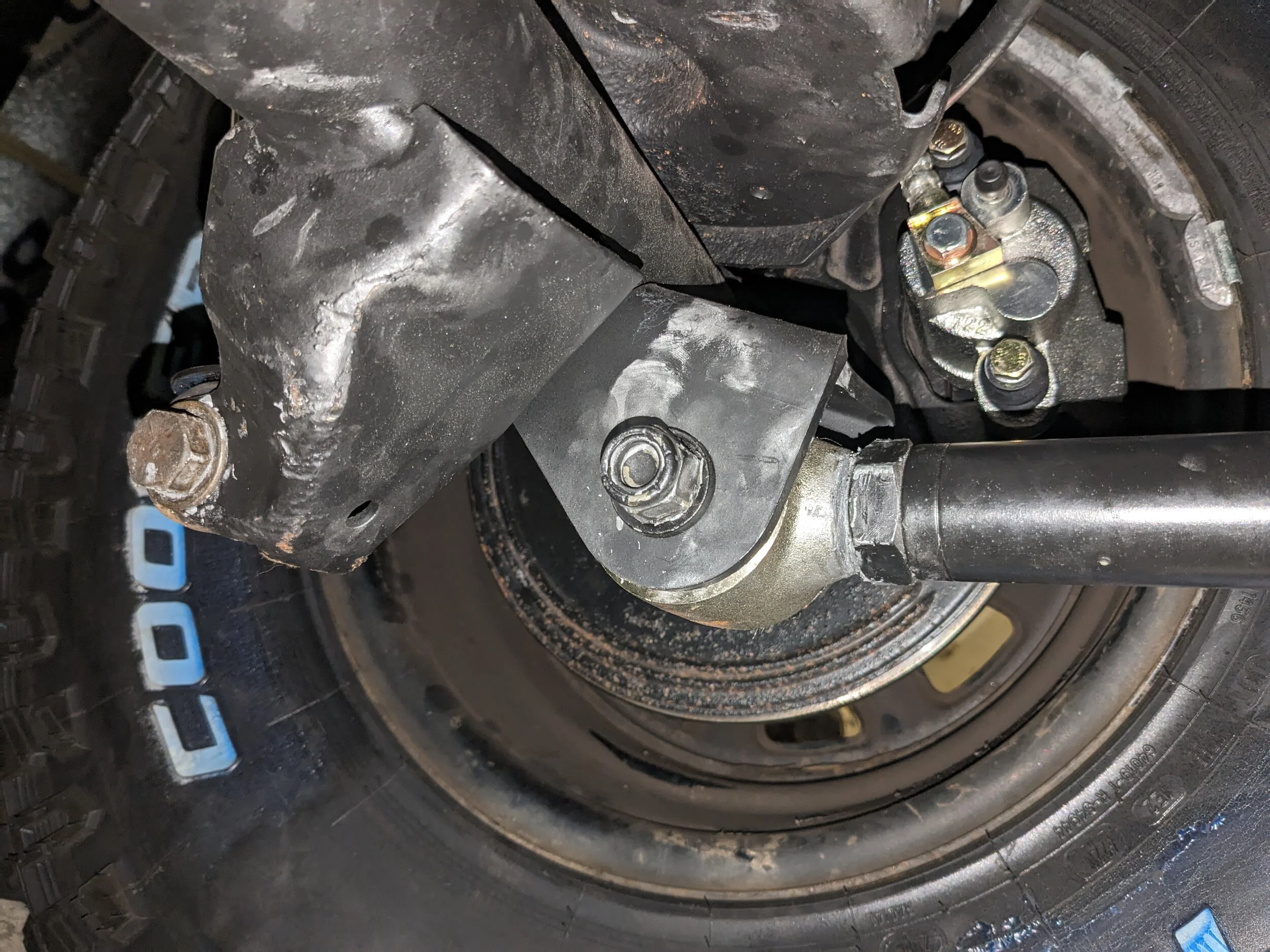

Here is the original nuts engaging the original bolts:
You'll note your kit, like these pics, show a nylocs and extra-thick washers. You want at least 2 full threads to consider a bolt/nut fully engaged.

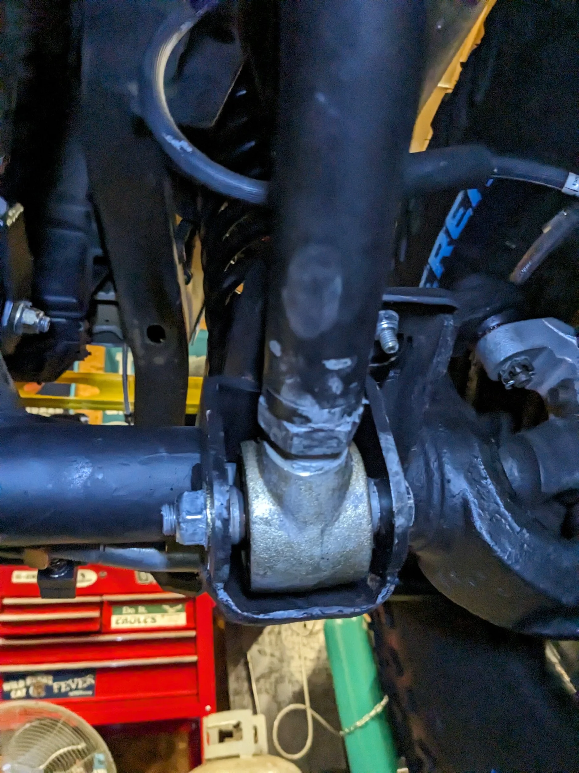

I emailed Gerald and he shipped out new nuts & washers (at no cost) that they include these days (and apparently before the COVID inventory-restricting days). I let him know I did not feel safe with my family in this Jeep without proper thread engagement. Despite other Savvy issues on availability (these days) and no stickers (contact Jerry), Gerald was very responsive on my concerns!
Much thinner (more typical) washers & non-nylon lock nuts resulted in much better thread engagement!

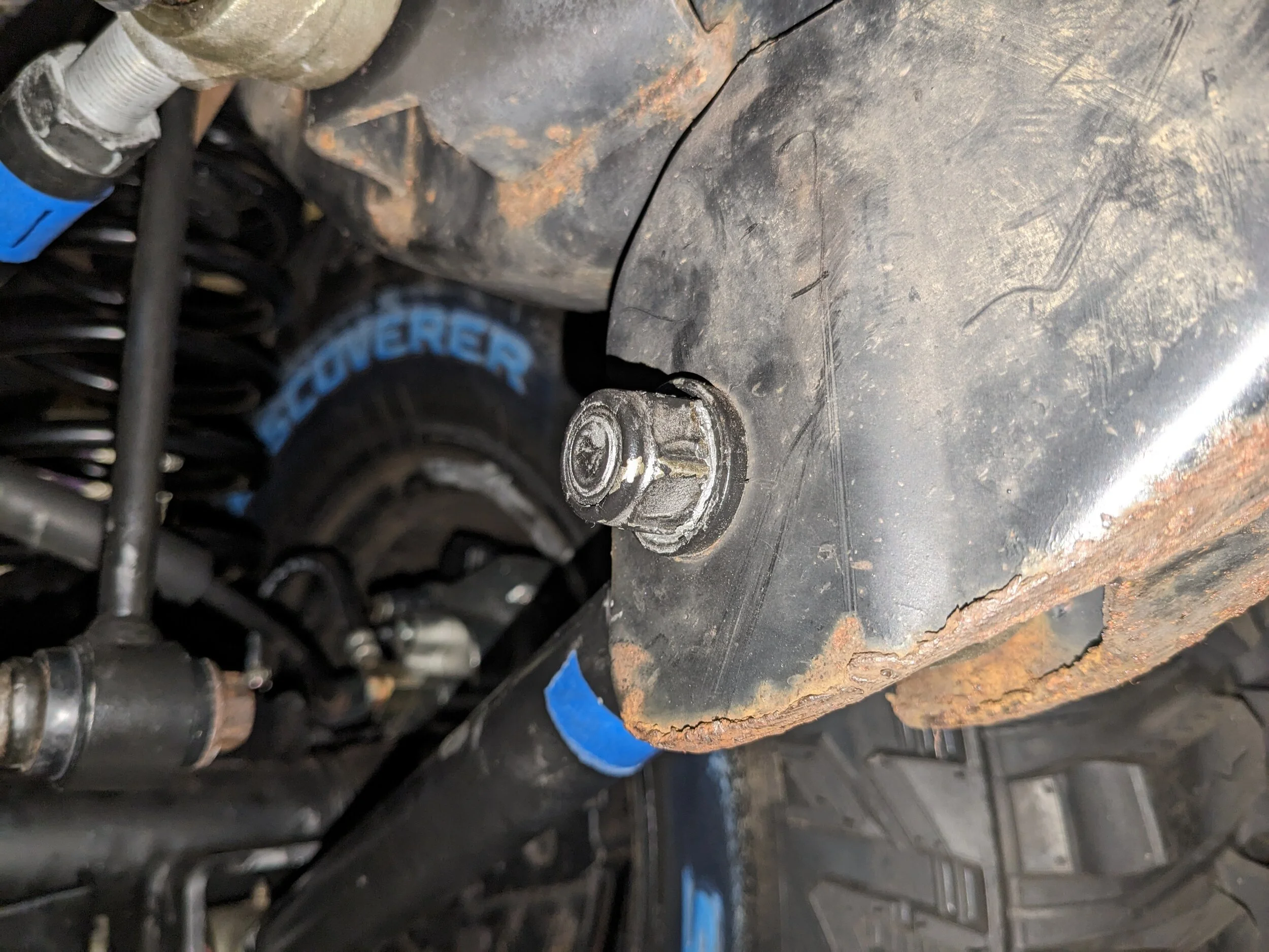

My bolts all have at least a few threads past the nut and I use Stover type (all metal with deformed thread) locknuts.
