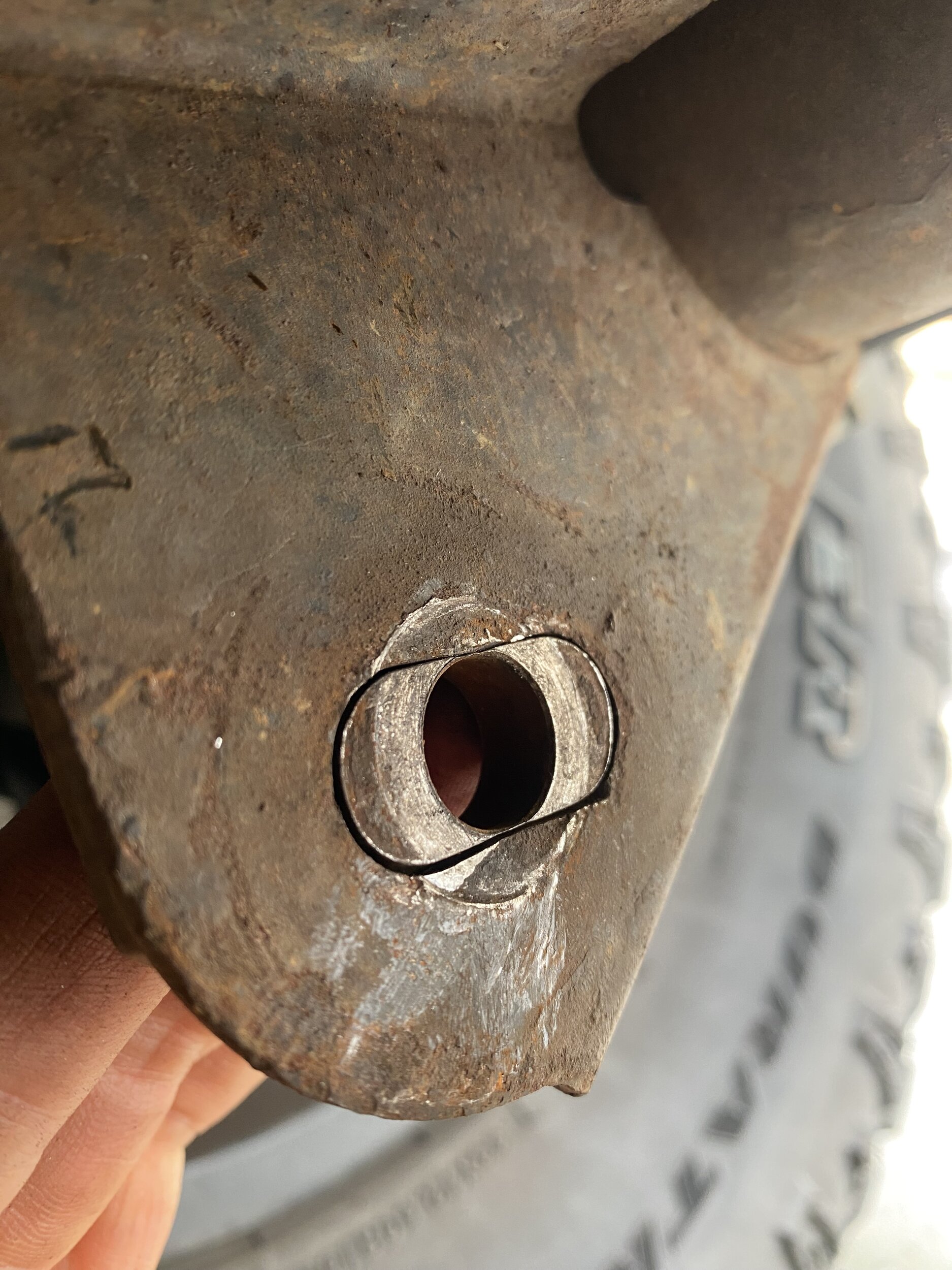

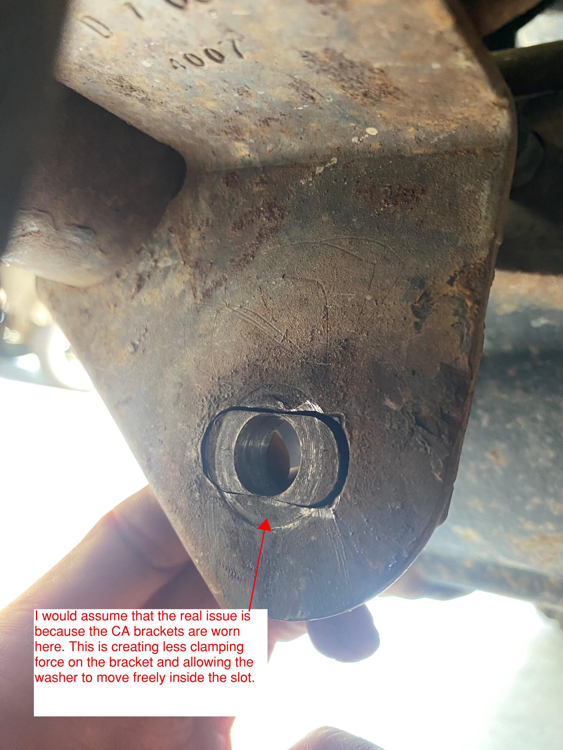

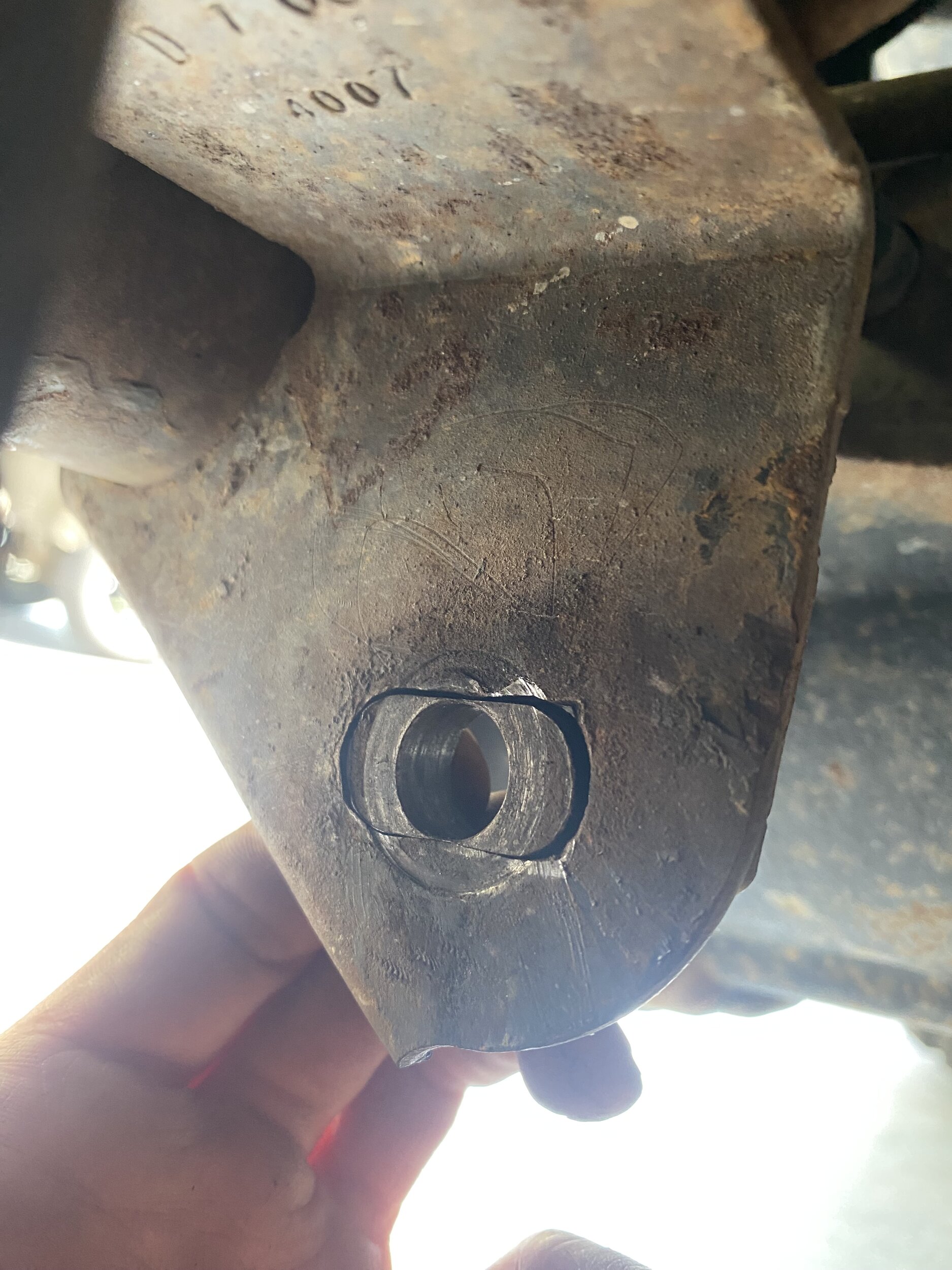

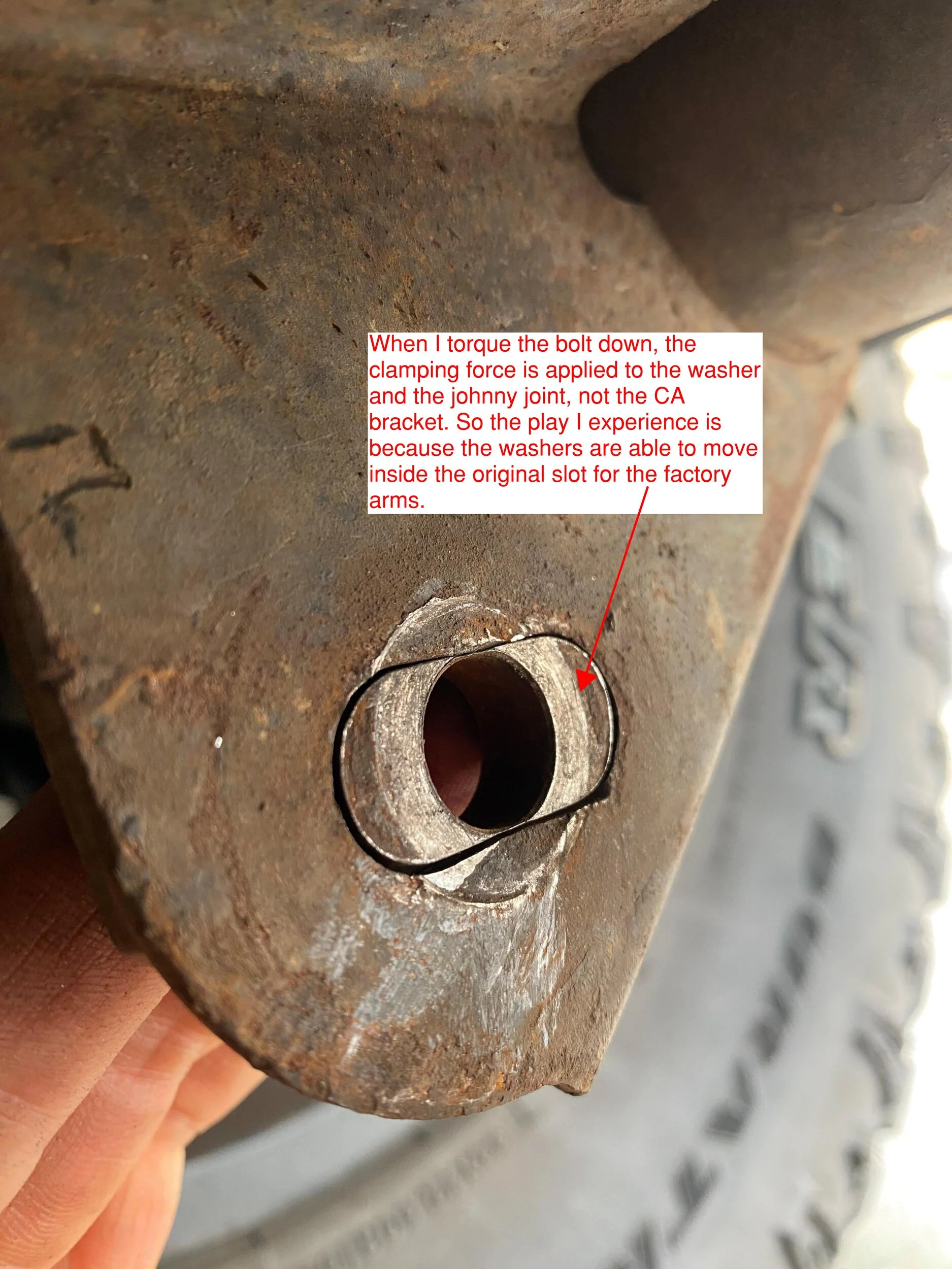

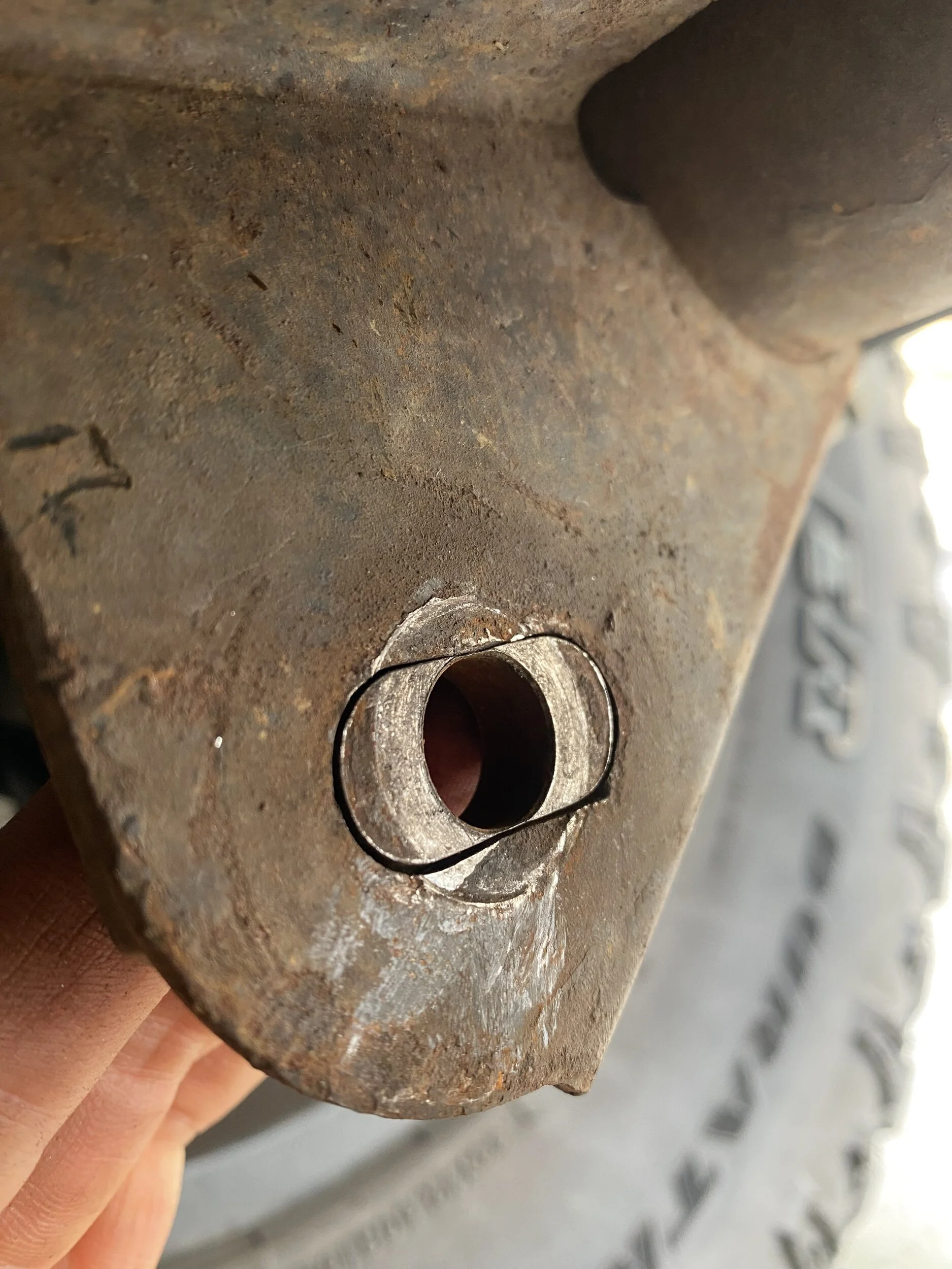

In what way? All they are doing is holding the bolt in one location since the factory slot is no longer needed, at least that’s my thought process.
The real issue I’m having is that the bmb washers are being torqued to the Johnny joint. But the original control arm bracket doesn’t seem to be receiving the same torque. So that allows the slop I’m getting, the slight shifting the bmb washers in the slot. Almost like the washers are smidge too thick.

I don't run greaseable bolts so no grease to hold in. This is what I think is going on. All the clamping force is between the washers and the johnny joints. and the factory CA bracket being worn down is now to thin and has no clamping force.

Are the black magic washers suppose to be welded in place by chance? Mine aren’t, just throwing ideas out there. I did see a post elsewhere that someone had a similar issue and they welded the Black Magic washers in place and it fixed it for them.
We weld them all the time. Your problem is that the oval that sticks into the slot is taller than the thickness of the mount side plate. You should sand or grind that lower until you can get clamping force on the sides of the mount instead of just the washer. That was also pointed out in the instructions.
Just so I'm clear on this, the proper fix would be to weld the washers in place and then remove the control arm and grind the inside of the bracket so that the washer and bracket are flush?
You don't have to weld, just make sure that the raised oval is slightly below flush at the inside face of the slot. The proper fix is to remove the control arm mounts and weld on a set of the ones from Iron Rock Offroad and keep the bolts tight this time.
