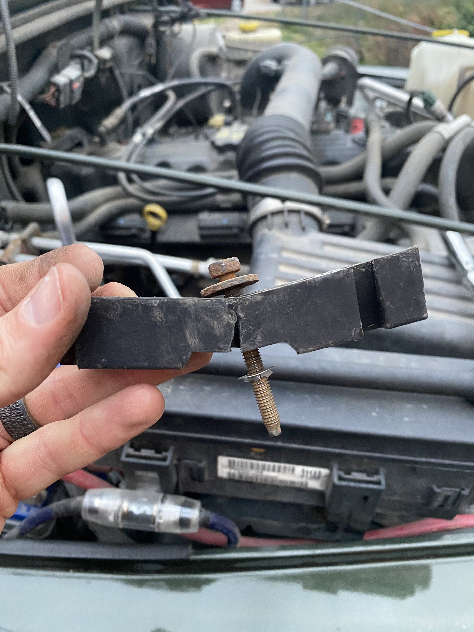

Had some time this evening to check a couple items. @SkylinesSuck below is my battery hold down… broken. Luckily I had a replacement and fixed it, but that still didn’t fix the clunk sadly.
