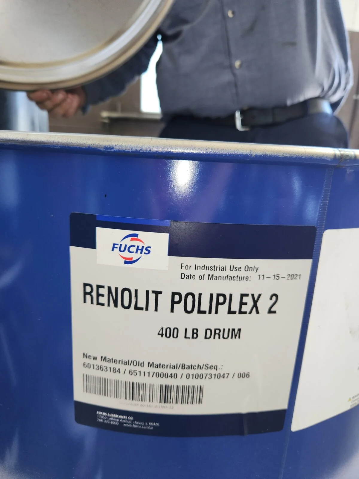

I have read most of this thread, just wondering if anyone has tried this grease, all I know about it is it's expensive and we use it on all the grease fittings on our class 8 trucks.
Scoop out a handful, put it in a ziploc, and I'll give it a shot.
