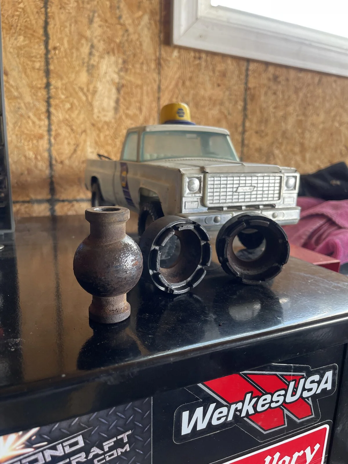

You likely know a guy within arm's reach who could whip you out a set of 8 lower balls in 400C in not much time. That is certainly an experiment I would try if I lived where my parts rusted like that. I'd also try a bead blasted finish on half of them versus smooth to see if that holds grease better.
If I start making centering balls, I'm going the whole way and designing something that is greasable without disassembly.
The zinc chromate plating should help. I'll run that and see how much time it buys me, or if the joint is going to attract enough dirt to wear it out quickly.

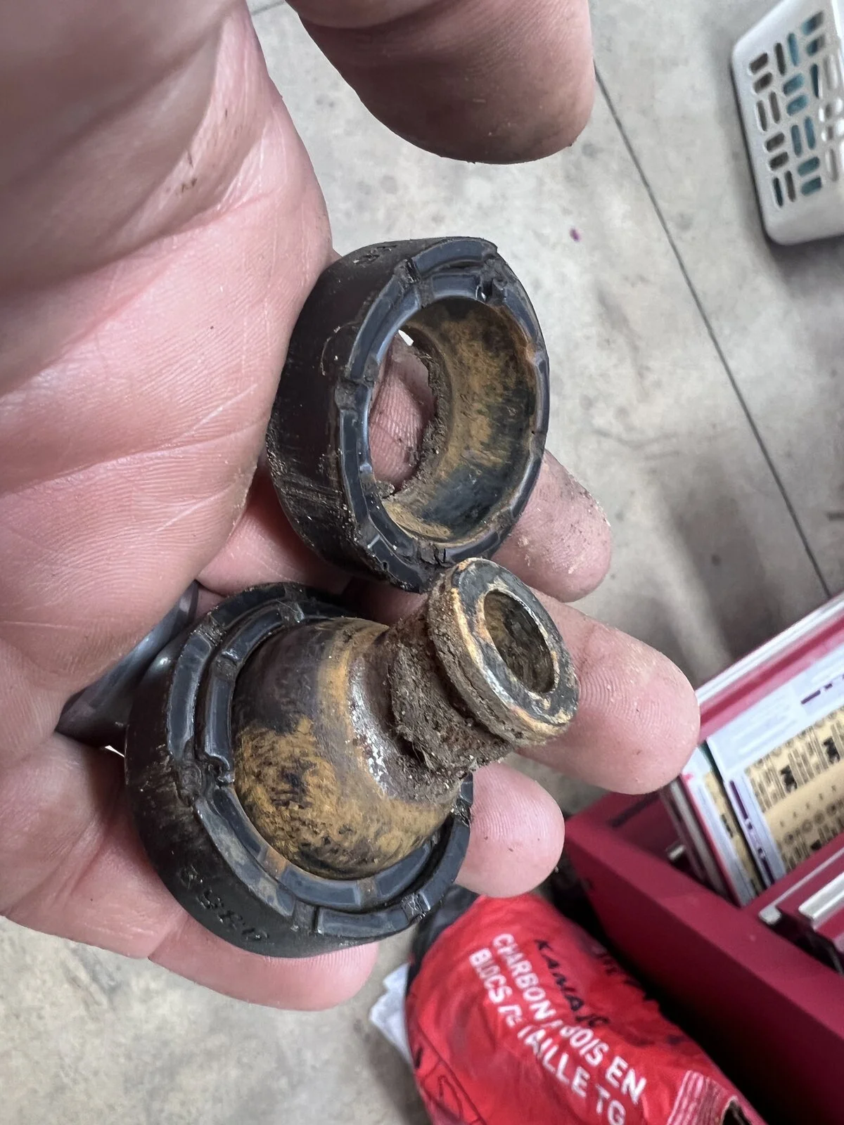

I bought a brand new RJ track bar and could not get the JJs to take grease before installing it.
I called RJ and asked about greasing JJs, specifically their track bar. Those JJs are designed with a one-piece race/bushing. As far as I know, you can't separate the ball from the race/bushing on these. The RJ rep said to remove the zerk fitting and make sure the hole in the race is lined up with the zerk fitting. If it isn't, just drill through the rubber race so when you apply grease, it makes it in to the ball.
My actual experience was that it basically would not take grease, even on the work bench, with the holes aligned. Too tight with a brand new TB. So I clamped a JJ ball in my bench vise with the TB still fully assembled. Then I rotated the TB in all directions, which seem to eventually get some grease on the ball and start to free up the joint. It took several iterations of adding a tiny amount of grease and moving the TB around to get the joint freed up and feeling like it's properly lubed. Before bench greasing, the joint was super tight and resistant to movement.
This is just my experience as another data point. YMMV

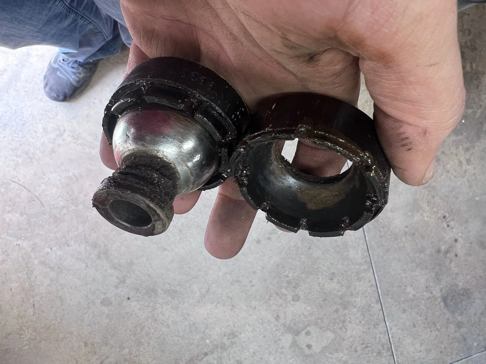

Here's a brand new JJ I took apart to check the grease in. As I've seen in most I've opened up before, there's very little grease from RockJock. Ignore the little bit of red on the ends of the ball, that's just old grease in my assembly tool.

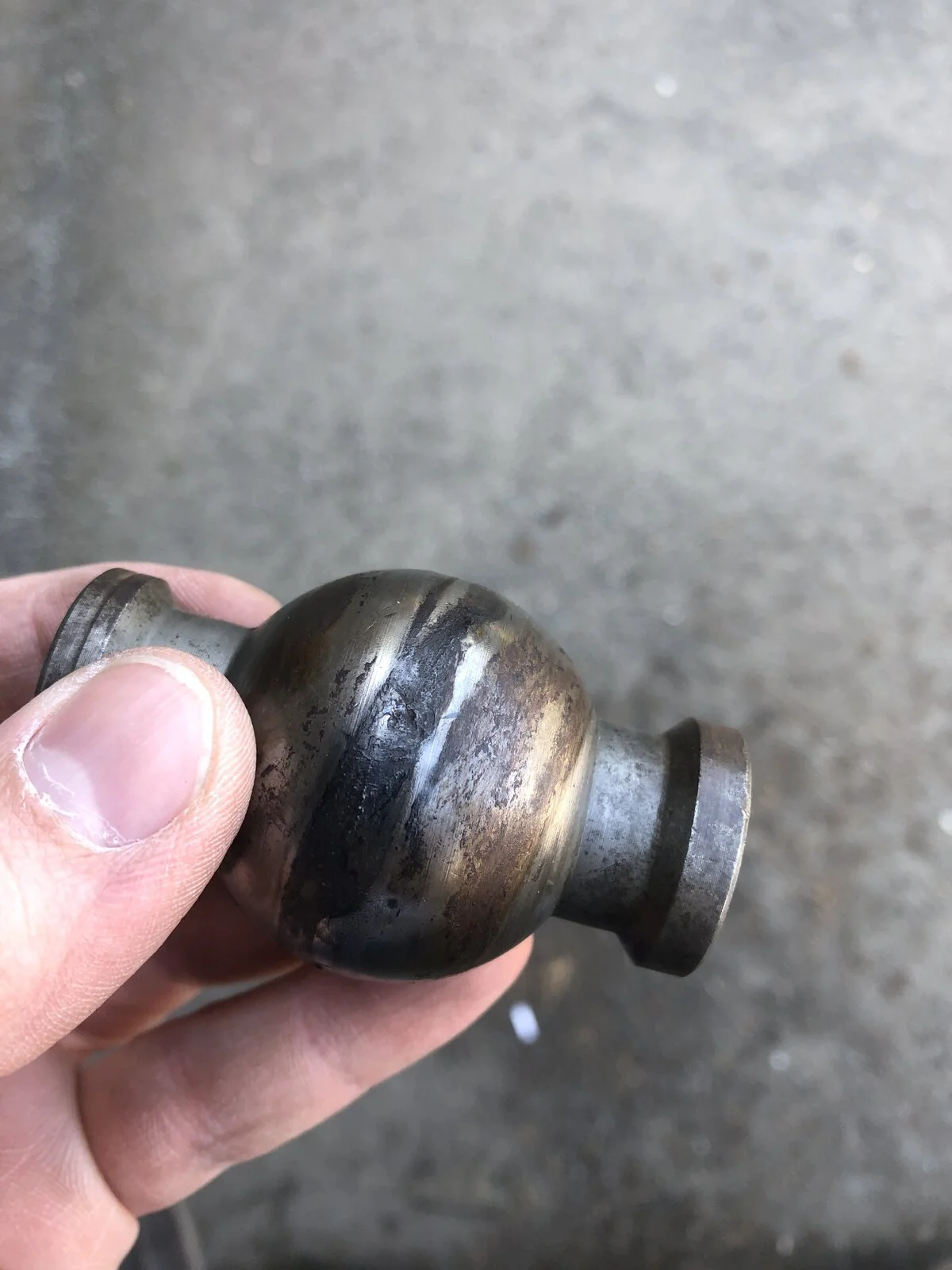

Here’s what they look like after 10yrs of neglect and not greasing them. You can see the grease has dried out and stuck to the ball. What I thought would be pitted and rusty, actually cleaned up very well. I greased the bushings and the ball before reassembly and let the extra grease shoot out and wiped the excess away. I did not try shooting grease in them but I made sure the holes were lined up in case I ever needed to do so. Everything was assembled using STP Moly-Ep grease.

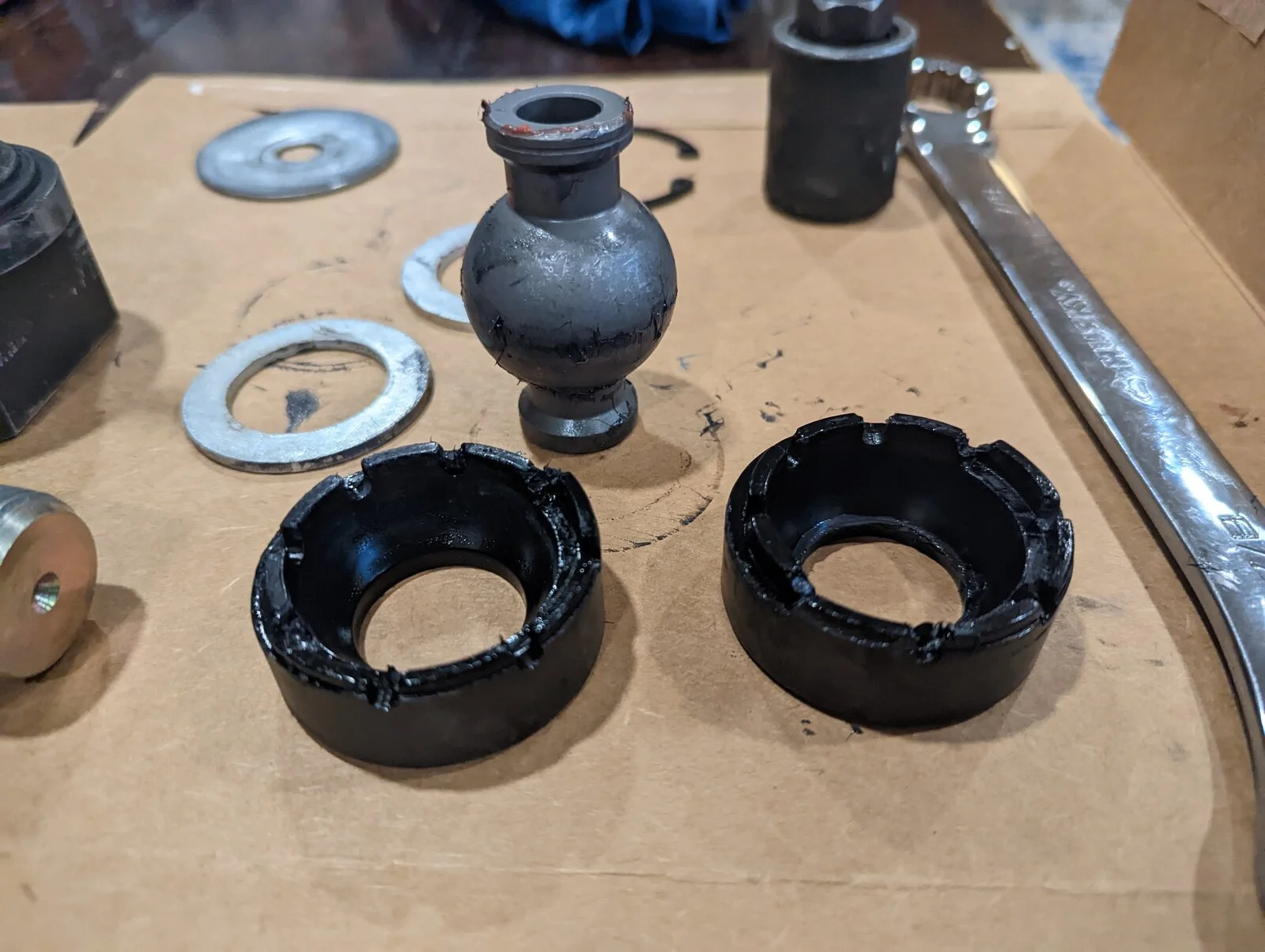

I recently purchased all 16 joints for some home brewed control I made. Before installing I took every joint apart, cleaned the little bit of factory grease out then used the cv2 to reassembled. I think 3 of the smaller joints had enough grease I would have been comfortable with. All the others were nearly dry. Glad I had read that from all the folks here!
