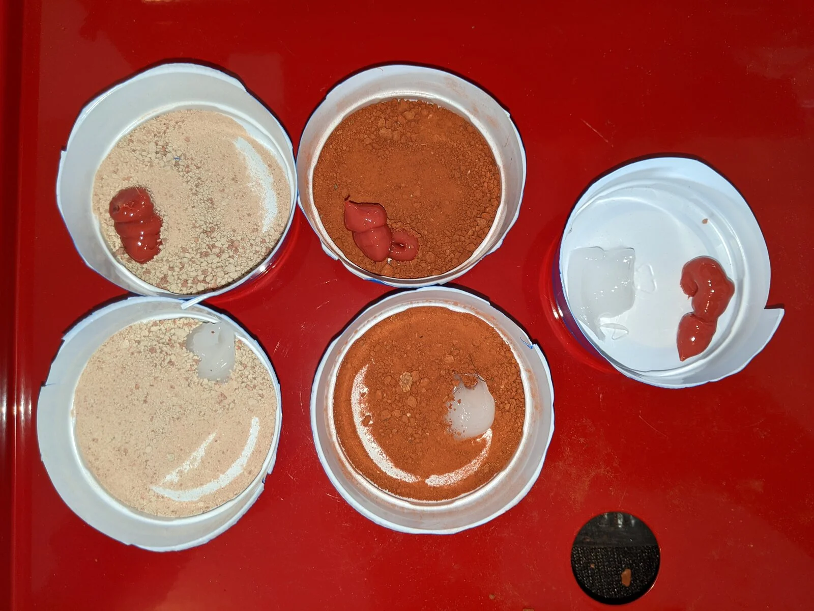

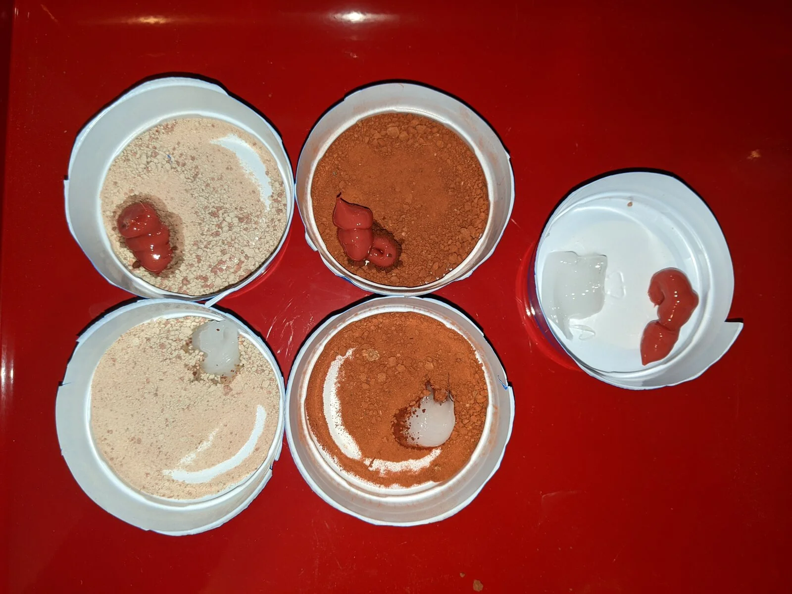

ok, so here goes.
I collected 2 samples of clay-rich soil from my property in Oklahoma.
We have two flavors of clay...the red stuff, and the white stuff, so I got one of each. I can't tell you if these specific samples were "native" to my property or whether they rode in with some fill dirt because there are 4 houses in different phases of construction on my street and mine is in the middle of them.
I cut the bottoms off of some solo cups to create some petri dishes, placed a generous dab of Redline CV2 grease w/ moly into two of them and a dab of Energy Suspension "Formula 5 Prelube" into the other. I then filled the dish with amounts of dry red and white clay as to completely surround the grease to a consistent depth with a little dust scattered up on the side.
The fifth dish without any dirt is the control, because science.
I'll take photos every 24 hours until either results appear obvious or it becomes apparent that they're going to happen on a slower scale than justifies daily checks.

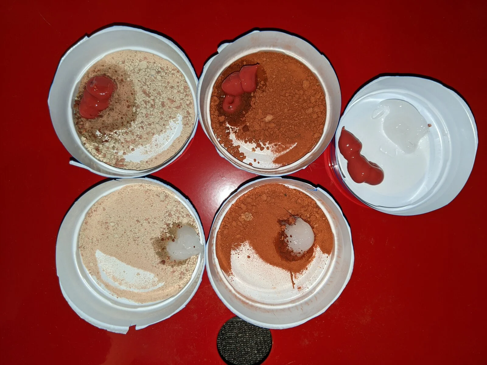

I didn't take a 24 hour photo because I couldn't see a difference, but here's the 48 hour photo and I can see things happening with a flashed photo that aren't obvious to the naked eye.
Namely, the darkening of the clay in the immediate vicinity of the grease. It's happening with both greases, but it does seem to be more pronounced, or progressing farther into the clay, with the CV2.
Obviously our concern is not necessarily what happens to the dirt, but the grease that's left behind, so it'll be interesting to see if I can observe anything there as time goes on. It occurred to me that I maybe should have used smaller amounts of grease since any of these dabs is multiples more volume than would be present in a JJ...but it's difficult to only use that amount and have enough to observe.
Those dark areas are the oils being leeched out of the grease, I'd bet. Be interesting to see this progress.

Here's the latest photo. The oily spot continues to grow, and is still more advanced with the CV2 than with the F5P.
I think my grease:clay ratio is too high to tell me anything meaningful about the grease that's left behind, so I may let this go for a couple more weeks and then start with a new set with smaller dabs of grease and more dirt. I'll probably just go for the white stuff since it seems to have more of the absorbent properties we're concerned about, and the dirt work at our house is at a stage where I have all of it that I could ever need.
Nice work! I think it's reasonable to infer that more oil absorbed by the clay means less oil left behind.
While it would be ideal to directly measure the grease left behind, do you have a good way to do that? Could you tell if one lost 10% of it's oil and the other lost 30%? Or would you have to wait until the oil was all gone and it no longer felt like grease?
I think you're probably right, I just wish it was more definitive.
Waiting until all the oil is gone is probably the only definitive result I have at my disposal right now. Thinking of another way, like comparing viscosity, would be better I think. Just gotta figure out a good way to do it since neither of them will flow through an orifice under the force of gravity even when brand new.

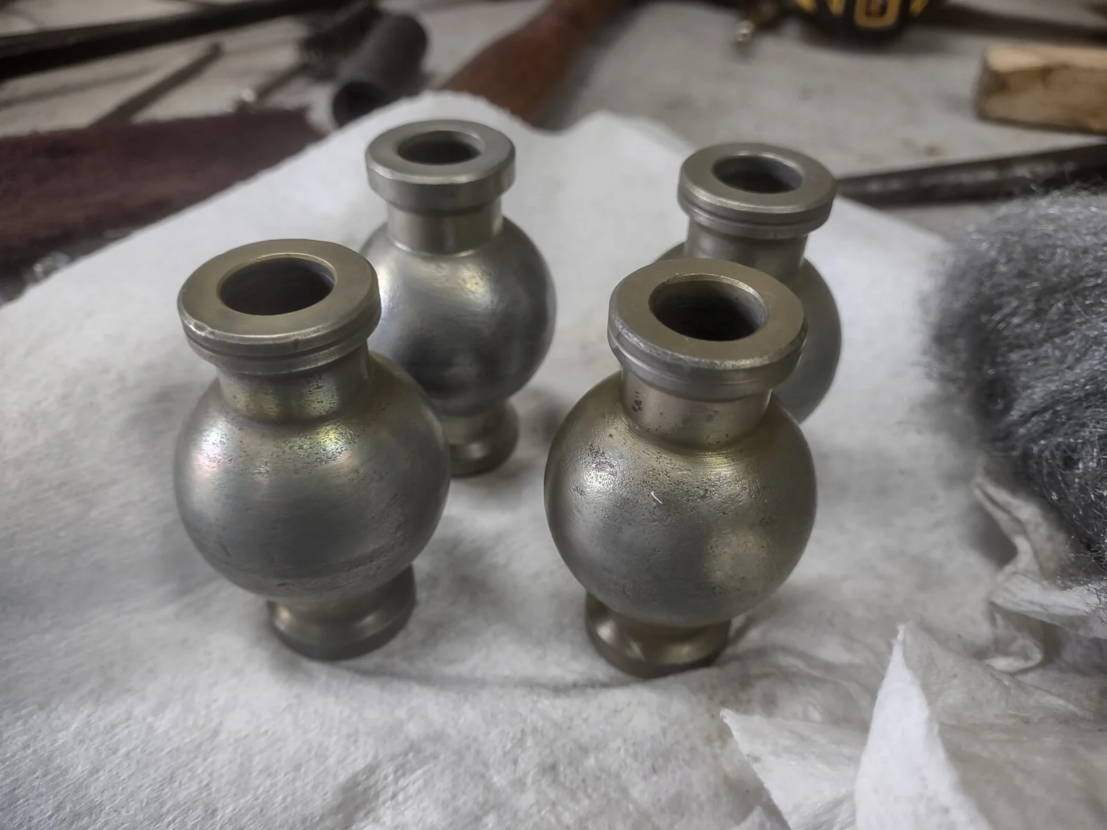

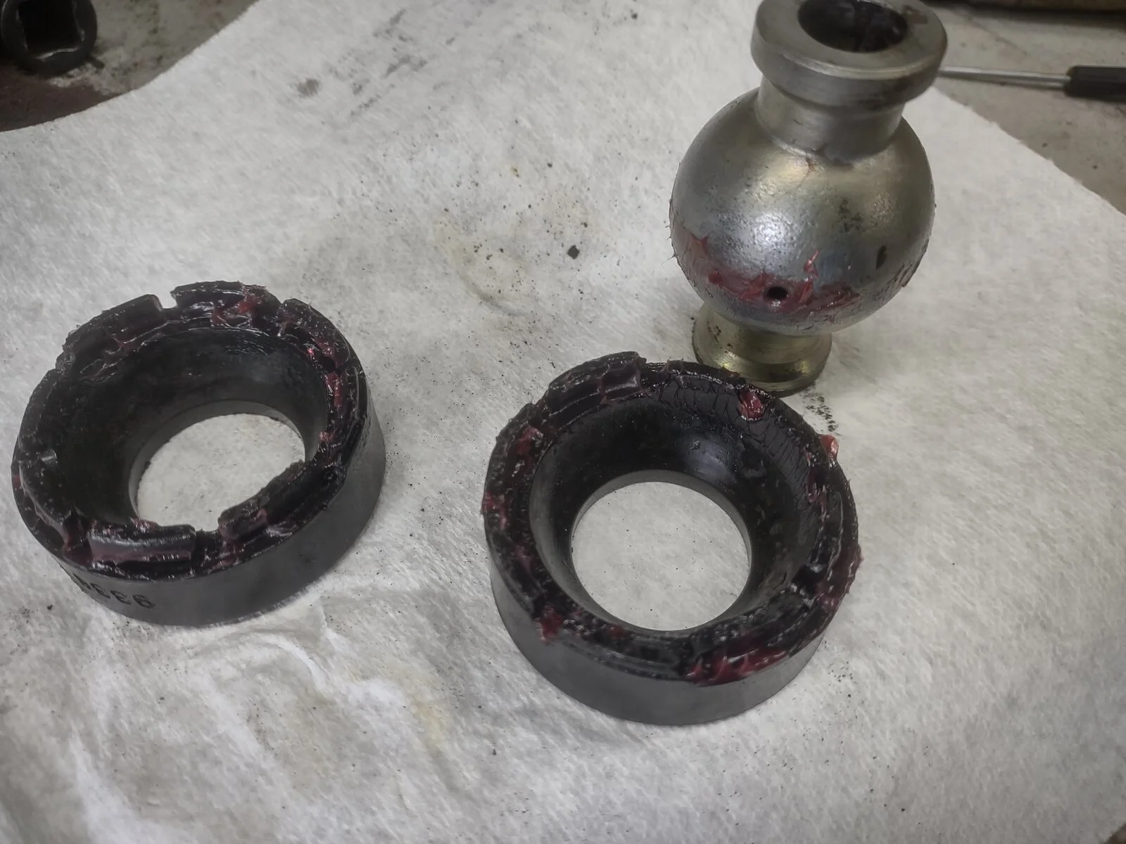

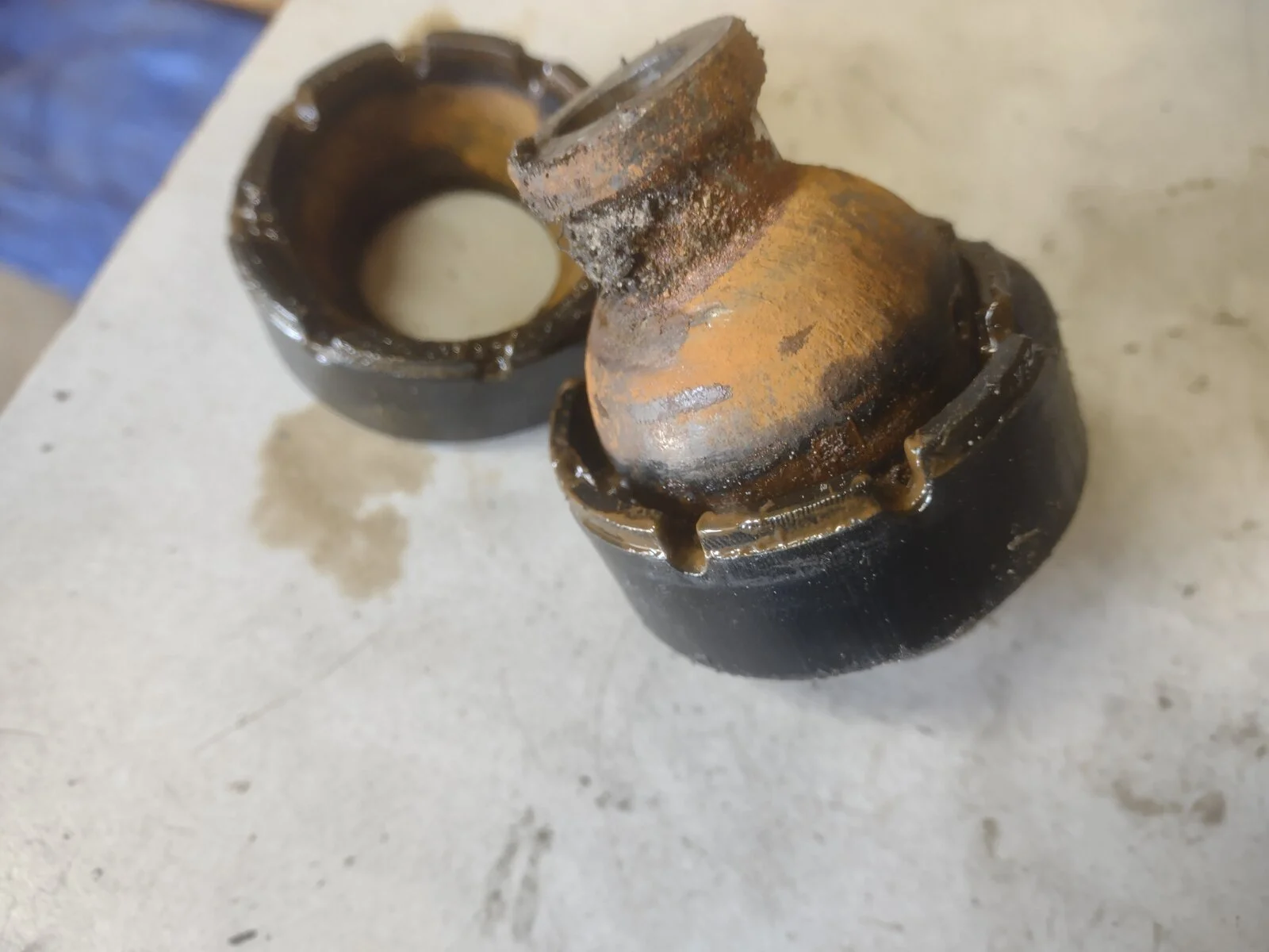

I rebuilt a couple of my lower control arms today. These were greased with energy suspension formula 5 about a year ago. I went wheeling a couple times with them and drove them a couple times this winter (salt).
Pretty disappointed to see the amount of corrosion present in the joint.
The joints were still moving though and not squeaking. They were dry though... The grease that was present was still the same consistency of the stuff when fresh, so there is that.

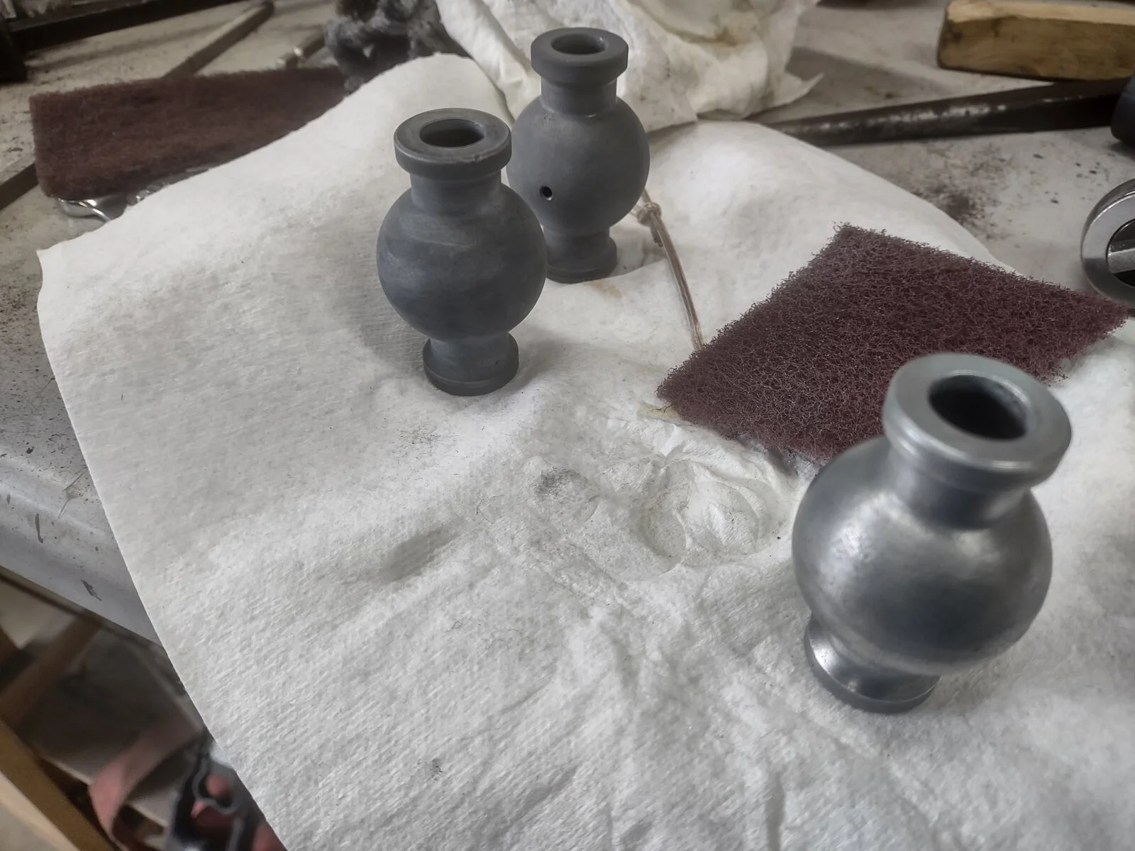

Based on the corrosion, I decided to hit the center balls with a zinc chromate solution. It's pretty easy to do at home, lots of DIY articles and videos around.
Here is a "raw" zinc plating, and one that I've polished with 000 steel wool.
I do two zinc plating baths, then dip the parts in a yellow chromate bath. It's not as good as a commercial bath, but it is better than raw steel. The yellow is tough to photograph... These look pretty close to grade 8 bolts, but lighter.
And, one final experiment...I assembled a joint and tried to grease it through the housing grease zerk. I got 4 pumps of grease in before the grease started squeezing out of areas.
Then I disassembled the joint again to see where the grease went.
It basically filled the outer "ring" area and put a witness on the ball, but no grease made it between the ball and the race... The joint was dry. I also got grease through the hole in the ball and on the bolt. So... That won't work.
Pretty disappointed to see the amount of corrosion present in the joint.View attachment 325014
I would have never expected this. That looks like it has been neglected for years! :(

I was pretty surprised to see it as well.
You likely know a guy within arm's reach who could whip you out a set of 8 lower balls in 400C in not much time. That is certainly an experiment I would try if I lived where my parts rusted like that. I'd also try a bead blasted finish on half of them versus smooth to see if that holds grease better.
