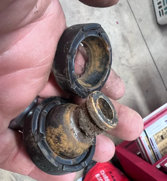

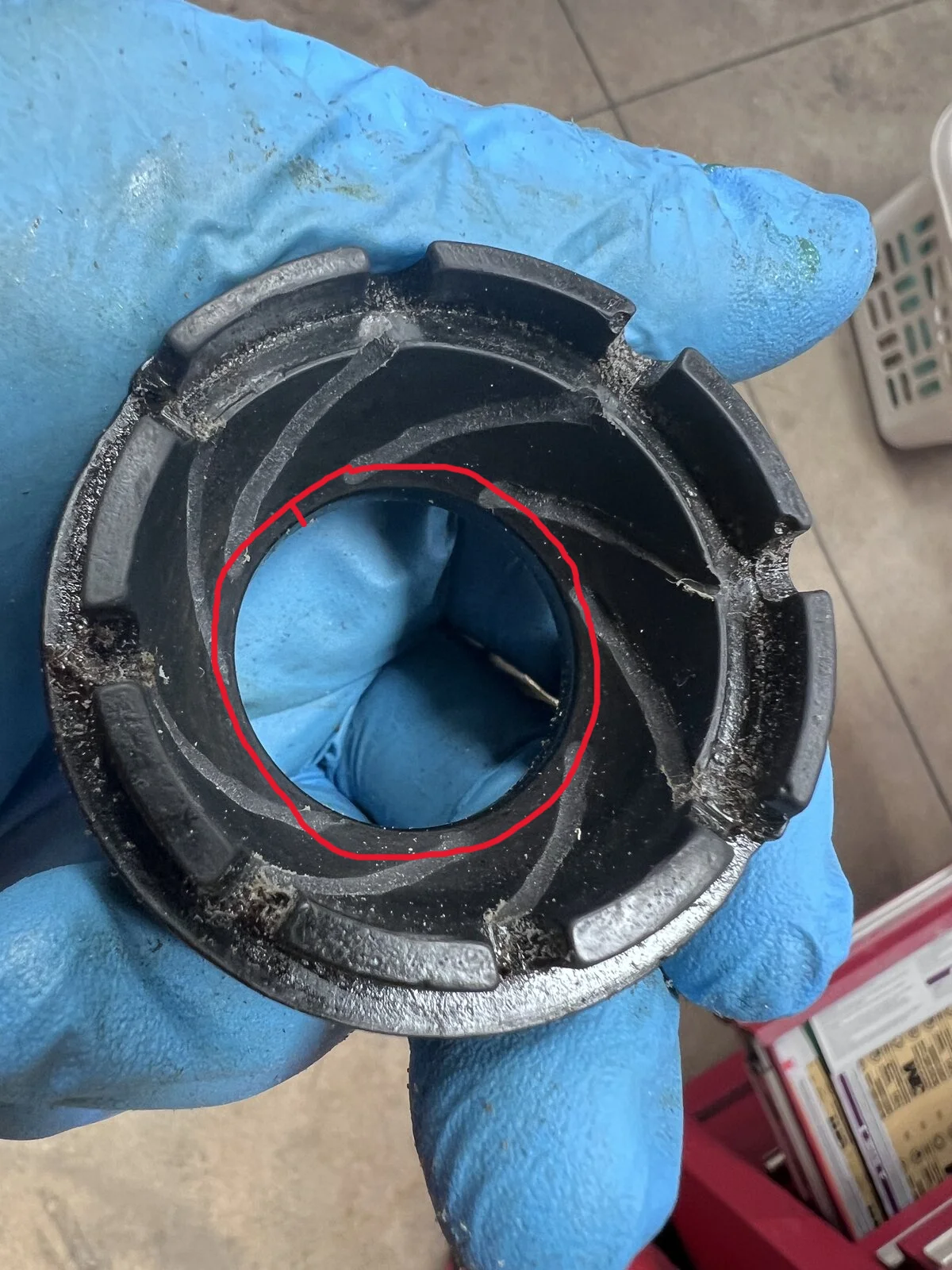

They grooves are part of the solution I think. I’m still kicking around some idea in my head to make the grease go where I want it, and not where I don’t. For kicks and giggles, I tried squirting some grease into the housing zerk today on the bench. The castlations must have been lined up correctly, and the joint took grease easily. However, it flowed through the bushings, into the joint and right straight through the ball to the bolt hole. That ain’t going to work.
I keep thinking grooves that would basically allow you to flush the joint with new grease would be the ticket. But yeah, can't have it escaping into the bolt hole.

[Give @mrblaine the credit here] leading theory is that the clay silt type mud that I frequently find myself in is drying the oils in the grease out. The thought process behind this is paying attention to what makes oil soak or kitty litter work…they are also Clay based and very good at absorbing oil. After the clay absorbs the oil and gets washed away, its leaving the non-oil additives in the joint and at that point its no longer lubricating or protecting from corrosion. The typical joint I rebuild looks like this.

You are correct that clay type will typically dry the grease out, which is why we use high moly content grease. A side from more frequent greasing since you wheel in that type of condition to make sure it stays lubed, after you install the bushings take a drill bit and remove the zerk fitting and drill a hole through the bushing that should allow grease an easier travel path to the ball center.
Its interesting to me that they suggest drilling a hole. I'm not sure where the grease is going to go, once you have a hole in the race...its still compressed. With the additions of my grease grooves though, I can see a path for the grease to follow to the exterior of the joint, hopefully without extruding race material. I'm going to pick up a grease gun and try their lube with a drilled hole, as well as some Aluminum based anti-seize on one arm.

Well this is a bit disheartening. I just disassembled brand new Currie lower arms and greased them up with the redline CV2. Still waiting for my 2” JJ tool and front uppers to arrive. I’ve yet to service my rear double adjustables in the 3 years I’ve had them on. I’m in the Northeast and although I try to avoid mud as much as possible it’s inevitable. It’s also very much claylike.

Anything that has is mixed with a liquid to become "fluid" (i.e. grease-like) can be absorbed by kitty litter or oil soak and is going to dry up in the conditions I've experienced. The ONLY lube I've seen not do this is the energy suspension stuff. I'm sure there are other types that are similar.
I think the answer for me will be figuring out how to make the grease flow through the joint and hitting them with the gun after a trip. Honestly, If I can get to that point, I'd be a happy camper. I typically spend an hour or so looking things over anyway. Snapping a grease fitting on isn't that big a deal.

The application of the grooves wasn’t bad. Less than 5 minutes a joint. I used a ball end burr in my pencil grinder. Cleaning and greasing took far more time
sounds like they don't have an answer and he's just shooting from the hip. The center channel around the "equator" of the poly bushing already allows for a place to grease to get to the ball, a hole is just gonna provide one more little space for grease to dead end at. Maybe if you drilled and threaded a hole on the housing exactly straight across from the zerk, you could fill that center groove with new grease until it comes out the other hole and then install a set screw to plug it. Probably still isn't gonna coat the entire ball but it might be a way to at least flush out the solids with some fresh grease and maybe the fresh stuff makes its way around as you drive and the bushings articulate around the ball.
There really isn’t a channel for the grease. The two halves interlock. The only “path” for the grease is the small 0.030” flat on the ball that won’t compress the bushing as much as everything else around it.
Drilling a hole doesn’t do anything for you if you line the holes in the castellations up with the zerk.

Is there a reason for the interlocks? I don't see how the interlocks are supporting the ball. There is no where for the halves to go. I don't think the interlocks do anything other than make it harder to lube with a grease gun. My next move will be removing the interlocking blocks and use silicon grease in a grease gun.

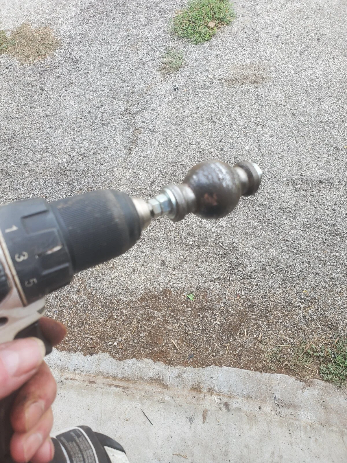

As for cleaning the ball, a bolt, some washers, a nut, emerry cloth and a drill motor!
