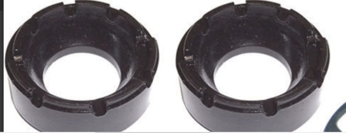

The poly bushings in the JJ are castellated with half inner and half outer so that the two ends interface and effectively overlap. Makes it a real pain in the ass to put them together since you have to line up the castellated sections since they are both the same part.

so your saying the castled bearings are interlocked and leave no room for pass through? does the castle-ation not line up and provide an access port from multiple directions once interlocked.
my big snap ring pliers are at work, dammit. now i have to see this construction for myself.
Technically, the ports are supposed to allow grease to reach the ball. I've not found that to be the case.
