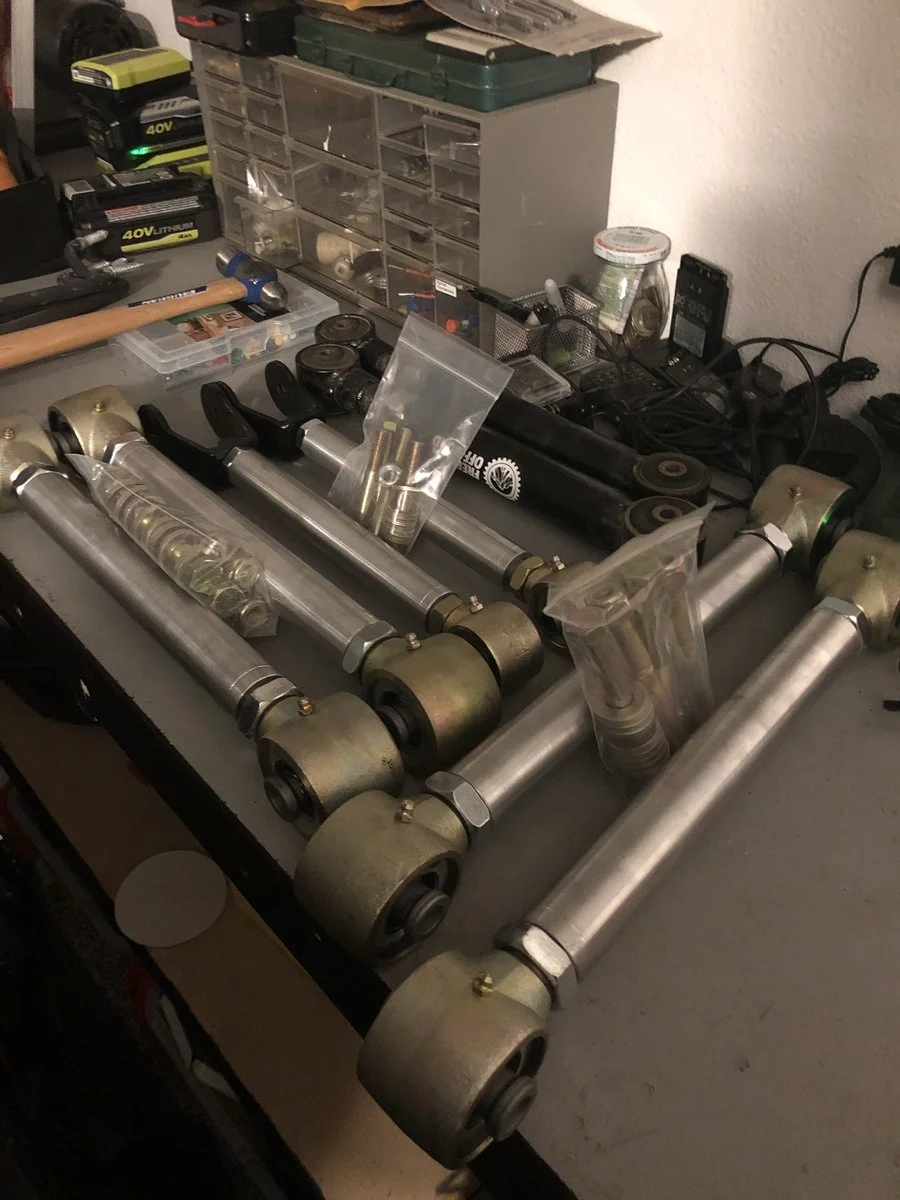

Sorry, fell asleep last night. I will collect my thoughts later on today and provide you with as much of my experience as I can remember lol. Install and performance experience?I’m curious of your experience so far since I just got these today to install over the holiday. I figure if there’s any lessons to learn ahead of time it’s worth engaging a little.
ignore the non matching set, those are on loan from another jeeper nearby.

Sorry so delayed...Install was a breeze, and adjustment is even easier. I'm so glad I got the double adjustables. Even when considering the greasing issues I've encountered, i'm glad I spent the money on them. When wheeling they are amazing regarding articulation; love the way my jeep handles off road. And after buying the tool (highly recommend), disassembling them, and greasing them, I've learned that they are easily maintained. Having reassembled them with CV-2 grease, I am curious to see how long they last till the next maintenance is due. On a side note, after working on 16 JJs, I can disassemble, clean, grease, and reassemble a JJ in no time now.I’m curious of your experience so far since I just got these today to install over the holiday. I figure if there’s any lessons to learn ahead of time it’s worth engaging a little.
Did you compare the breakaway torque needed to move the ball after you used the CV-2? That and the rest is spot on. Folks act like it a major ordeal to take them apart and grease them and if you are just the tiniest bit mechanically inclined, it isn't any harder than changing oil.Sorry so delayed...Install was a breeze, and adjustment is even easier. I'm so glad I got the double adjustables. Even when considering the greasing issues I've encountered, i'm glad I spent the money on them. When wheeling they are amazing regarding articulation; love the way my jeep handles off road. And after buying the tool (highly recommend), disassembling them, and greasing them, I've learned that they are easily maintained. Having reassembled them with CV-2 grease, I am curious to see how long they last till the next maintenance is due. On a side note, after working on 16 JJs, I can disassemble, clean, grease, and reassemble a JJ in no time now.
Well, my method to test the breakaway torque was less than precise and relies on my hand dyno...but yes, stuck a large screwdriver in the joint and rotated. With that said, couldn't tell a whole lot of difference. Only difference was the Currie grease provides little to no resistance, almost loose feeling and the CV-2 feels like more controlled smooth movement. Have a better method for testing? What am I looking for and what is desired from the joint?Did you compare the breakaway torque needed to move the ball after you used the CV-2? That and the rest is spot on. Folks act like it a major ordeal to take them apart and grease them and if you are just the tiniest bit mechanically inclined, it isn't any harder than changing oil.
When we get a JJ, it takes a long screwdriver to move it.Well, my method to test the breakaway torque was less than precise and relies on my hand dyno...but yes, stuck a large screwdriver in the joint and rotated. With that said, couldn't tell a whole lot of difference. Only difference was the Currie grease provides little to no resistance, almost loose feeling and the CV-2 feels like more controlled smooth movement. Have a better method for testing? What am I looking for and what is desired from the joint?
I just checked the breakaway torque on my CAs installed on my rig under its own weight to see if I can move them. I can grab them by the barrel and twist them. Is that normal? Should I be able to do that by hand?When we get a JJ, it takes a long screwdriver to move it.
Entirely possible with that grease.I just checked the breakaway torque on my CAs installed on my rig under its own weight to see if I can move them. I can grab them by the barrel and twist them. Is that normal? Should I be able to do that by hand?
